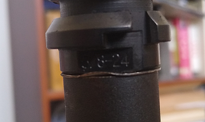

Using my Dead Air Sandman--had a rough start--now its doing just great. One problem:
That bastard stays on the mount NO MATTER WHAT. Removing it last night un-torqued my muzzle break--even after I let it cool. I tried to do my reading before posting stupid dumb repeats, but it appears red-loctite or rockset will be nessecary on the muzzle device. Is there any way to avoid this? Its not that I am opposed to using loctite, just I thought I properly torqued device I would be able to attach and detach with no issue.
Also it appears my shims get wrecked to hell (bent up almost onto the flats) by the wrench in the flats area (its only it the flats)--normal or no?
I think they are recent as I just got the new brake from capital armory. my previous brake/supressor was a PITA--Supressor got RMA'd and for $75 I just went with a new brake. 20 ft lbs
Ahh--sorry showing my ignorance--its a BP listed. --it did get a new core in the RMA this year--not sure if that would change things. I generally have to use a big wrench to knock it loose after firing (knock is probably bad term--get enough leverage). After things heat up from firing its on there DONE SOLID.

Hi DocRDS. I'm incredibly sorry that you're dealing with this. The mount is definitely not designed to become so tight you can't take it off. In fact, it's designed to be able to be removed even after hardcore use, so this is definitely atypical.
Here are some things that sometimes catch out new users--but often work themselves out:
--Detent ring has very sharp detent teeth. These typically smooth out after a bunch of actuations.
--When brand new, there may be minimal lube on the parts. The fresh nitride of the mount can have a lot of stiction on the taper when tightened down. I'll put a light amount of lube on the face of the detent ring as well as the threads under it.
If some lube and repeated use don't smooth it out, then there's probably something going on that wasn't machined perfectly. Our new suppliers are doing a killer job of getting these made to a very high quality standard--and at very high volumes as well. In this case, it would be ideal to get it in hand to diagnose. Please contact our Customer Service line and they'll get you a shipping label and we'll look at it asap. Mike Pappas, an owner of the company, will most likely get hands-on with it. If I'm in the office, I'll be able to see it too. We'll need the suppressor along with the mount to diagnose it.
Again, sorry for the troubles. We'll get this fixed asap for you.

On those shims, we've been selling a really common shim in the market that is large enough to match the diameter of the back of the mount, but the wrench flats are sub-flush. I recommend using the flats over the forward-firing vents on the brake. That way they don't get folded over. We'll be moving on soon to a new shim set that is custom cut for our products.
You also don't need to go nuts with anti-seize for this mount. My go-to lube is Hornady One-Shot. It'll cook off after some hard use, but a simple spray on the inside taper and then the outside Key-Mount parts and it's as good as new.
