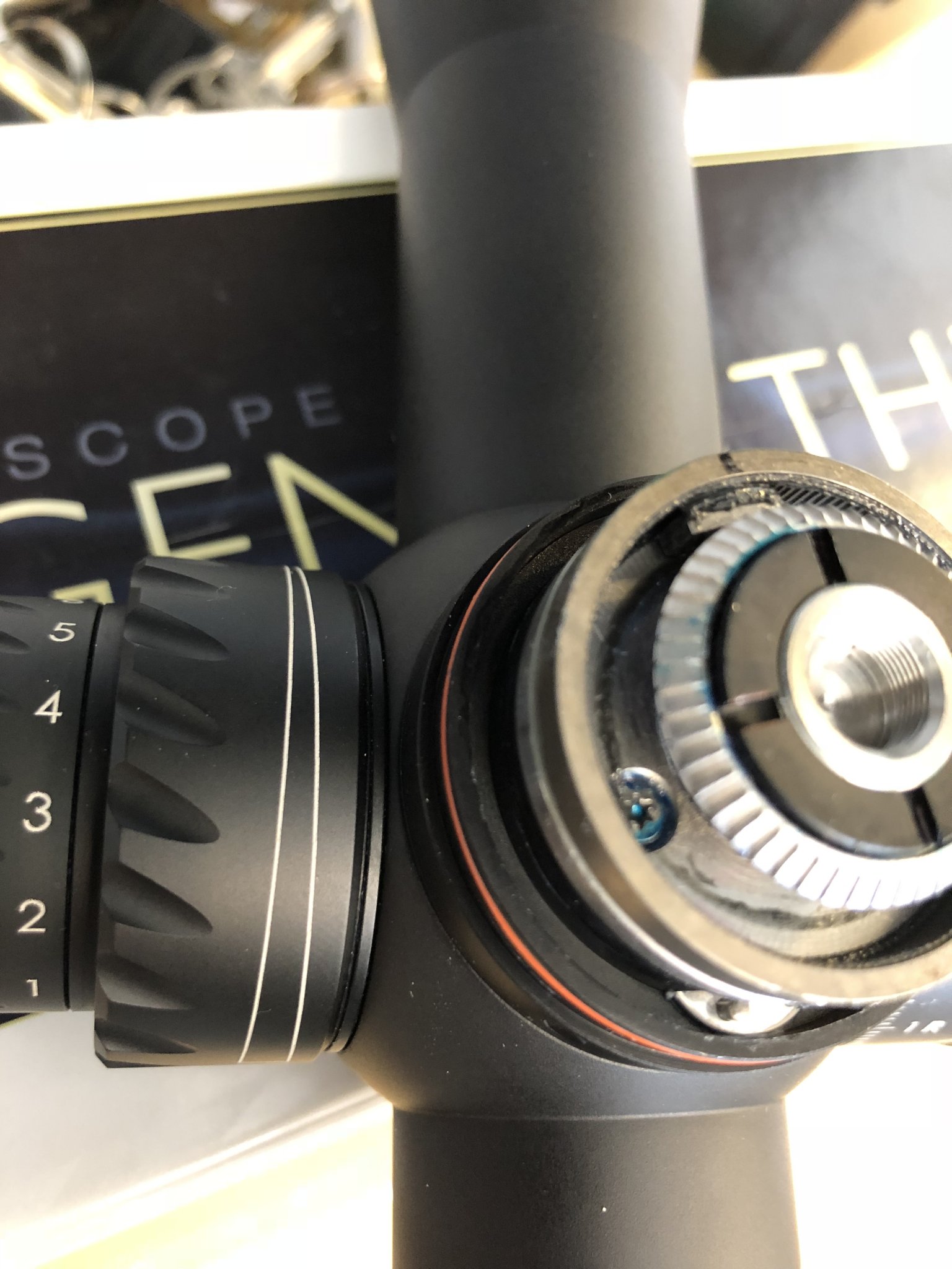

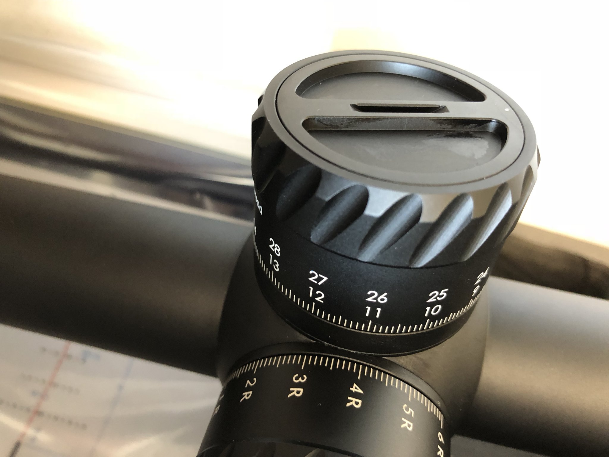

4) Turret - Let's get down to why I'm doing this mini-review (or not so mini). I'll start by saying my elevation turret was slightly mis-aligned and it's obvious when you look at my video. The marking is slightly off from the arrow indicator... and yes I've tried realigning it using the instructions; but, if you don't own a tangent theta you won't know that doing this (like on other scopes ) is not that straightforward... and yes TT and armament (their distributor) already is aware. What separates the TT turrets from the other high end players, is the feel and appearance. It's large... like the size of the vortex gen2 and or minox. It feels good in the hand; but, the knurling is machined to feel comfortable, with just enough grip. The actual movement of the elevation turret I find to be just "ok". I find the windage turret to be "something special" in the words of a fellow optics reviewer. It's incredibly crisp, incredibly crisp...imagine the best feeling turret you've ever felt (I thought nightforce was it for my hands).... TT blows what you felt out of the water. Now I exaggerate a bit, the reality is we are splitting hairs, and it's all personal preference. The elevation turret of the TT feels similar to my schmidt's and kahles when it comes to actual movement, precise, basically no play, that dull "thunk" that says it moved confidently to the next setting.
The windage turret feels like this and more. The line spacings on the elevation turret are perfect, they aren't cramped like they are on the schmidt PM2 DT, or the minox zp5. Even with the 15 mils on the elevation turret, the diameter is perfect. Would it be nice if they were 10 mils per rev like the gen 2 and with adequate spacing like the gen 2 razor...yeah I think it would have been nice; but, not necessary.

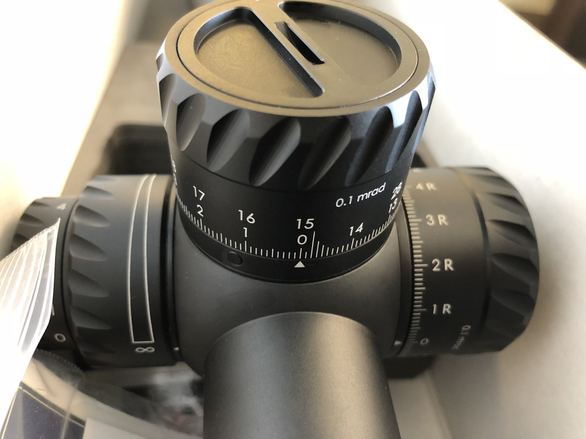

Don’t you just love how the elevation turret clicks in between hash marks?
I noticed that too 918, in the video the arrow on the elevation is aligned between 0 and 1 and not on 0, does TT have a way to reset the outer turret housing to align properly with the numbers?

Yeah I reached out to both TT and armament about the elevation turret marking not lining up. It's for sure a warranty issue in my mind. On the inside of the scope cap, it's obvious they don't want people messing with the turret mechanisms b/c there's adhesive on top of the screw almost similar to what timney does to prove whether or not someone tried messing with the mechanism to void a warranty. I hope it's an easy fix that I don't have to mail in but I'm almost positive it's not an easy one (or at least not one described in the manual).

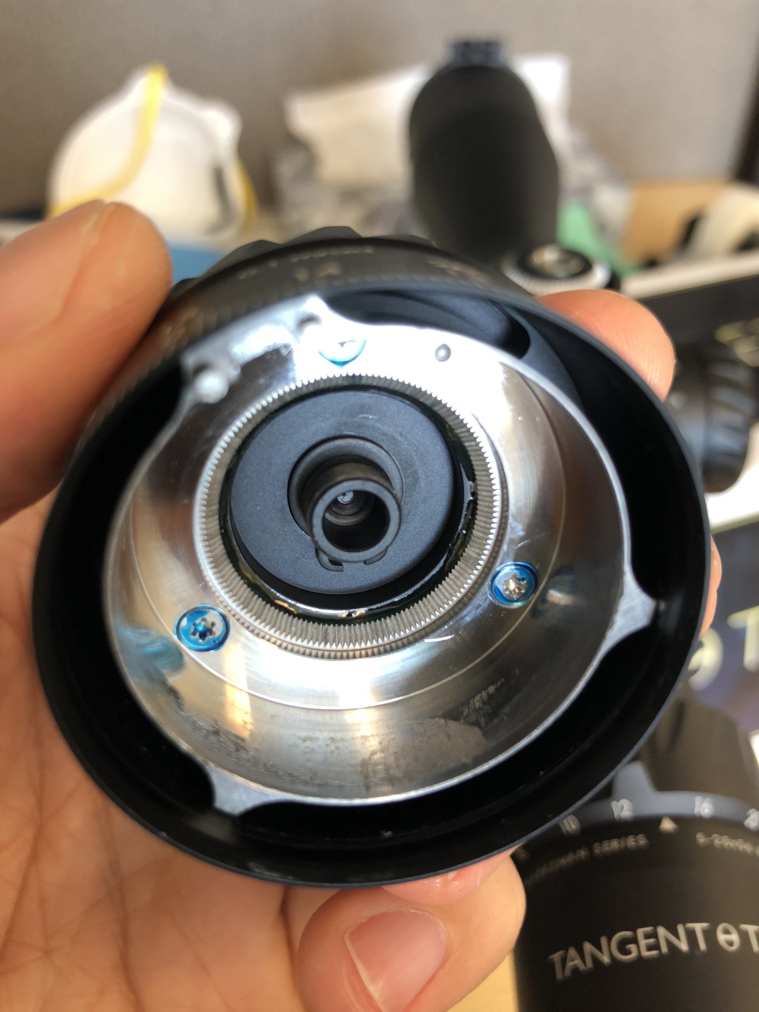

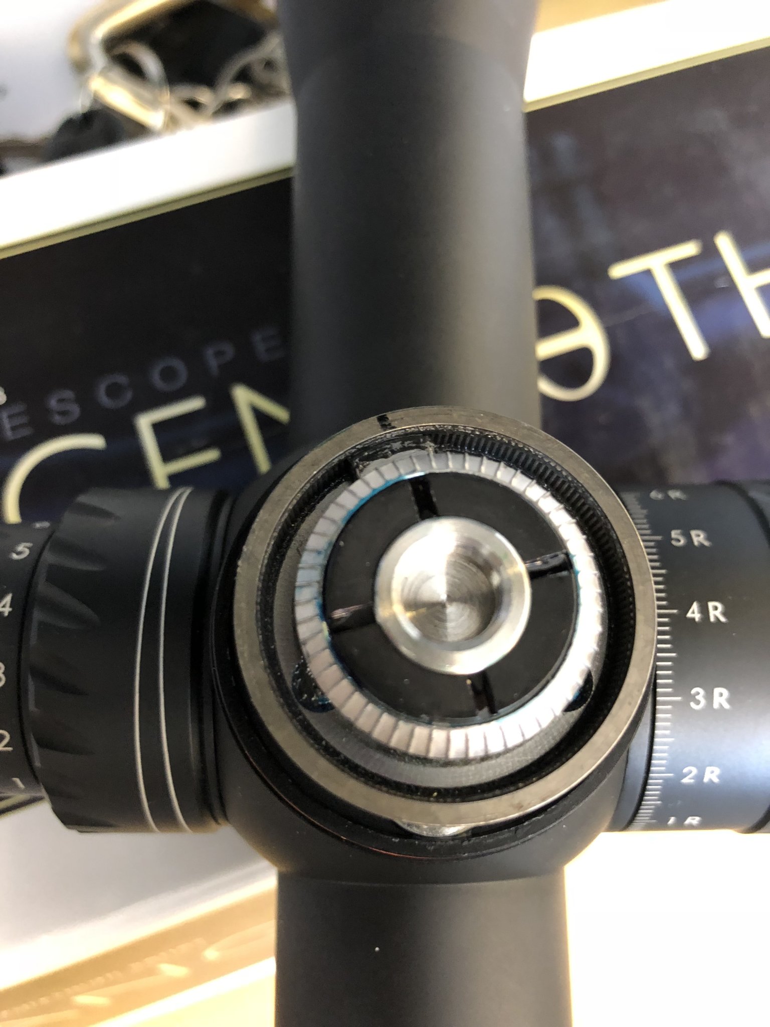

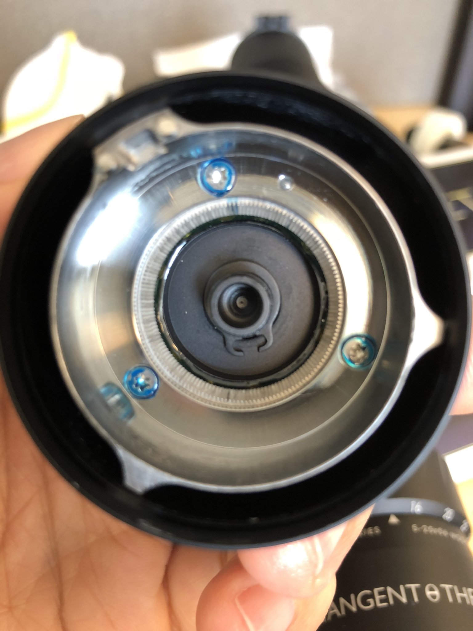

So the previous owner misaligned the hash marks?
Negative there is no way for an end user to misalign, you will need to look at the internals of the turret cap to understand. It’s factory set. And the mechanism of how the elevation turret zeros is based on the internals. Once I get my second tangent this wed I’ll take a pic and show you what I mean.

So the 1st owner didn't do it, and the company didn't send it out that way????............whatever you say man, I'm with ya all the way.
Misalign implies purposely trying to misalign the turret markings. He didn’t alter the sealed screws on the inside of the turret cap in anyway to induce this misalignment. It’s very much a manufacturing defect in my mind. Unfortunately tangent I hear never says what actually the defect is.

If you have the time can you post detailed pics of the inside of the elevation turret mechanism? If no time no problem I can do it in a few days.
Pics of the inside of the turret cap and erector. As you can see the screws have blue marking that’s likely threadlocker and a way for the company to determine if the end user tampered with the elevation turret. This will help explain to others why it’s not possiblw to purposely misalign the elevation turret markings from the arrow indicator. All the screws have that tamper sealant... . Notice how the cap and elevation erector are connected by teeth. That is not adjustable at all by the end user. I’m quite certain It’s factory set and I’m not messing with it. This is a second tangent btw with nothing wrong with it.
