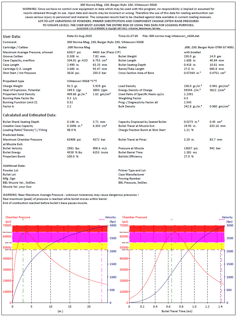

Just my perspective on a starting point.
I ordered an Accuracy International AXSR in 300 Norma Magnum and 5 boxes of Berger 230 grain Hybrid OTM Tactical cartridges for the Lapua Brass and later load development. I like Vihtavuori N500 series powders for the 300 Norma Magnum.
Using the Vihtavuori load calculator, it suggested N560, N565 and N570 powders. However, running Quickload my first assessment suggested N568 was the ideal powder based on a case capacity fill of 98% at 63,412 p.s.i. (near max), and a burn rate of 100% out of a 27 inch barrel at 2,981 f.p.s. While reviewing the “Table of powders and Cartridge Data” showing comparable powders, many powders have a 100% burnt propellant factor. However, looking at another table ”Estimates of the progress of combustion” we can see when the propellant achieves 100% as it travels down the barrel.
Powders reaching 100% early suggest a powder burn rate that is too fast, powders never reaching 100% suggest a powder burn rate to slow.
Safe reloading practices dictate a charge starting point well below max utilizing what is commonly known as a “ladder” or “Satterlee ladder test.” There are several variations of this but you’re looking for that range of charges that produce the least variance in velocity known as a “node.” There may be several nodes too. This first ladder test can have some wide increments, say .3 grains or whatever you wish. More on this later.
In searching for favorable “nodes” your bullet seating depth is not critical at this point, so start at .0003 off the lands and shoot your groups to find a node or nodes. Now the range of seating depth will depend on several factors, what is your chamber dimensions (SAAMI or custom), single or magazine feed will determine your possible range of COAL.
Once you determined your seating depth, it’s likely different from your initial starting point and therefore your case capacity is slightly different, and you should redo the “ladder test” again in smaller increments +- .5 grains on either side of your new starting charge weight in .1 grain increments to fine tune your adjusted charge weight.
When seating bullets within the range in your “node”, start at the longest length within your node range since barrel erosion only goes one way.
While I have not evaluated this, Erik Cortina says much of the bullet seating testing can be replaced with a tuner. I’m not sure, just passing along what I understood him to say.

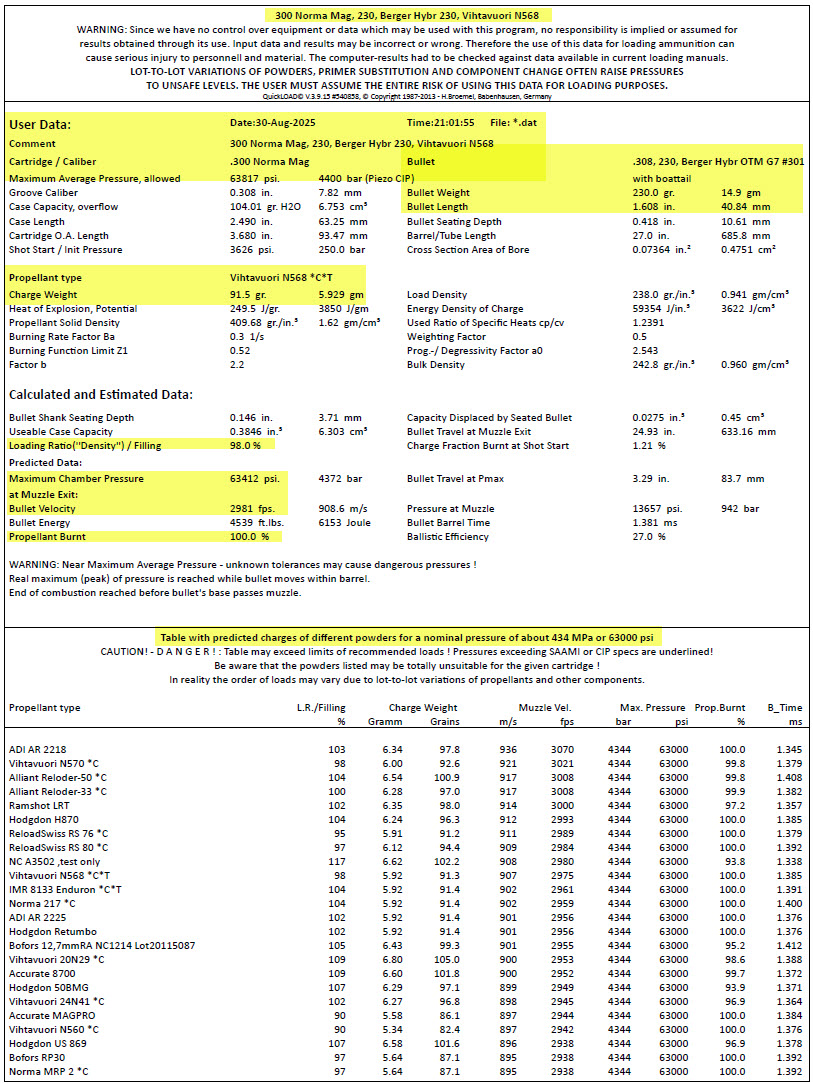

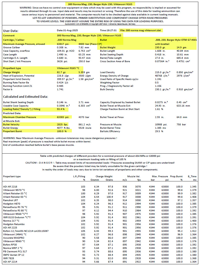

I'm going to test of the n100 Vihtavuori powders as well vs the N500 powders. The N100 series single-base powders known for their versatility, stability, and typically lower peak pressure for comparable velocities, while the N500 series are "semi double-base" powders incorporating nitroglycerin for higher energy and increased velocity, often with a hotter flame and greater temperature sensitivity, making them suited for maximum ballistic performance and long-range shooting. The N100 series are generally preferred for benchrest and temperature-sensitive applications, whereas the N500 series are chosen when maximum speed is the priority, despite the higher potential for barrel erosion.
In my initial Quickload test of N568 vs N165, N568 at similar pressures was 156 fps faster shooting a Berger 30 Caliber 230 Grain Hybrid OTM Tactical Rifle Bullet showing the difference between single and semi-double-base powders.
As I continue to learn Quickload after years of use, I continue to dig deeper into its functions appreciating some of its finer nuances.

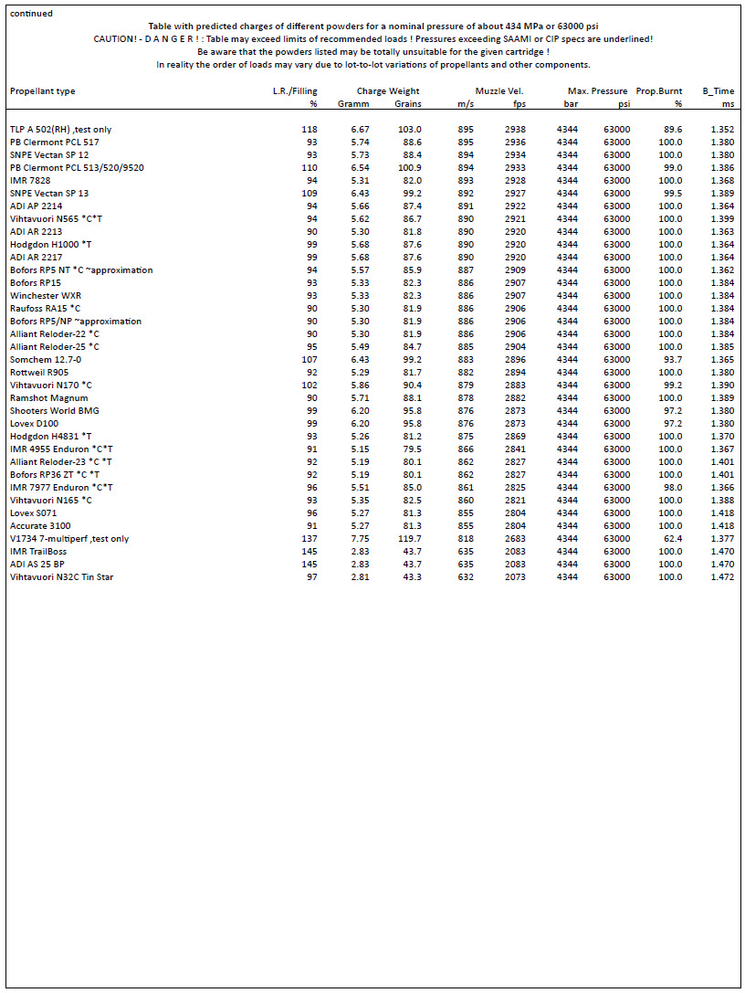

Programs like Quickload, a commercial interior ballistics software program simulates and predicts the performance of handloaded ammunition, helping reloaders understand how changes in bullet seating, powder, and other variables affect pressure, muzzle velocity, and other factors before testing at the range. It aids with load development, especially for non-standard or custom cartridges, by providing a starting point and helping to optimize load combinations.
When evaluating modern gunpowders, also known as smokeless powders, they vary significantly in their composition, burn rate, and other characteristics to achieve a vast variety of performance outcomes. Quickload allows me to run simulations of all known gunpowders based on specific criteria and weapons, looking at but not limited to max pressure, burn rate, muzzle velocity, case capacity and fill.
With this information I can narrow down the list of powders to test searching for velocity and bullet seating depth nodes. Nodes will show the variance of incremental change for powder charge weight and bullet seating depth. The goal is to find where these nodes exist and select the widest node range having the least variance per incremental change allowing for the greatest ballistic consistency, something critical for long distance shooting.

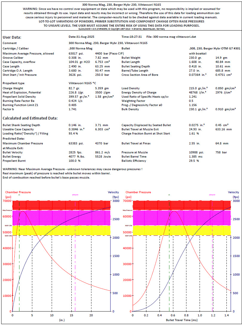

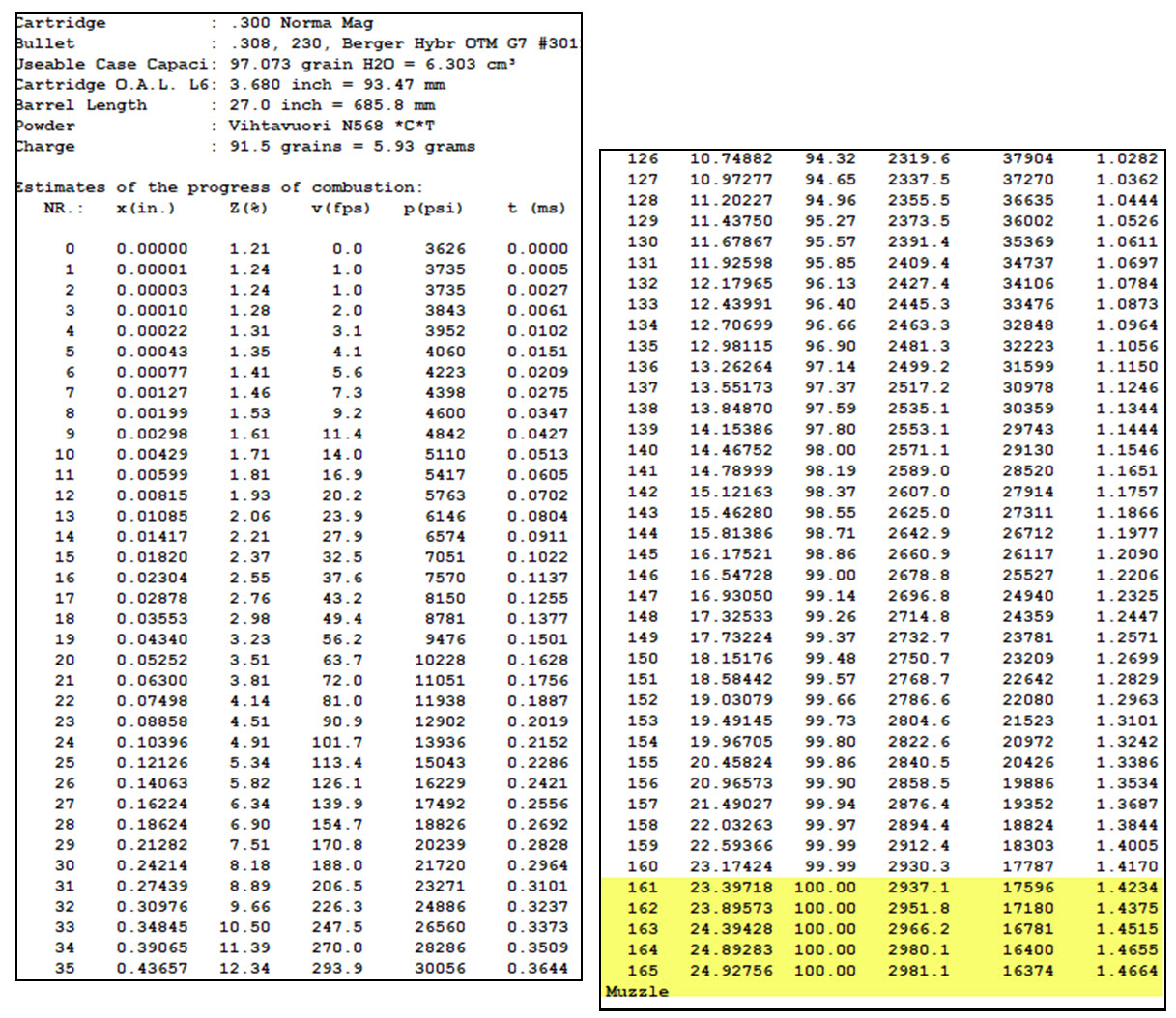

By way of example testing two powders from Vihtavuori, N568 and N165 for a 300 Norma Magnum, N100 series are single-base powders known for their versatility, stability, and typically lower peak pressure for comparable velocities, while the N500 series are "semi double-base" powders incorporating nitroglycerin for higher energy and increased velocity, often with a hotter flame and greater temperature sensitivity, making them suited for maximum ballistic performance and long-range shooting.
We see the single-base N165 loaded to a similar pressure as the semi double-based N568 powder produces approximately 156 feet per second less velocity with both having burnt 100% before reaching the muzzle. Case fill is 98% vs 93% respectively, so within an acceptable case fill range.
In reviewing the Quickload data we see N1165 reaches 100% burnt rate sooner than N568 suggesting its burn rate is a bit to fast, but acceptable.
What is important, especially shooting magnum loads or those known as “barrel burners” is to see what the tradeoff is. Higher velocity for the same bullet will deliver a flatter trajectory and better wind bucking performance, however in certain circumstances shorter barrel life. Depending on the cartridge and load criteria, acceptable barrel life can be as short as 800 rounds. Acceptable being the operative term.

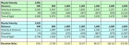

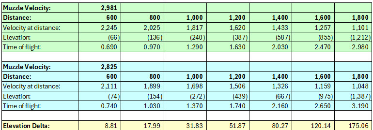

Using the online Berger Ballistic Calculator for Berger Norma Magnum 230gr Hybrid OTM Tactical Rifle Ammunition at two velocities, N568 (2,981 fps) and N165 (2,825 fps) we get the following table (see picture) showing velocity, elevation drop, and time of flight at distances from 600 to 1,800 yards for both powders. Based on your specific needs you can select which powder best suits your needs, the faster and hotter N568 or the slower N165.

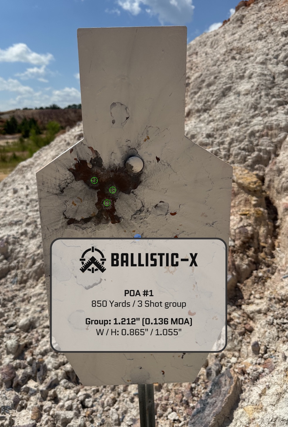

Maurygold, I did not mean to suggest your group was luck, rather a general comment on small groups which I know you're well aware of having read Bryan Litz's book and listening to others.
"I’ve also never seen someone luck their way into tiny groups at distance."
That group, especially if it is representative of the precision of your rifle and loads is exceptional.
