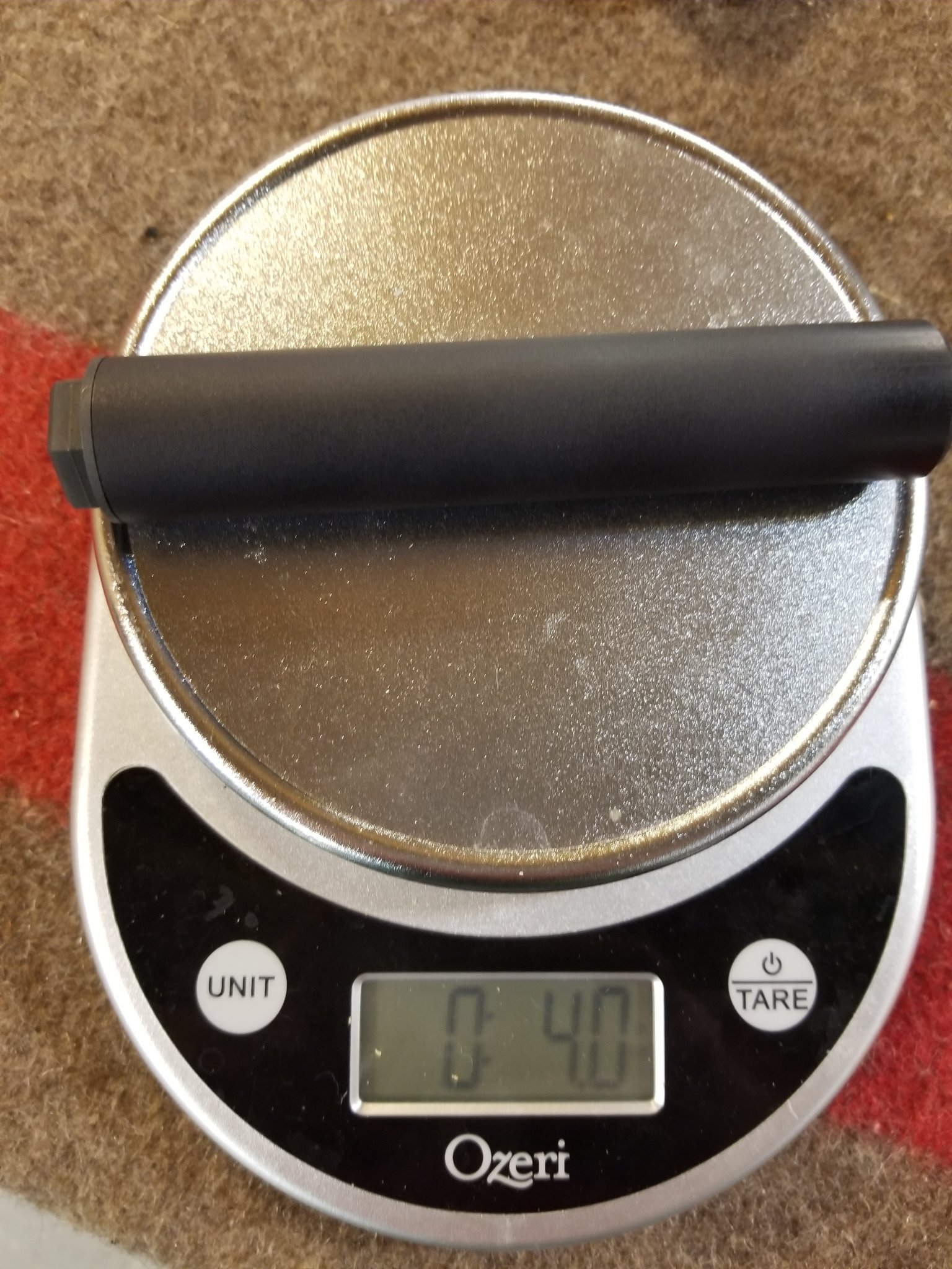

Granted, I am still waiting on my approved Form 1 to come back, but what I like(d) about Quietbore is...
- One order gets you the outer tube, the cones, the end caps, etc. I want easy, this was easy.
- The drilling jig. They claim that with the guide, the runout will be less than .002". I don't have a lathe, I don't even have a drill press. This is perfect for guys like me.
- It's got titanium internals. This is a picture of it before any material has been removed. 4.0 ounces.

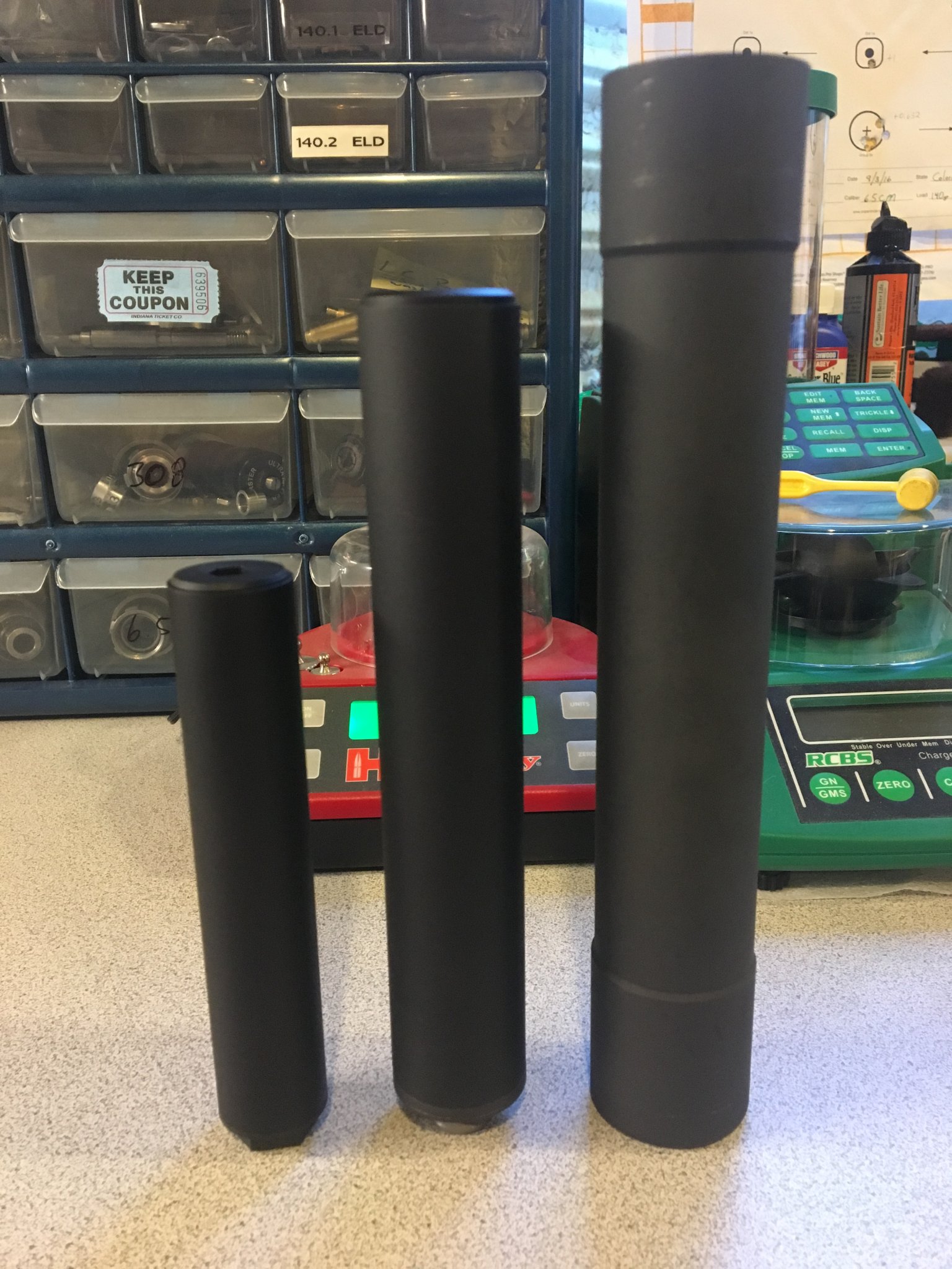

Have all my form 1 paperwork submitted and have Received all three from QB. I haven’t weighed the 223/300 yet but yeah it’s heavy. The 22 and 9mm are great fit and finish and nice and light. View attachment 7150678
I am not capable of looking at the can on the right and thinking of anything besides the typical movie/TV pipe bomb. I will anxiously await a full review to see if it works well enough to justify the "budget" build of $350 + a $200 tax stamp. I'm intrigued by it, but cautious.

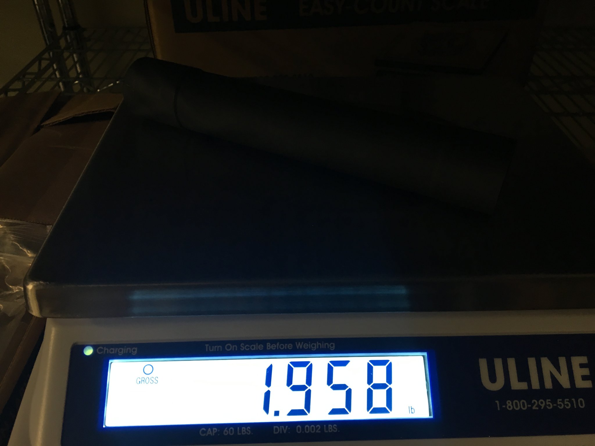

Basically 2lbs as is before drilling holes.
I’m going to chuck it up and turn some material off the ID of the baffles and maybe some off the end caps.

I did remove 0.030” off the wall of the baffles from the ID. The wall thickness started out at 0.096”. I left a section of the wall alone since each baffle seems to indicate from the inner diameter on the next baffle it rests on.
Removing this amount of material from each baffle resulted in a total reduction of 0.142lbs. This might not seem like much but it was exactly the same weight as one entire baffle before removing material. So it was like removing one baffle and ended up being an 8% reduction. I’m guessing drilling holes in the baffles and end cap will net another 0.200-0.300 lbs. so I’m getting closer to 1.5lbs. It’s hard to see the step of material I left at the original wall thickness but here’s a photo anyway.
