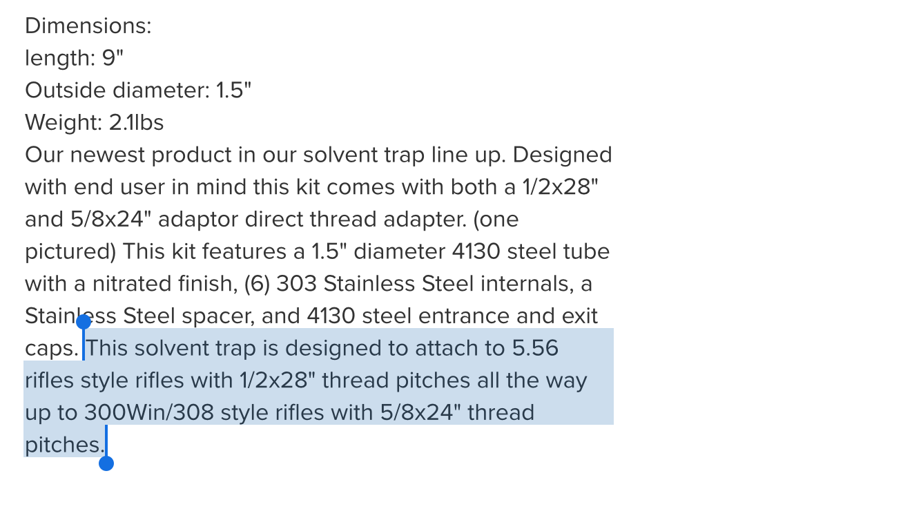

Anyone able to confirm what the 556/30 solvent trap is rated to? The way I interpret the description is that it is has threads capable of attaching to other rifles such as 300win. No confirmation or suggestion that it is actually rated for a 300win.

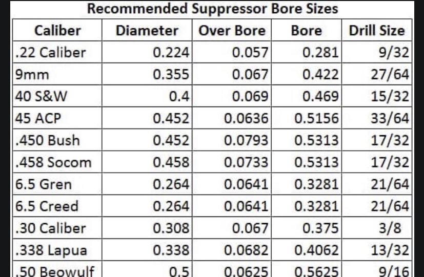

Thanks @padom. Anyone have opinions between getting a 9mm vs 45cal trap? Right now, I only have 9mm pistols and a PCC. I was thinking about a 9mm can, but then thought, why not get a 45cal for the possibility of getting a larger cal weapon in the future. Any down sides?
Also, is the 45 cal trap rated for 300blk?
I run a Rugged Obsidian 45 on all my pistols, 9 and 45 PCC. Super quiet.
I have the QuietBore 45 kit on the way which I will be reviewing on 9mm and 45 pistols and 9mm and 45 PCC.
