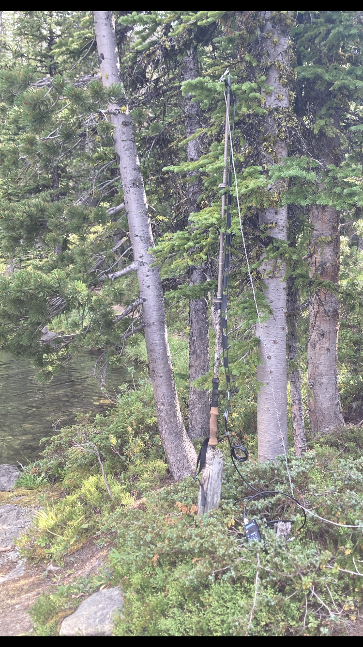

MURS (VHF) is gonna do a much better job in the terrain you described than GMRS (UHF). A VHF signal will "bend" over the terrain much more so than UHF, which will do a better job in a urban setting, in and around buildings. (I have and use both...)

1. Handhelds don't work well in cars -but an external antenna helps.
2. There isn't a handheld made I would trust at 5 miles. Unless you have a massive base station, like a police dispatch office.
3. Get a ham license so you can get better stuff.
4, Look up MURS.

I know it’s an old thread, but oh well.
Antenna. Antenna. Antenna.
For handhelds that’s the biggest handicap. For a handheld to work really well, an external antenna (mag mount or slim-Jim hung in a tree, etc) is a game changer. Lots of good replacements also that improve on the rubber ducky antenna. @plong mentioned it already that vhf works better in the hills.
FRS. UHF
No license needed. 2 watts max. no antenna mods allowed.
MURS. VHF
No license needed. 2 watts max. Antenna mods allowed. No repeaters allowed.
GMRS. UHF
now is only $35 for a license, 50 watts max, antenna mods allowed, repeaters are allowed and are already set up in some popular locations.
Amateur tech, aka HAM. VHF and UHF
License cost is $35, 50 watts is allowed (1500 watts in some bands but not applicable here), antenna mods encouraged, repeaters allowed, very wide range of available frequencies so you aren’t stuck with preset channels.
With a handheld, more than 5 watts is almost useless due to antenna limitations. Aftermarket or homemade antennas can really make a handheld work well.
here i used a 5 watt handheld to reach a repeater that’s 70 miles away, line of sight.
And here is a slim-Jim on a trekking pole in camp down by the lake. Antenna made up just enough difference for the lack of elevation.
TLDR? Antennas matter.
FRS. UHF
MURS. VHF
GMRS. UHF
FRS. UHF
MURS. VHF
GMRS. UHF
