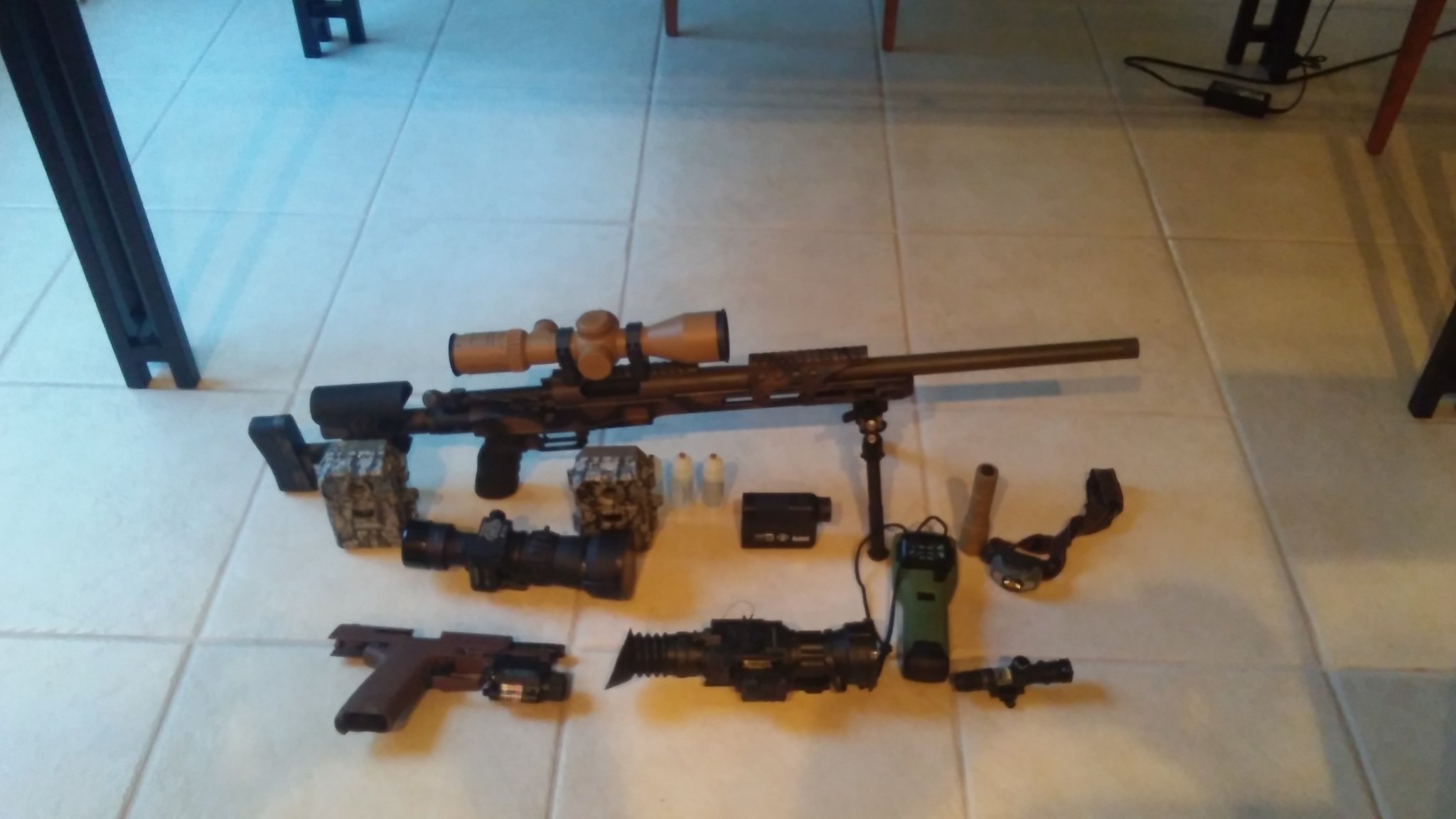

Well, in for a penny, in for a pound ... I guess I willl try to zero this critter tonight and build me a working handheld thermal range finder !
The gear will include:
Olde ruger YUTE model .308WIN(18) (my "test" gun) ...
Skeet weapons mount which takes dove tail from the device
Patrol
Lion's gear rail on the patrol
Radius on the Lion's gear rail
Manfrotto M190 tripod
PIG saddle
RRS tripod
G-10 chassis
REM700 SPS tac aac-sd barreled action
Mk5 5-25x T3 scope
Night Optics Day/Night adapter
PVS-14 #1
not shown
TH bump helmet
norotos lo sto (button)
PVS-14 #2
Zeroing Process
01 - Setup Ruger Yute model on tripod outside aimed at the mineral feeder ~ 415 yrds away on the ridge
02 - Setup REM700 7.62(20) on tripod just to the right of the ruger yute
03 - Aim reticle of patrol on yute at center of mineral feeder at 415yds.
04 - With PVS-14 on rear of Mk5 scope, aim center of 7.62(20) reticle at the mineral feeder.
05 - Turn on the radius aiming laser.
06 - Adjust the radius aiming laser so it is pointed at the mineral feeder, use helmet mounted 14 to get into the ball park.
07 - Keep checking the Patrol to make sure the center of the thermal reticle is aimed at the center of the mineral feeder.
08 - Fine tune the Radius on the Patrol by checking on the 7.62(20) with the 14 behind.
09 - Once the Radius on the Patrol is zeroed, test several known distance targets. Aim the patrol thermal reticle at the target and check the range. Repeat steps 07, 08 and 09 if needed
I'm gonna switch the tripods around and use the RRS with the VYCE on the yute model and the manfrotto on the G-10 rifle with the 14. The yute model needs the most stability because we want the patrol to remain locked on to the center of the mineral feeder while turning the adjustment knobs on the radius, which are appropriately stiff. So switching the tripod assignments !!

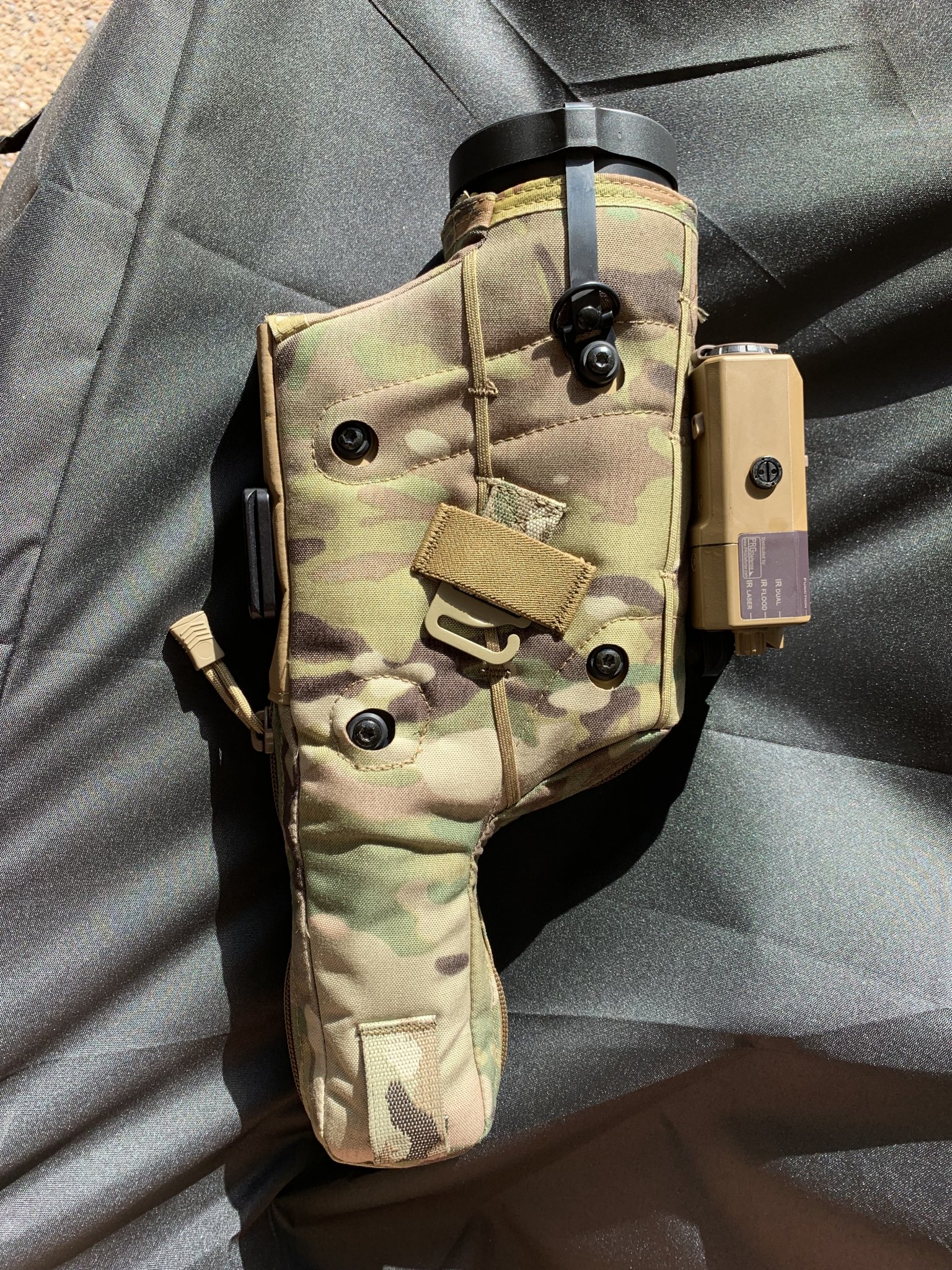

Ok, found my phone outside ... so here is what the contraption finally wound up looking like after zeroing the radius ...
I think it works well for ranging on 4x on the patrol as you have enough magnification to aim more precisely at the target to be ranged.
Reactions: Frog05

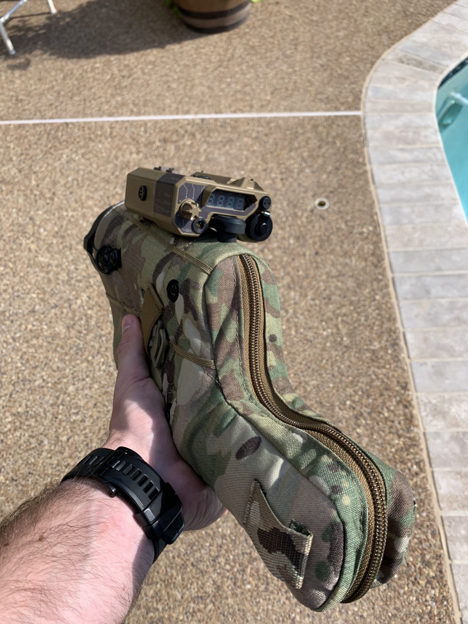

@SkyScrapin is thinking of trying this on a REAP2 60mm ... and except for size/weight I think it will work well.
My carbine mounted mk3 60mm / radius is similar and is a great spotter and having the carbine on a sling helps some with stabilizing, though I often carry a shooting stick also.
If I was carrying the patrol/radius combo shown above in the field, I would run a lanyard on the patrol and carry the whole contraption in a chest pouch.
skyscrapin might mostly run his on a gun, and he might be using a raptar. If I used a raptar on the patrol the size / weight profile of the above contraption would be reduced. But I want to put my new raptar s/es on the rifle as it has the ballistics module. So if I was to use the patrol as an LRF in the field anytime soon, I would use a radius (since I have 2 radiae). But, I'm thinking the carbine mounted combo of the mk3 60mm and radius probably is close enough, functionally for my purposes as to not need the patrol+radius combo. But I will take it out a few more times and see how it works.
And for those who missed it ... here is the carbine LRF/Spotter ... mk3 60mm with radius

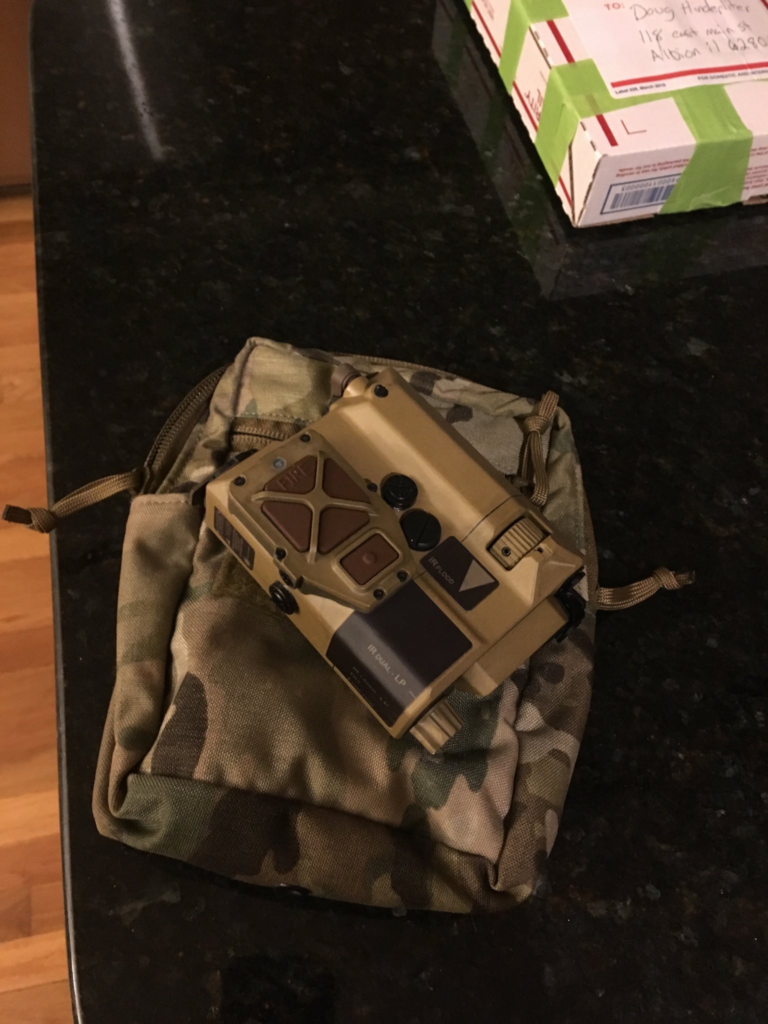

On the range finder topic. I've been using the new RAPTAR in my nightly coop patrol activities on the 7.62(20) NF 2.5-10x MIL-R setup.
The ranging seems very accurate and reliable. From say 37yds out to 550yds ... if the unit gets multiple ranges for a given attempt, they are returned in an array and you can cycle through them with the "left" and "right" buttons. This is not as handy as the Radius, which shows you 3 different distances on the screen and no clicking required. But with practice, thinking about the button clicks disappears and it happens fast. I"m not 100% there yet, but feeling more and more comfortable with it each night.
