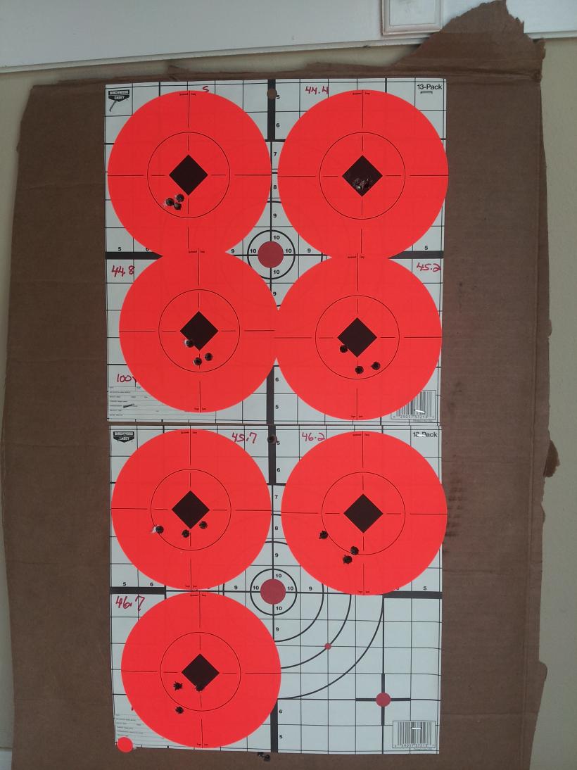

I tried this powder out today. Rifle is Savage 308 F/TR w/ 30" barrel with Berger 185 Juggernaut at .020 jump. I had not found this thread beforehand or I might have started with a higher charge. I did find really good accuracy between 42 and 44.5 grains, sub 1/4 minute at 100 yds at 44.4 gr. The top left target was three shots at different charges, 41.9, 42.7, and 43.5. Something seems to be going on down at that charge level. Not sure the velocity as I don't have a chrono yet, but I am not sure it will get me to 1000 yds.
I worked up to 46.7 and did not find anything with nearly as tight groups as the 44.4 charge. I am going to try to run it up to 48 gr tomorrow and see what I get. Maybe I will find something right at or just over 47 gr. The 48 gr worries me as I live in the south and it gets way over 90 down here in the summer. It can be 80/85 at dawn during a hot summer.
I am going to work it up from 45 gr. This is a brand new rifle and I am not used to it, so I would like to make sure I didn't screw the pooch on some of the shots though the top two targets lead me to believe I was capable today as these were all fired round robin, not one target at a time. After that I will experiment with length.

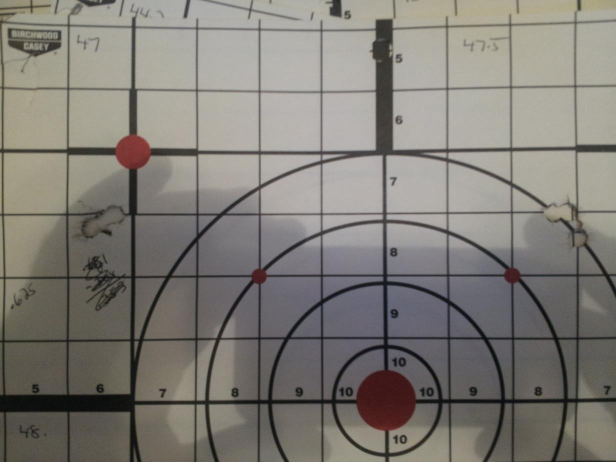

Found It
Found it at 47 grains. 47.5 looks decent as well. 48 wasn't as good. I would like to shoot this load in the heat before I try to go any higher.
