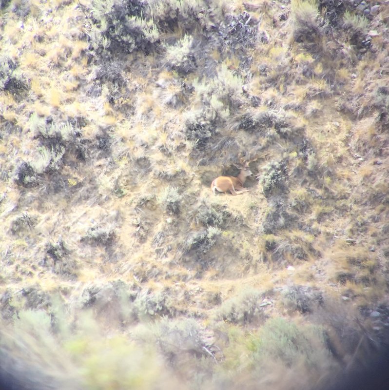

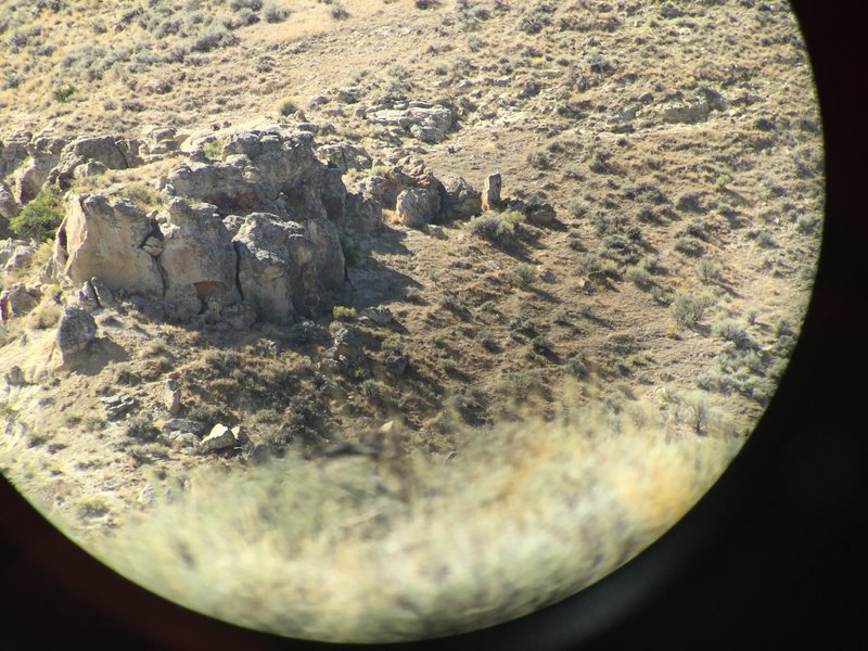

I run the new 10x42 EL Range. Great glass, ranges well, reasonable size and weight and I had Outdoorsmans install their stud. It is the in my opinion the very best way to utilize the binocular on a tripod. https://outdoorsmans.com/products/ou...l-stud-install
I find game that I would otherwise not see using my glass on a tripod. Found a herd of Elk (cow season here) because my binocular was totally stable and saw the movement 3 miles out, therefore butchering again tonight.
if trophy hunting I can swap out quickly to my Swaro BTX 85 to get a better look.
I owned have owned a couple of Leica HDB’s with mixed ranging results (fine glass - but wouldn’t say better than my Swaro) but not being able to mount them using the outdoorsmans adapter https://outdoorsmans.com/collections...ocular-adapter is absolutely a deal breaker for me. With their stud/adapter system you gain full use of your bino adjustment as opposed to being strapped to a plastic plate.
The ability to sit behind glass without any tremor whatsoever is a huge benefit, you see the slightest movements - ear flicker, horn turning or shapes that you are trying to find (like a sentinel cow’s head or legs in timber)
