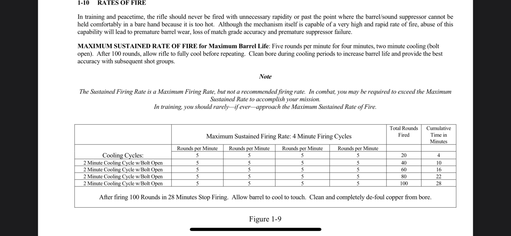

Do the same rules of rate of fire apply for semi-auto precision rifles as bolt guns?
I would hate to damage a precision semi using it like a standard AR.
Beyond common sense, are there any specific parameters to follow?
Advice?

If you are really interested in this subject - read up on 'Heat Checking'. A more bottle nosed cartridge will (generally) induce more heat; couple this with an advanced rate of fire and you can get a situation where checking or cracking in the subsurface layer of the finished barrel can occur. With subsequent firing these cracked layers flake off. Needless to say - there are a lot of variables on all that.
Pound out an occasional full mag on steel - sure. All the time...probably going to shorten the life of barrel.....which is a consumable....
