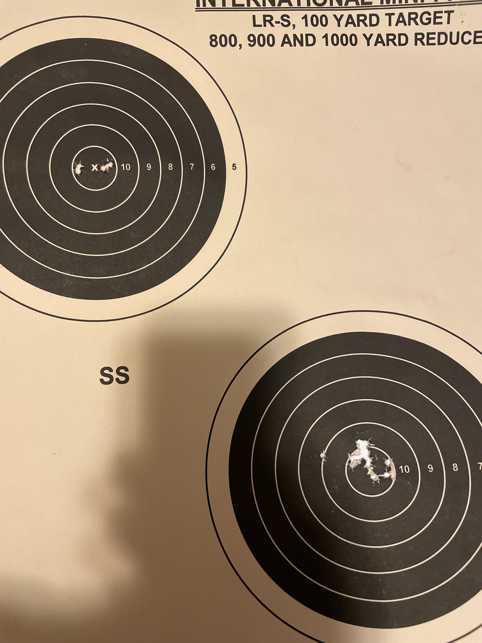

OP, the gen-3 Razor is a great optic for the money, as is the gen-2. I have a ZCO 527 on my main match rifle. Is the ZCO "better," a term that carries a Great Deal of personal preference weight? In some ways yes. Is it $1000 worth of better? Not to me. A couple weekends ago, I shot a little mini-Palma/F-class rimfire match. Weather was cool (low 50s), damp, a bit misty with the occasional downpour. I was able to see the bullet holes in the black 100-yard targets (photo). No one else could, including my buddy who had a Nightforce ATACR on his RimX.
