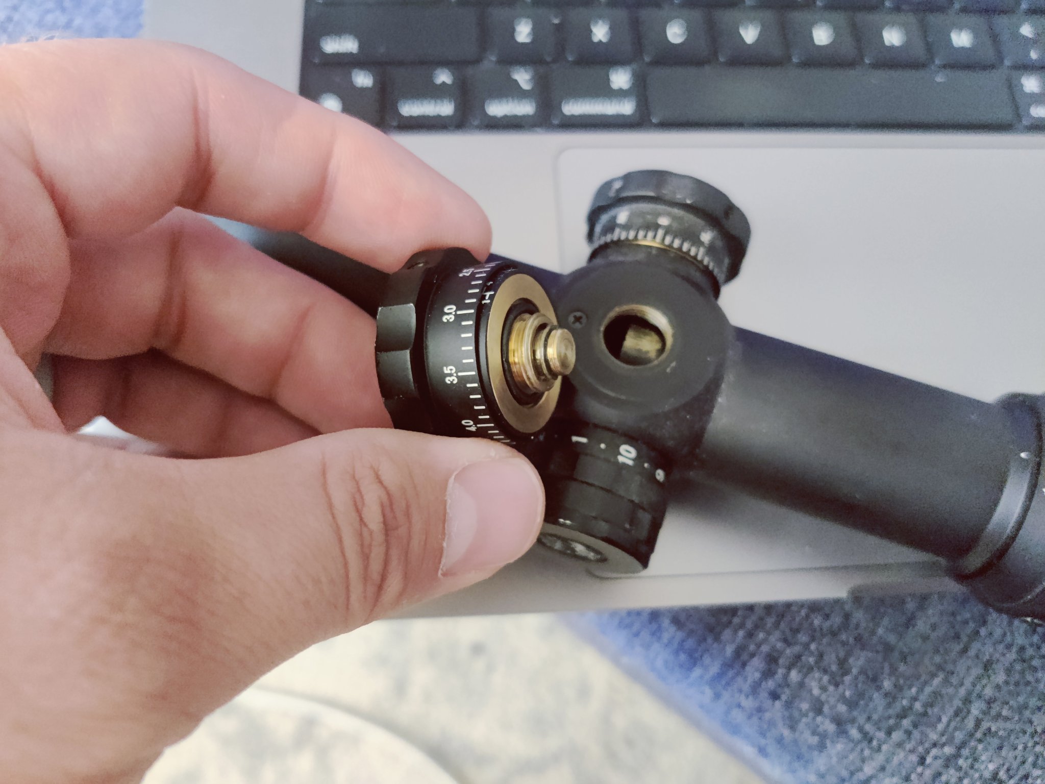

This is a busted SWFA that I never bothered to send back for repairs because it was an interesting thing to have lying around anyways.
I don't know anything about how much metals expand/contract per degree Fahrenheit, so this could be a dumb question. Forgive my ignorance. If the piece at the bottom of the turret that pushes against the erector tube is made from a metal that can expand/contract enough in a 50°-60°, could this affect how much distance the erector tube is depressed?
I went ahead and plugged a hypothetical 10x6mm cylinder into Chat GPT (not conclusive, but I figured it'd answer my question enough) and what it gave me back was:
So, the brass cylinder will expand approximately 0.0058 mm in height and 0.0035 mm in diameter when the temperature changes from 50°F to 105°F.
If that where thousandths of an inch, I could maybe see it. But I think @koshkin's probably right when he says "That is several orders of magnitude larger than the expansion rate of aluminum or brass or stainless steel or any other metal you might find in there."
