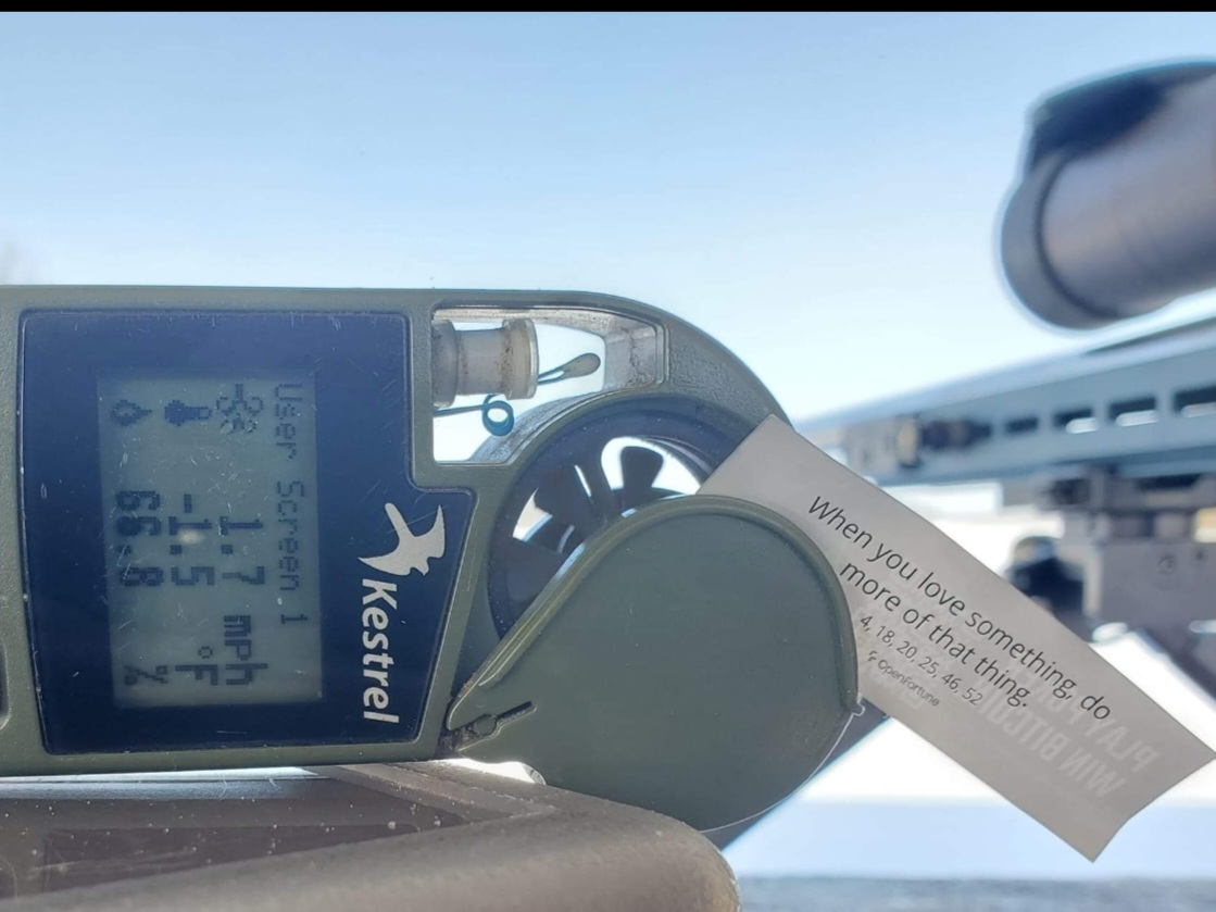

My G3 doesn’t experience a zero shift with temp changes. Just last week I was pressure checking some reloads and sat the rifle outside on my deck in the sun to let it temp soak. The deck has dark gray paint and the surface temp was 162 degrees per my temp gun😳. The concrete sidewalk was only 109. Ambient temp was 100 degrees. I got busy and forgot the rifle for 2 hours and then shot 5-rounds. Zero was dead on from the previous zero set at 70 deg.
I’ve started several matches in the 60s and finished them near 90, no zero shift issues experienced.
Neither of my G3’s have demonstrated a zero shift. 40+ degree temp swings are common/the norm here. I’m thinking someone just needs to keep their gun & ammo in the shade. I wouldn’t buy into this “thermal shift” theory unless the had a chrono going at the same time.
