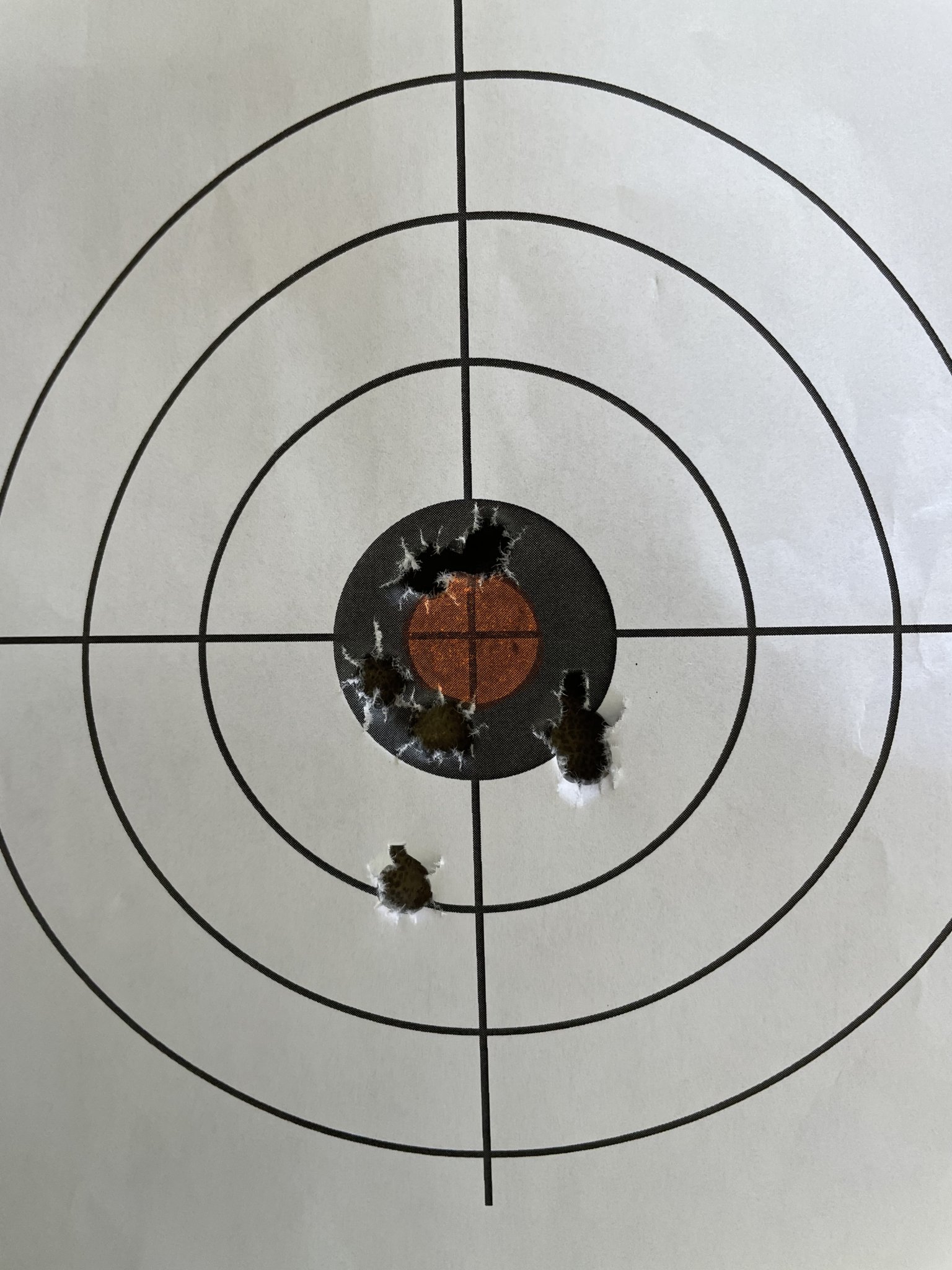

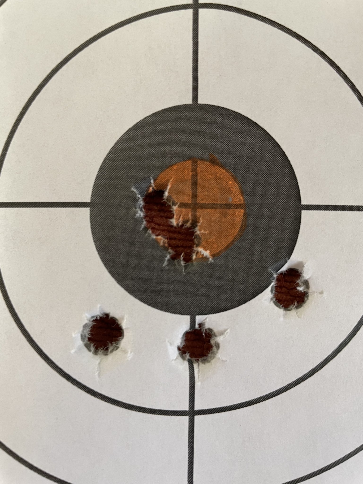

I can also state being behind both of these loads in the same rifle that the Remington on right was a violent recoil and the Norma 180gr Bondstrike was a lot more smoother and have measured those BCTO 2.170”. Accuracy is much better with the Norma as well.
