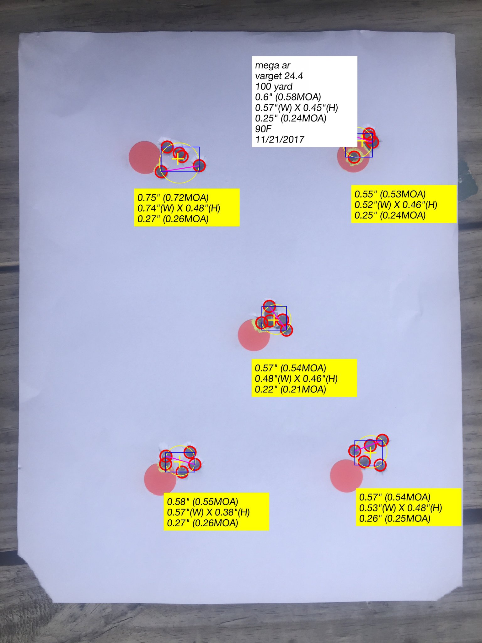

Ehh. I can build a .5-.7 gun for $850. It’s not that hard. There is no black magic. I think the black magic is in the ammo and the technique it takes to shoot an AR really well consistently.
Reactions: flyer and AMGtuned

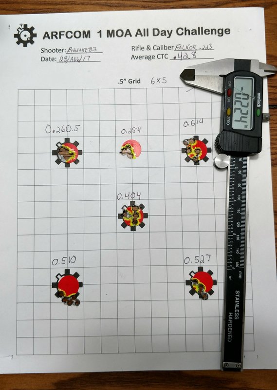

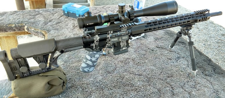

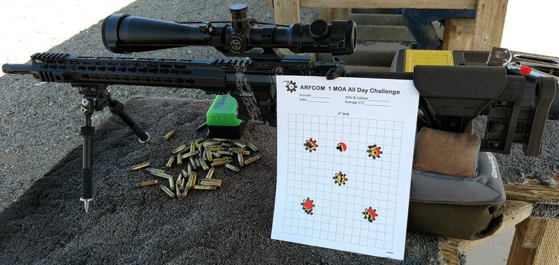

This is pretty normal, And she is still just collecting dust in the Safe. The complete build minus the scope and bipod was easily under $1,900.00
If you want one send me a PM.
Also holding SUB MOA out to 500 yards is and extremely realistic expectation, just buy a 20" Krieger barrel medium varmint Contour with a 1-7.7 twist that will favor the heavier 77gr Sierra matchking.
I'm happy to get 1 MOA from my 18" SPR style build, shooting 77 grain. It's my primary precision rig.
Really though, the limitation with this platform is how light the bullet is. It's difficult to see steel strikes past 600 if it's a chewed up target, and wind starts to play an enormous role at about that range as well. The light weight and moving parts of the rifle make it a bigger challenge for the shooter.
Overall, the AR-15 makes a fine precision round from 0-700m, while providing lighter weight, good firepower, and plenty of mod options.
View attachment 6951309View attachment 6951313View attachment 6951315
Dang good target there. Did you adjust the scope after the .510 group or was that a change in POI from position?

Yes, I'm aware of the 5 group challenge and I agree that it helps to separate out the shooters from the bull sh**ters. I have no doubt if I shot 20 5 shot groups with one of my AR's a couple would be sub MOA, but that doesn't mean that either me or the rifle are sub MOA shooters. Now if I switched to my bolt action rifle I could do pretty well on the 5 x5 Elfstar challenge, but that's a whole other animal and not much of an accomplishment.
And hitting golf balls at 400 - again that's damn good shooting, not sure I could do that with any consistency using my bolt gun.
And to get back to the original question - although it's great to be able to hit golf balls at 400, for my purposes, being able to hit a 1x2 steel plate at 600 is all I need. That's basically the size of a male torso. If I'm going out beyond 600 I'll use my SIG SSG3000. Don't really see the need to be able to put a lot of rounds downrange quickly at those distances.
For sure all you need is man sized targets if you are fighting an enemy that likes to stand in the open facing you. "Minute of man" as people like to say. But let's be honest with ourselves. Unless we are deploying for war there is a 99.9% chance none of us will ever put an actual person in the cross hairs of our scope, thank God. And if we did, it is unlikely that the enemy will stand with their torso facing us and wait for us to hold over and take a shot. The first one might but after that they will scatter and hide and your aiming points will become very small.
For me guns are more of a fun thing to build and shoot, the more accurate they are the more fun and interesting they are. And bonus, coming from being able to hit golf balls at 400 yards with an AR, if zombies did decided to try to take over they would be in a world of hurt long before they got anywhere near my house. While zombies are about 1'x2' a lot of zombies may know that it is best to hide behind things and be coy. So you may only have a softball/golf ball sized window to hit the bastards. Start with the ones at a mile with the Norma, and then clean up the ones that got through to 400 with the AR, then let a few get past that on purpose for some carbine and handgun fun.
I'd be proud to consistently hit golf balls with my AR-15 build at 400. Sounds like a new challenge.
Then again, I do confirm zero by shooting through a 1/4" square hole on steel plate at 100m.
Where can I find the 5 group challenge?
