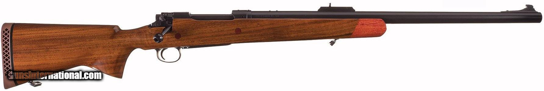

It used to look like this:
And mine looks like this now in 30-06.
