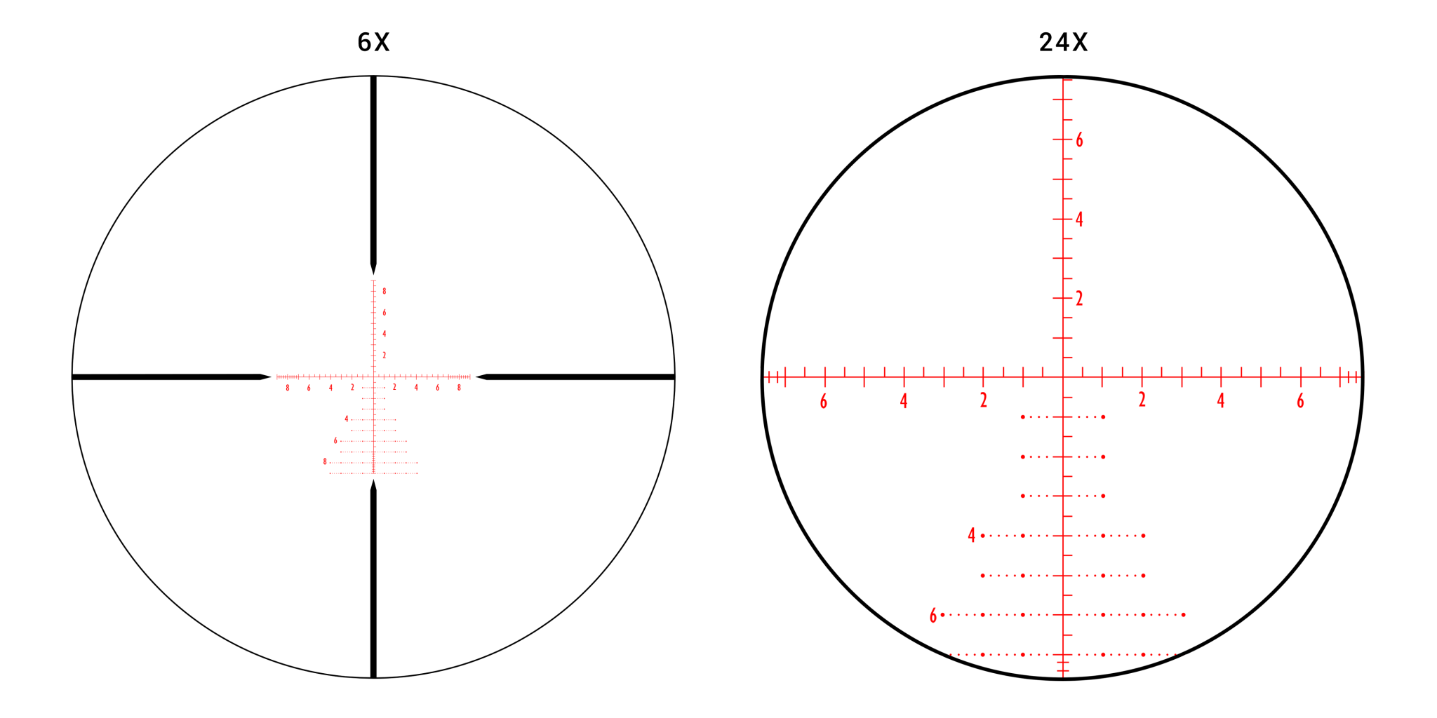

Which appeals more, FFP or SFP?
I think some people are using SFP because they think it does not mater on a 22 and price / magnification is what they are chasing.
My preference is FFP on all my scopes for consistency.
Shooting a NRL22 match last week, I had a huge advantage of the guys using SFP as there was a hold over stage only and max zoom for the SFP was slower to acquire targets. I also think I had a BIG advantage on the paper stage with the thin reticle on the GENII PST at max zoom. Those two stages created a lot of separation. I shot 430, but gave up points because I can't see out of my right eye well and shot wrong target a couple of times. Hence why I now shoot everything on my weak side my right hand actions, it is just ironic that when I switch to the old strong side I can no longer shoot.
When I switch to the centerfire for the following days match all seems congruent.

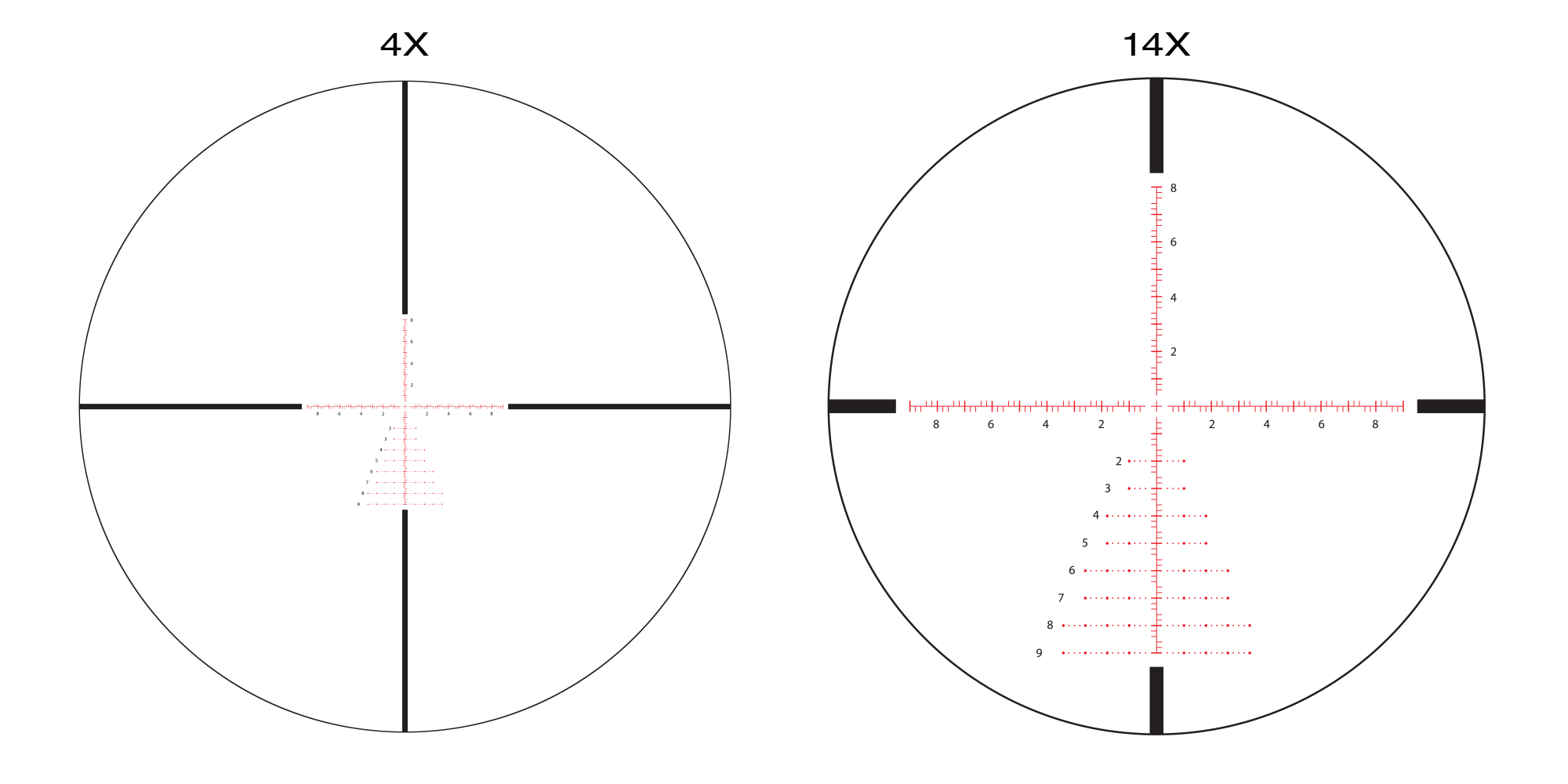

The thiner APLR2 reticle as the Talos FFP is nice; but the turrets.. Ya, on my other loaner 22 I don't turn them, ask people to use holds - The price for the features is really attractive for the 22 guy on a budget shooting positional matches.
The Argos BTR with APMR I tried, was a bit soft at max and the reticle a bit to thick at max as well (paper stage in NRL22).. If the APLR2, or similar was in the 6-24 BTR that be great~
