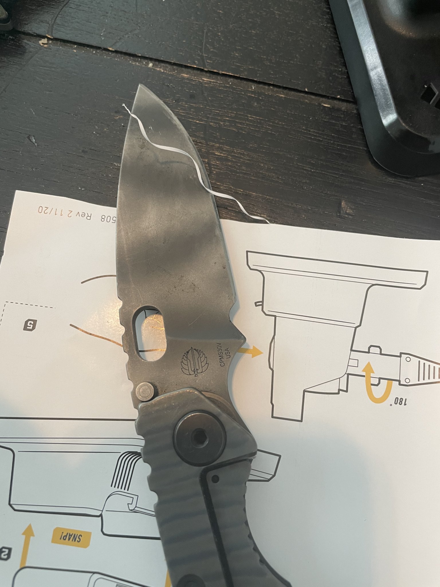

You obviously don’t use a knife if you’re starting with a 4000 grit stone, that would take forever to restore an edge on a user. The rest are just dumb, there’s no reason to put that kind of edge on a knife. You can do scalpel sharp with ordinary sharpening tools and that’s as sharp as a knife needs to be. Nevermind the fact that your 12K grit edge would be long gone after cutting a single box.
This was the result of less than a minute playing around with the worksharp micro adjust. When you can shave and whittle paper in little slivers, that’s dumb sharp and as sharp as a knife needs to be.

Like I said earlier, you guys don't know what a sharp edge is.....and you keep proving that.
And you keep proving that you don't know what is practically for field use or EDC. Maybe you're doing dumb YouTube shit like slicing tomatoes paper-thin; everyone else is opening boxes taped with that fiberglass stuff and prying stuck 22LR shells from dirty chambers.
