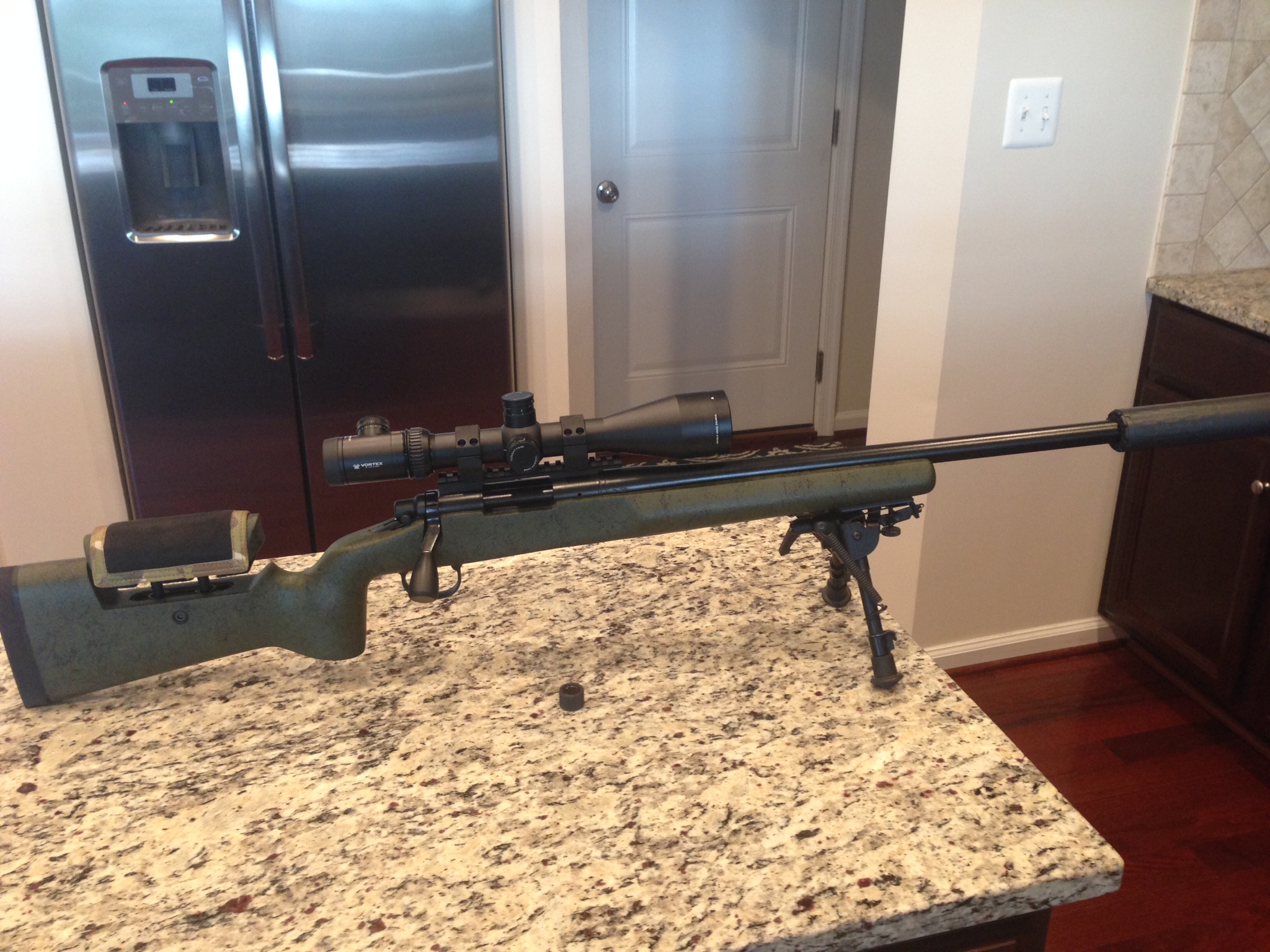

My sps tac 223 is the rifle I shoot most. I just dropped it off yesterday to finally get cerakoted. I did duracoat rattle can years ago but its starting to show wear.
Mine has a Timney 510, EGW 20 moa base, threaded 5/8-24 and a badger knob. Its been in a B&C tactical for years but recently threw it into a KRG Bravo and love it. I can use MDT mags now and seat bullets longer.
All in all, it has been a very accurate rifle. Yes, they have QC control. You could always work up the factory stock, and coat the barreled action and be done. I have seen a few sps tacs on here completely factory that are hammers.
For youth/new shooters, I don’t think it is a bad option, at a low cost.
First pick is factory coating. You can really see the layer of rust between the bolt. Whats you can’t see is what was on the barrel.
Second pick is after Duracoat. It was really easy to do just a little prep work.
