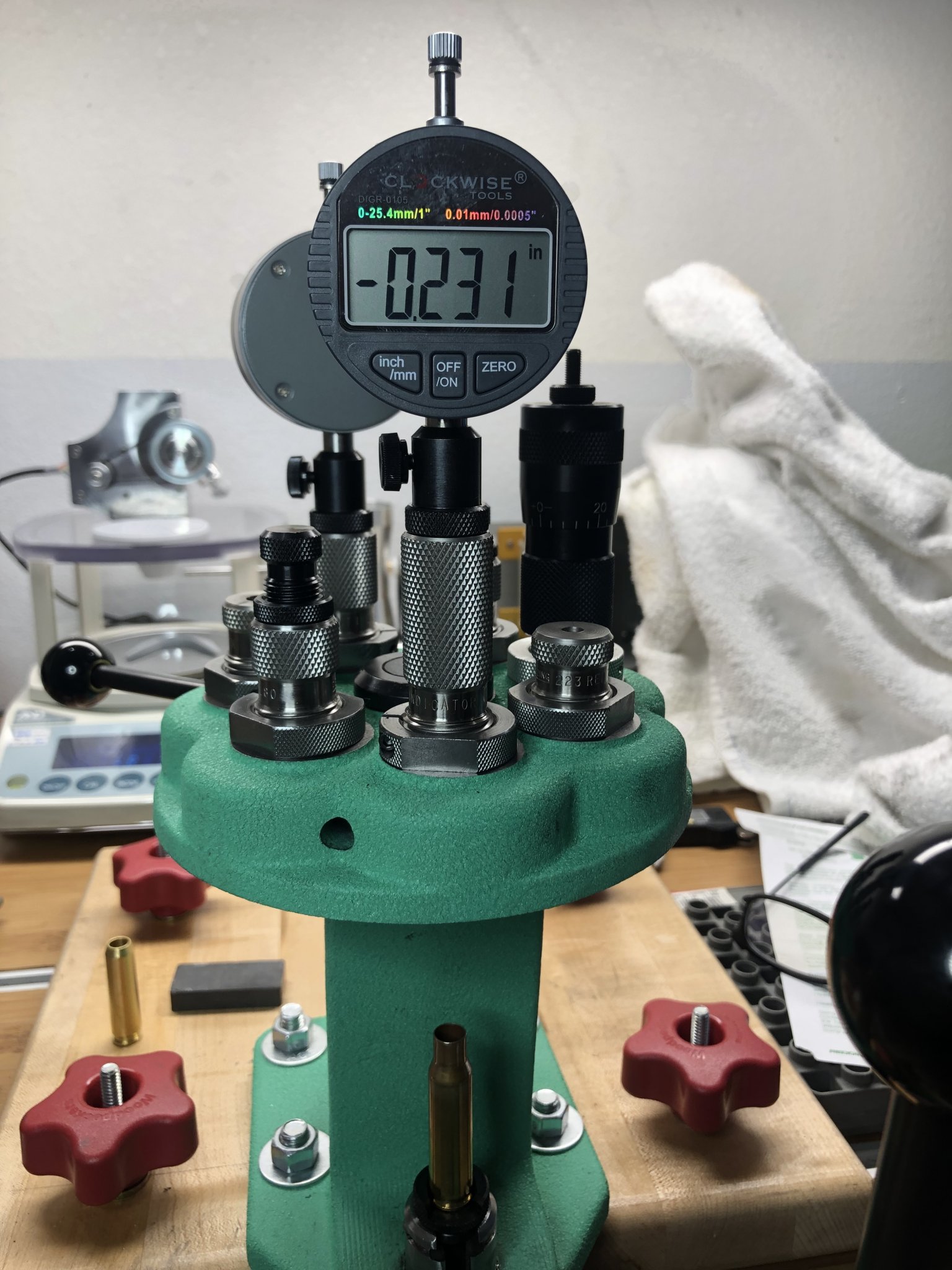

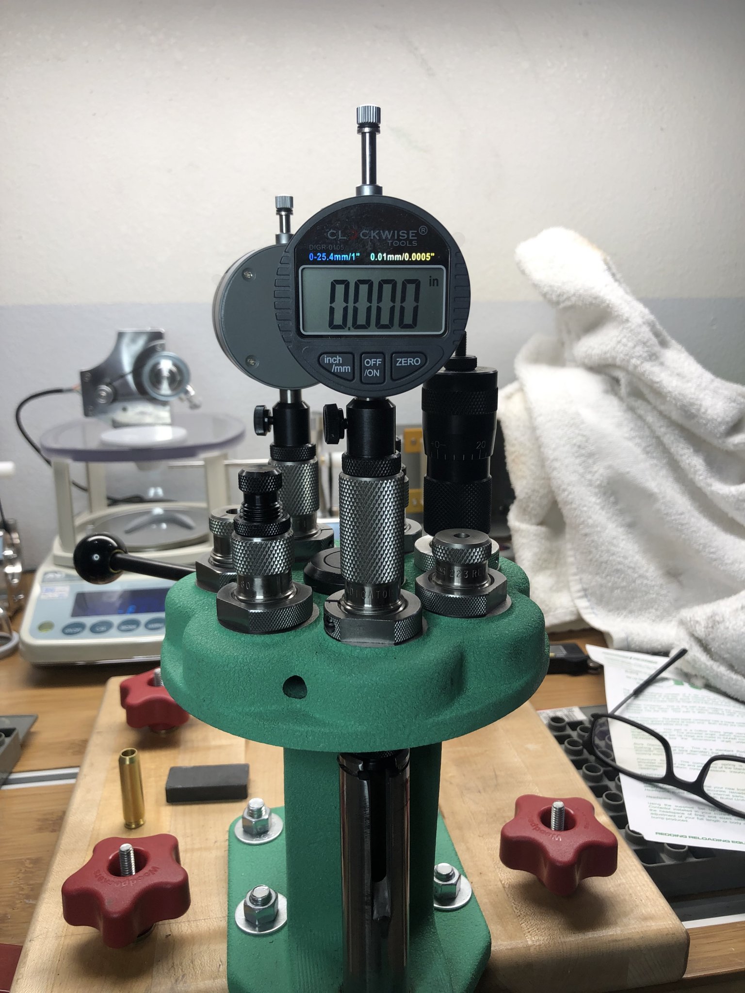

    I do.. after sizing, I check every 3rd case for consistency. I also do the same for seating too.
