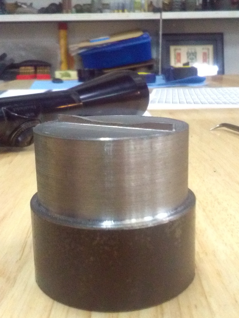

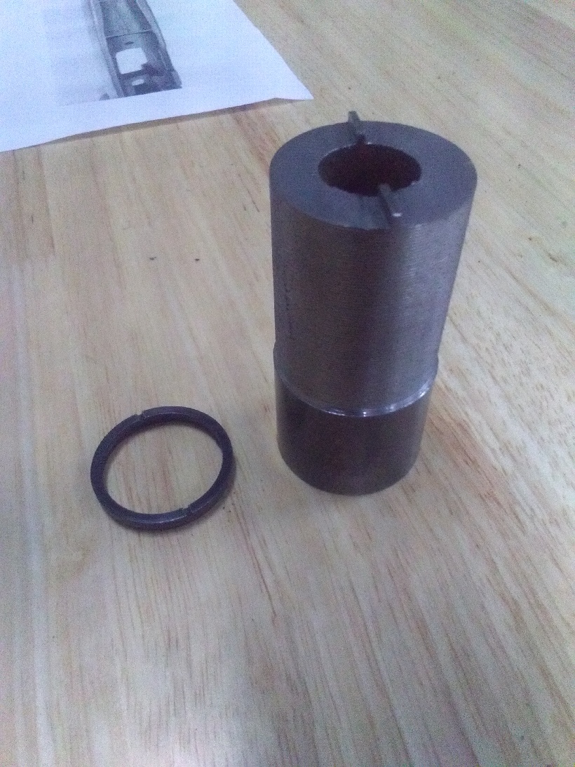

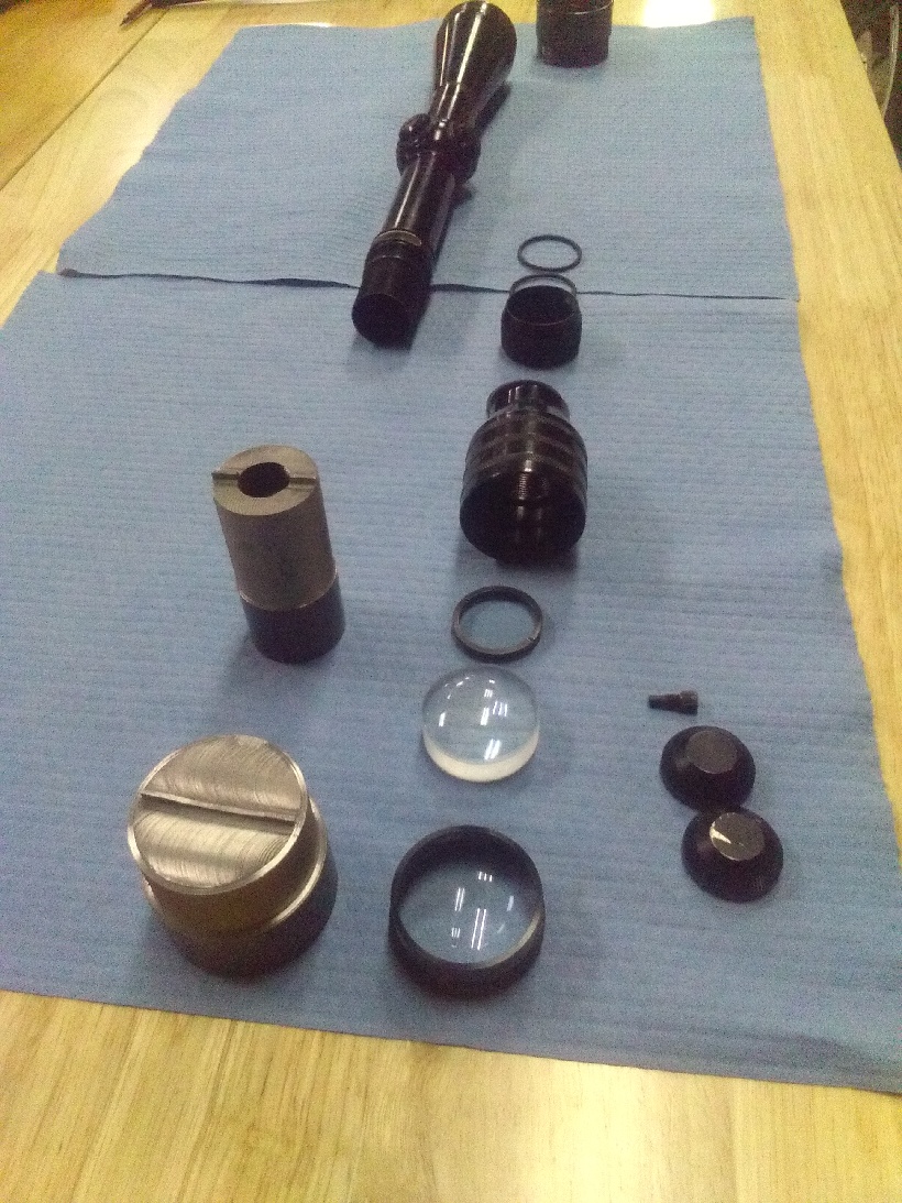

Had some time this weekend to make two of the tools to disassemble the Redfield. The first few parts were straight forward. I'm going to pull some measurements on the other parts not knowing if they are adjustable of not.
I have ordered the Caswell OD dye that was suggested.
With a little heat using a heat gun. the lock rings unscrewed easily.
