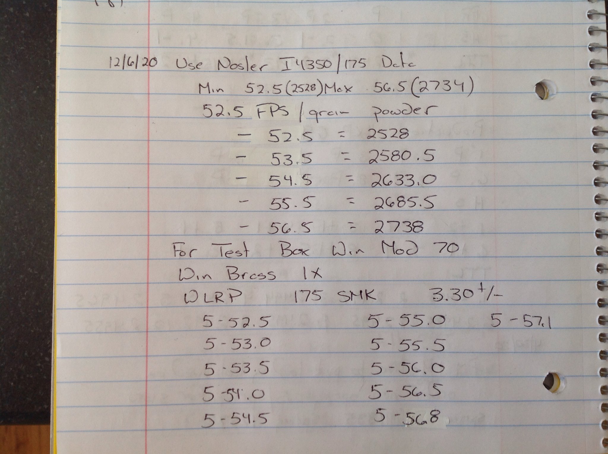

Gonna try to reload a box of test rounds today.
I 4350
175 SMK
Win LRP
Win 1X brass
3.30 OAL
My figuring....
