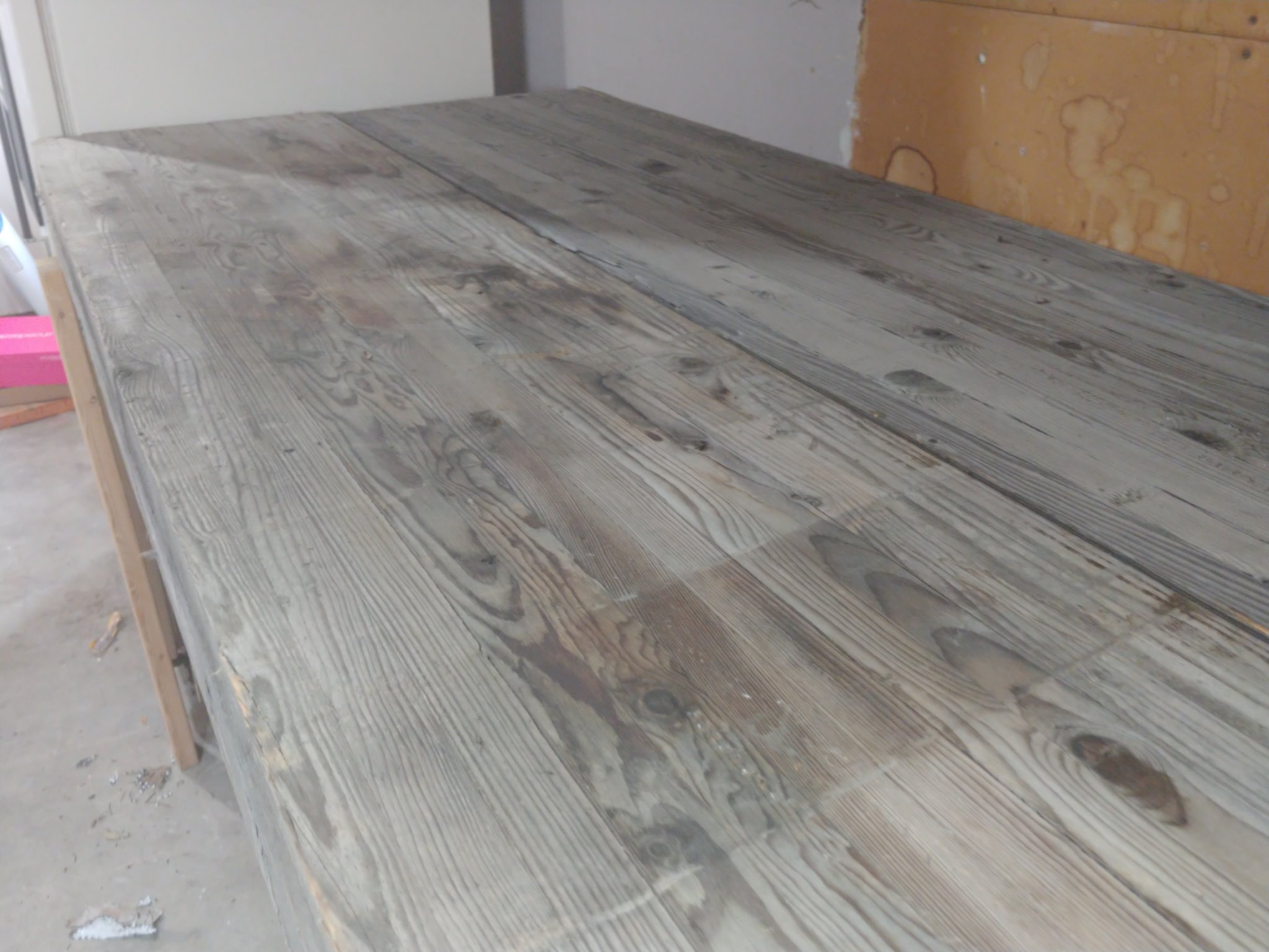

So I acquired a 6.75" by 18" by 40' beam for a whopping $10. BUT it's pretty heavily weathered. I love the grey wood but its rough and full of splits and splinters. Trying to decide how to finish it. Sand the beans out of it and oil it up. Or dam the top of it and clear epoxy this thing to lock in all that character.

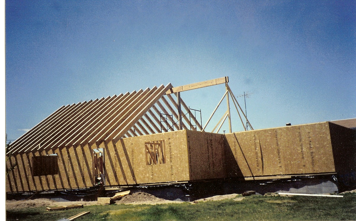

I used this big bastard.
To lift 10' sections into my small truck.
About 320 pounds each if the math is right. So near 650 pounds for the whole bench.
With some ingenuity I got them into place by myself. 10' long x 32" deep.

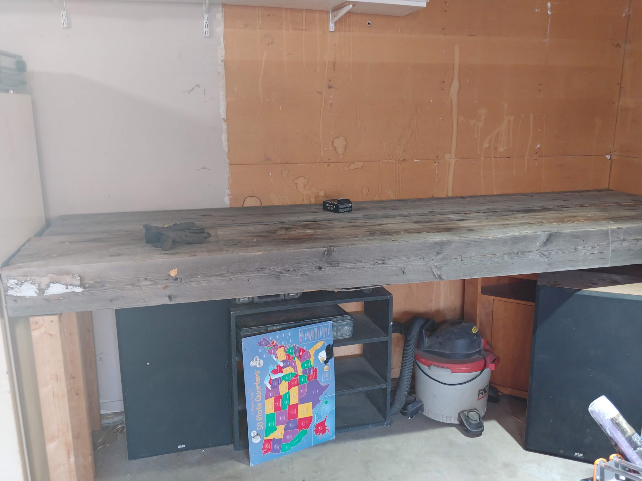

So after much screws and lags the bench is secure and level.
So this is the before. Lots of grey wood.

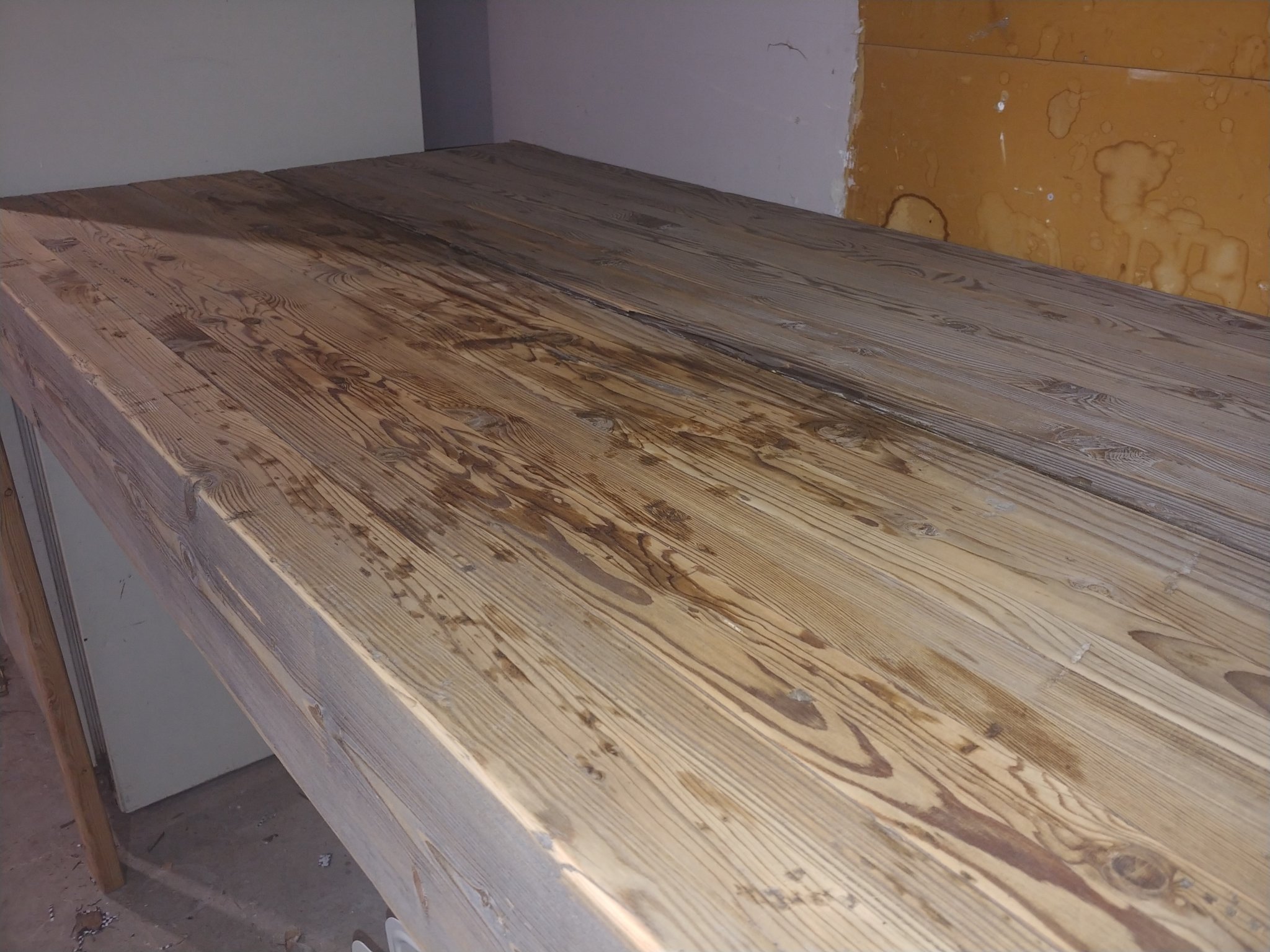

Picked up a new sander and 60 and 120 grit paper. And went to town.
So the front beam was flatter than the back. So it smoothed out more. It kinda looks perfect. A flatter smoother piece in the front where you will touch more often and the grey character on the back piece thats more likely to have shelves and boxes on it. It was also sanded to 120.

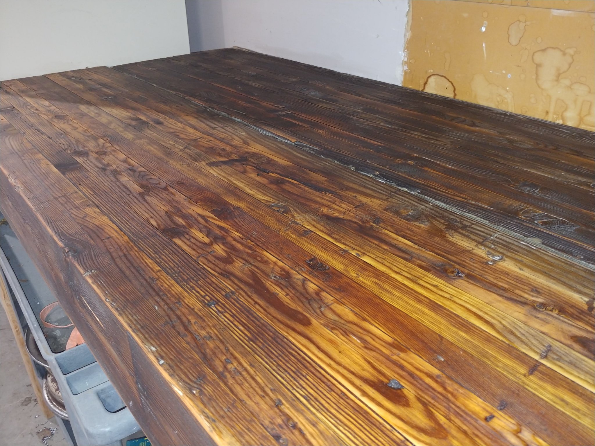

So I think I'm gonna go with straight tung oil.
