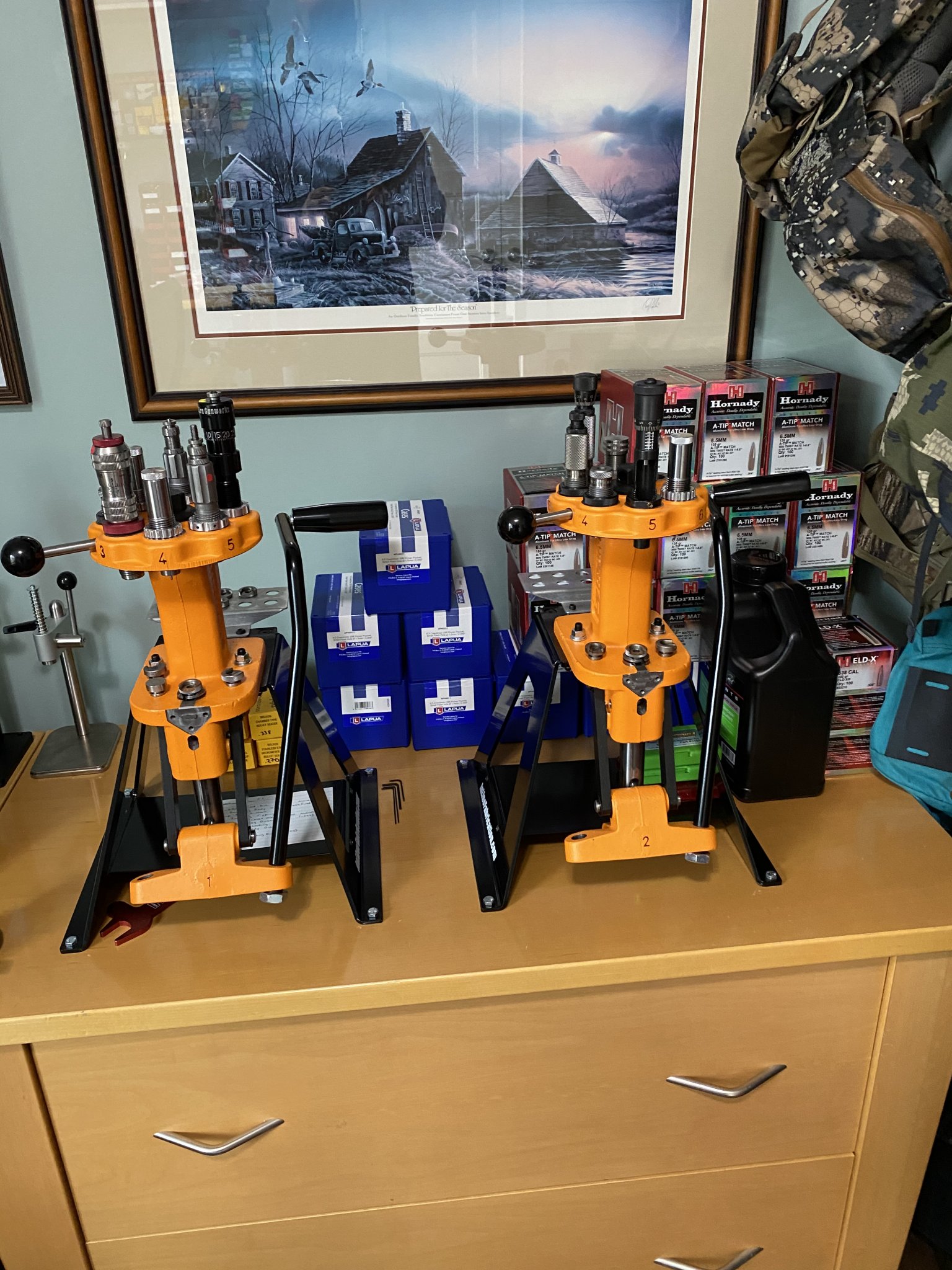

Only recommendation is to prominently deploy foundations and bases from Inline Fabrication ... it will give you maximum flexibility and allow the same space to leverage multiple tools.
Inline Fabrication makes some nice stuff! Thanks for bringing this company to my attention. I will definitely be ordering a press stand and wall mount system.

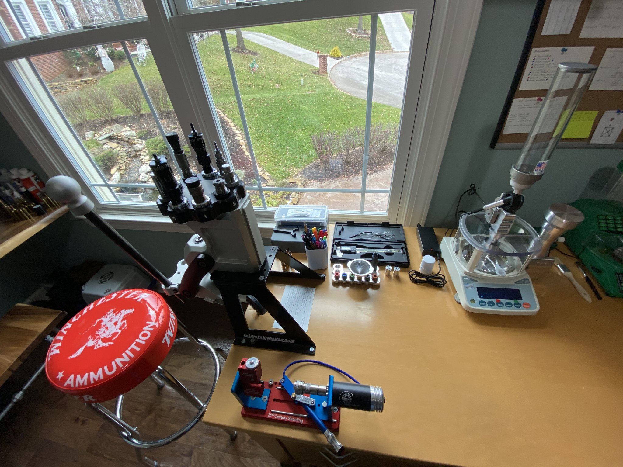

I move from left to right once I have my cases deprimed, resized and tumbled. I also keep my vibrating tumblers on the floor, not on the bench top with my scales.

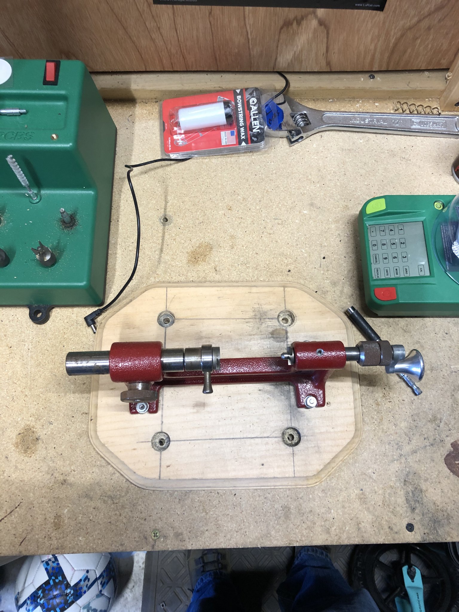

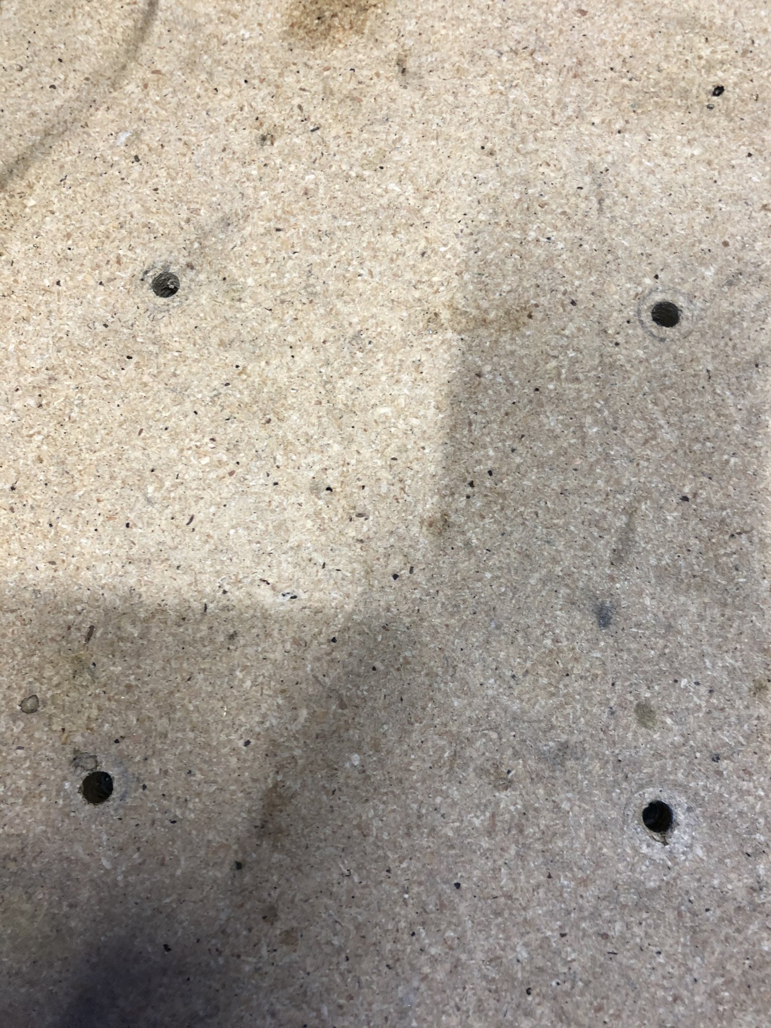

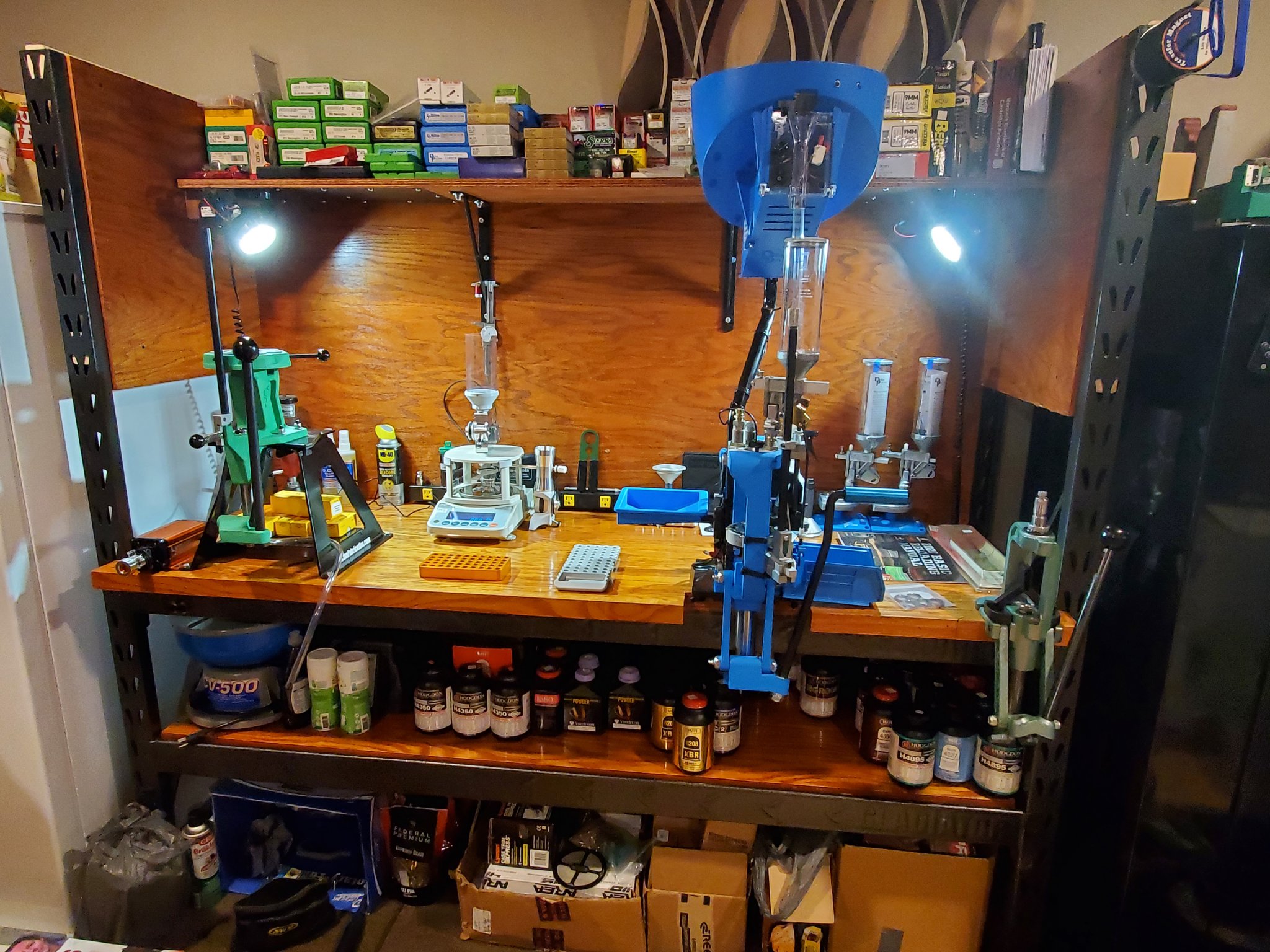

If you zoom in on my picture you can see four 1/4” holes in the top between the brass prep & powder thrower. I have captured T-nuts on the underside of the MDF and use them to bolt down various items that are easily removed. My two favorite are a single stage press I use to deprime and my Hornady trimmer. They store off to the side and don’t eat up a lot of space.
I like the idea of being able to remove components from the table top. I would like to build it so that it can be disassembled and moved easily if I ever move.

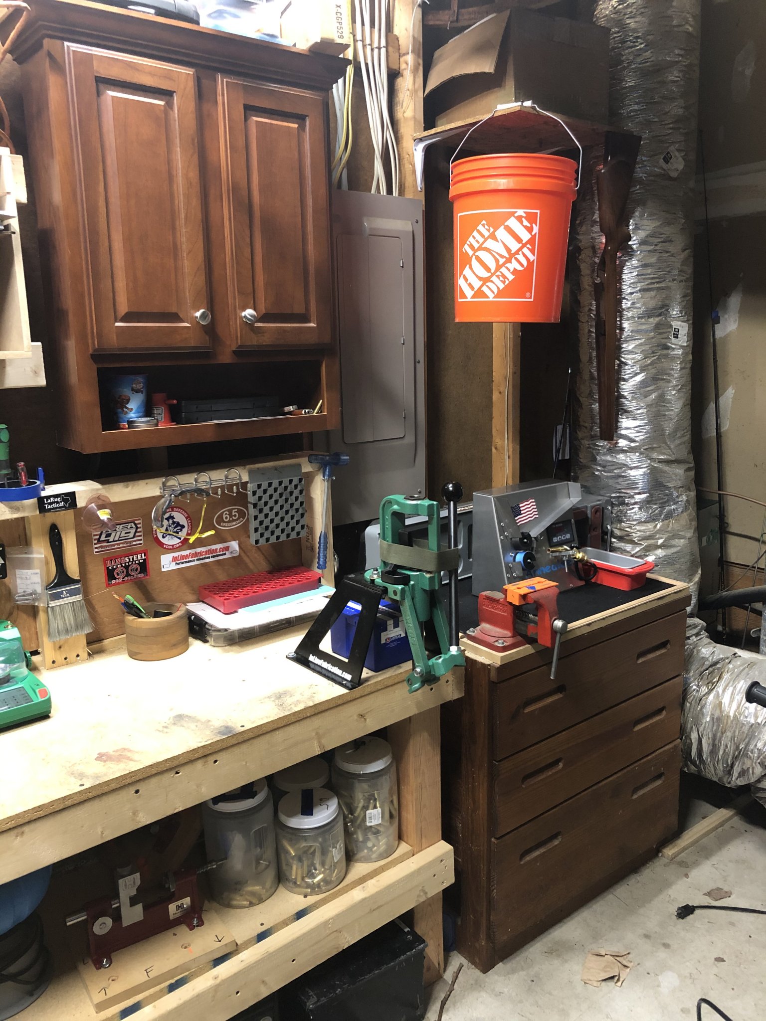

I bought this from Lowes years ago and made a bench out of it. Its a little bit small but serves the purpose. But I agree with the above post, the sams club bench does look nice as I've been eyeballing them myself.

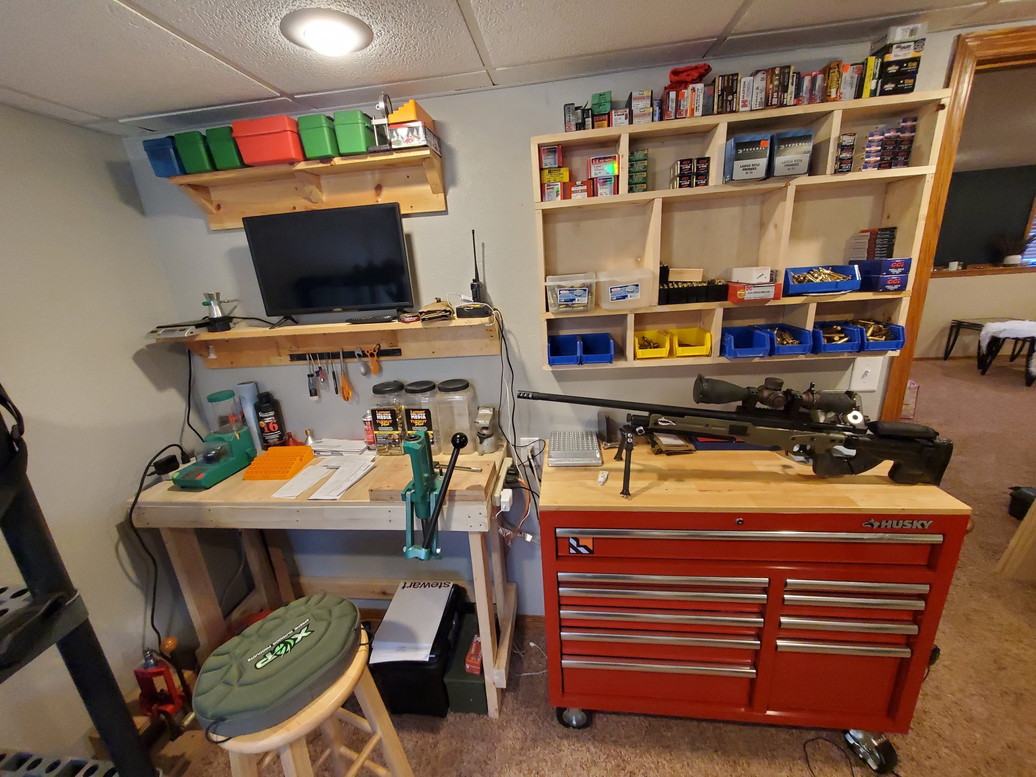

I decided to make mine less than permanent, in case I decide to move out of this shit hole state. Not too big taking up space, not too small with no room to work. Weighs enough that with the casters locked it doesn't move.
I did decide for a solid countertop design. 3/4 MDF with 3/4 hardwood flooring glued and screwed from below. Press and vises bolted right to it. Solid. Built it on a Saturday.

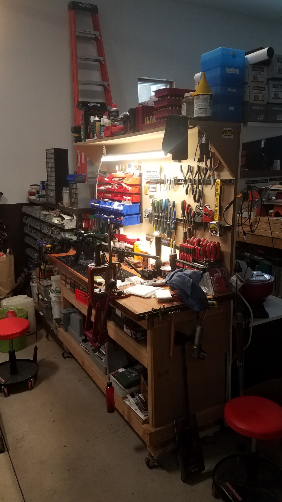

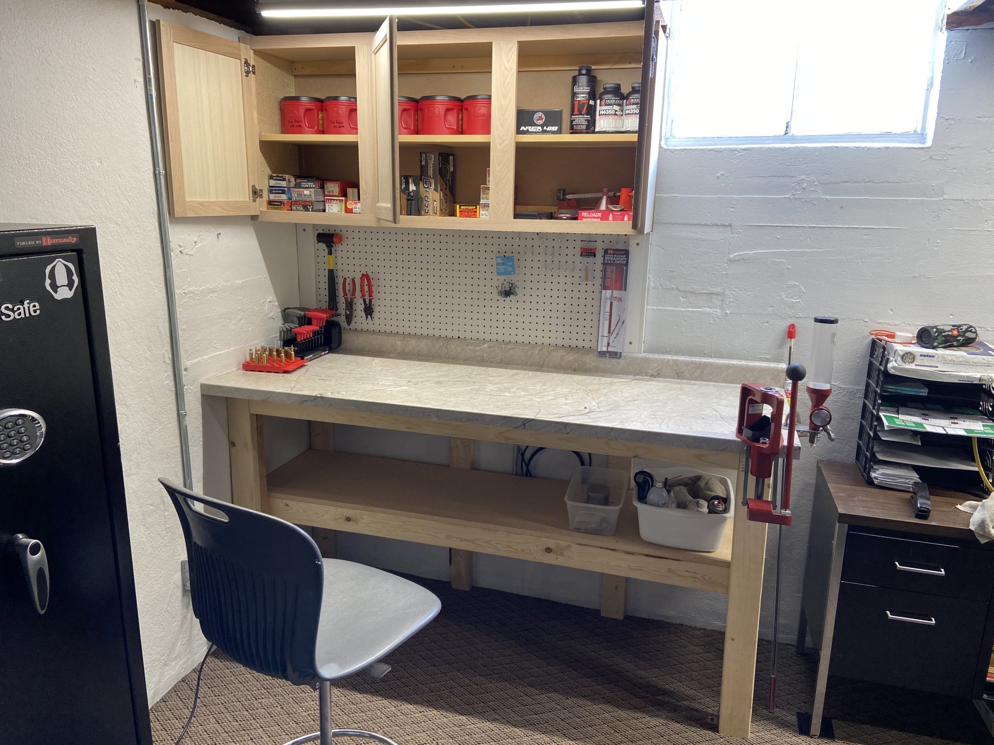

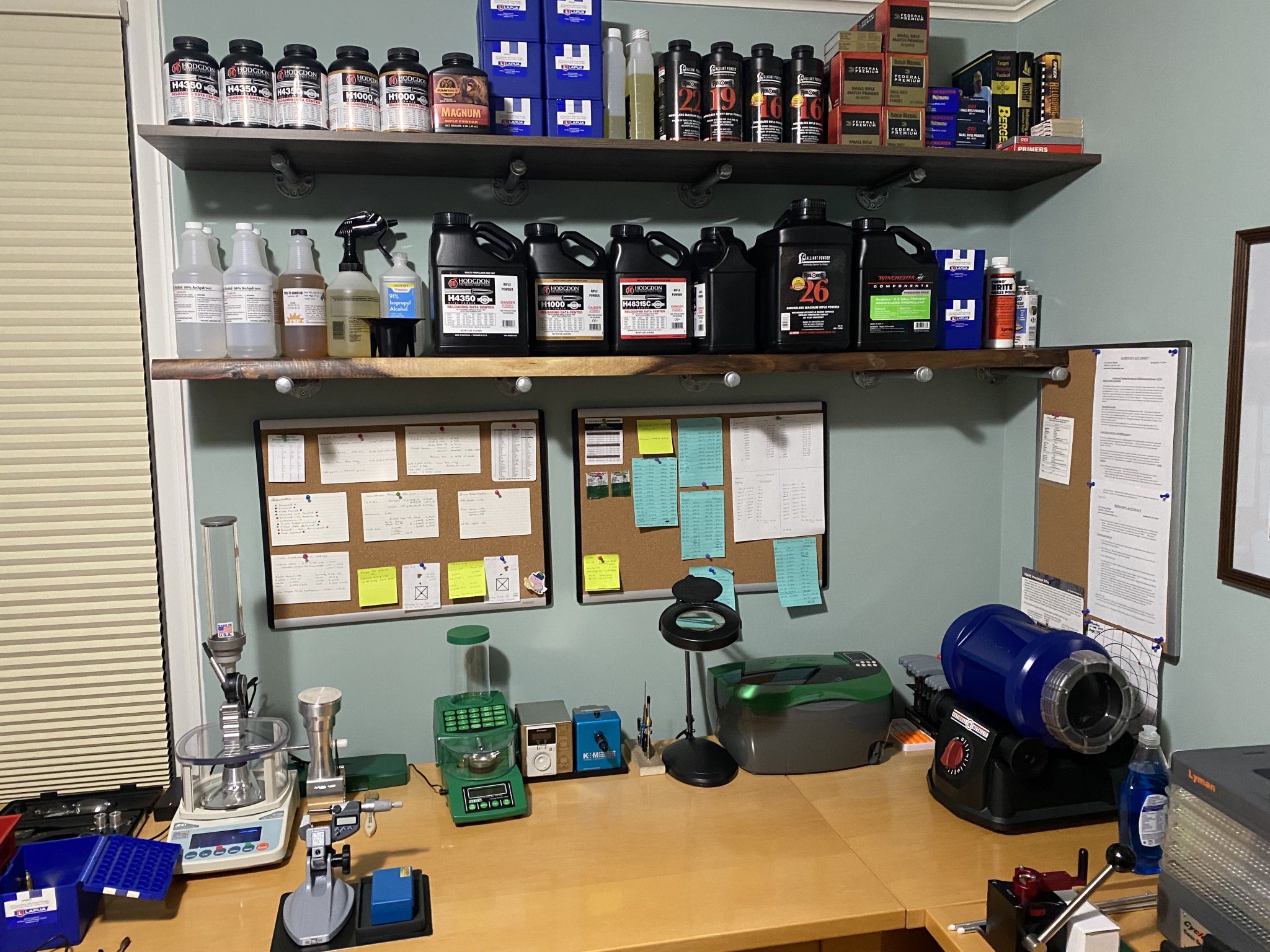

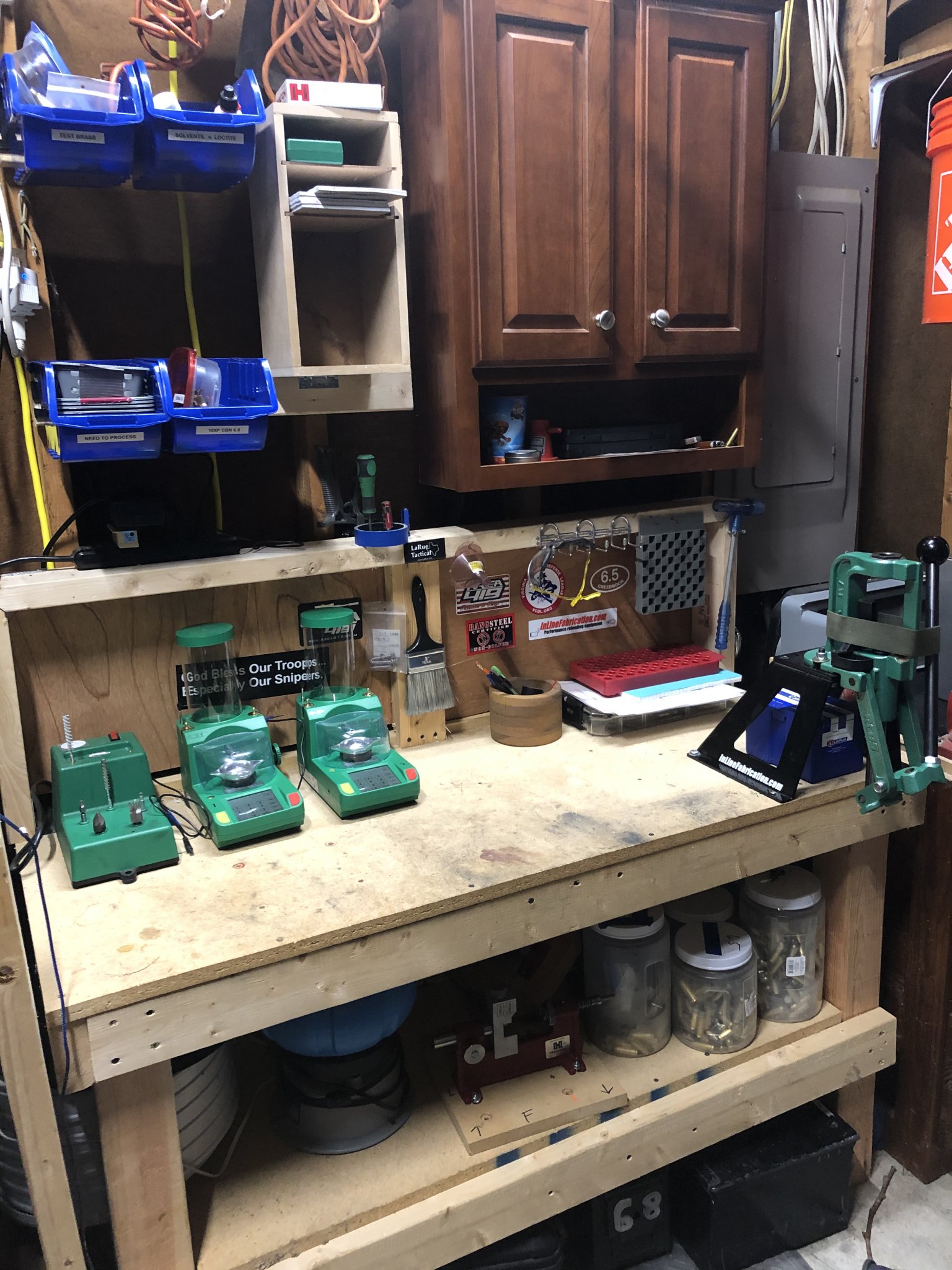

I changed my space up slightly after adding some additional equipment. The empty cubbyhole is for my micrometer stand that’s on the way.
Under the wall cabinet sit two sets of calipers that I really need a better place for.

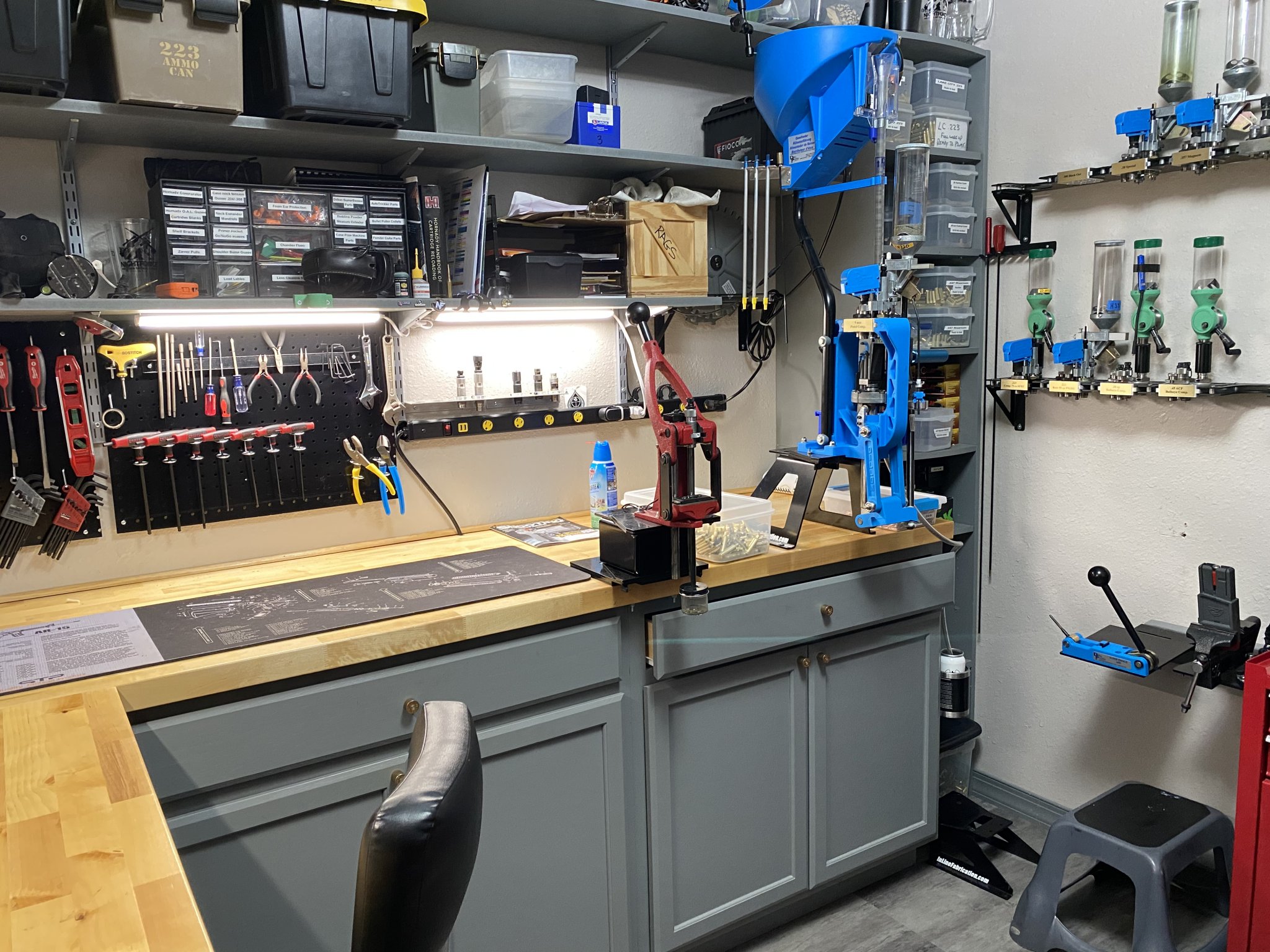

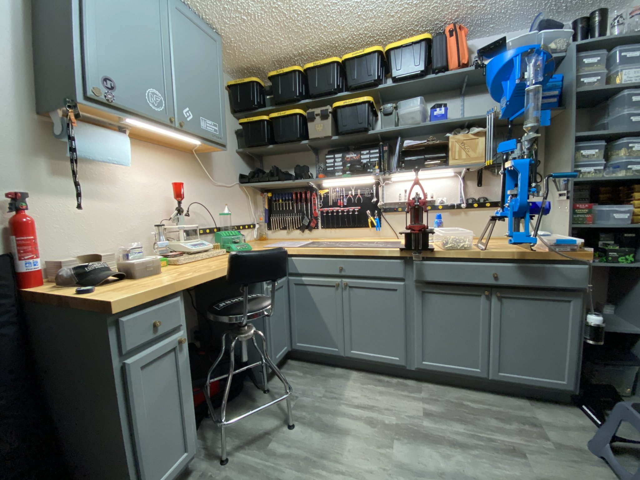

I found a butcher block topped table for $30. Removed the legs and mounted it to a more stable bottom. Semi-permanent montes tools along it.
