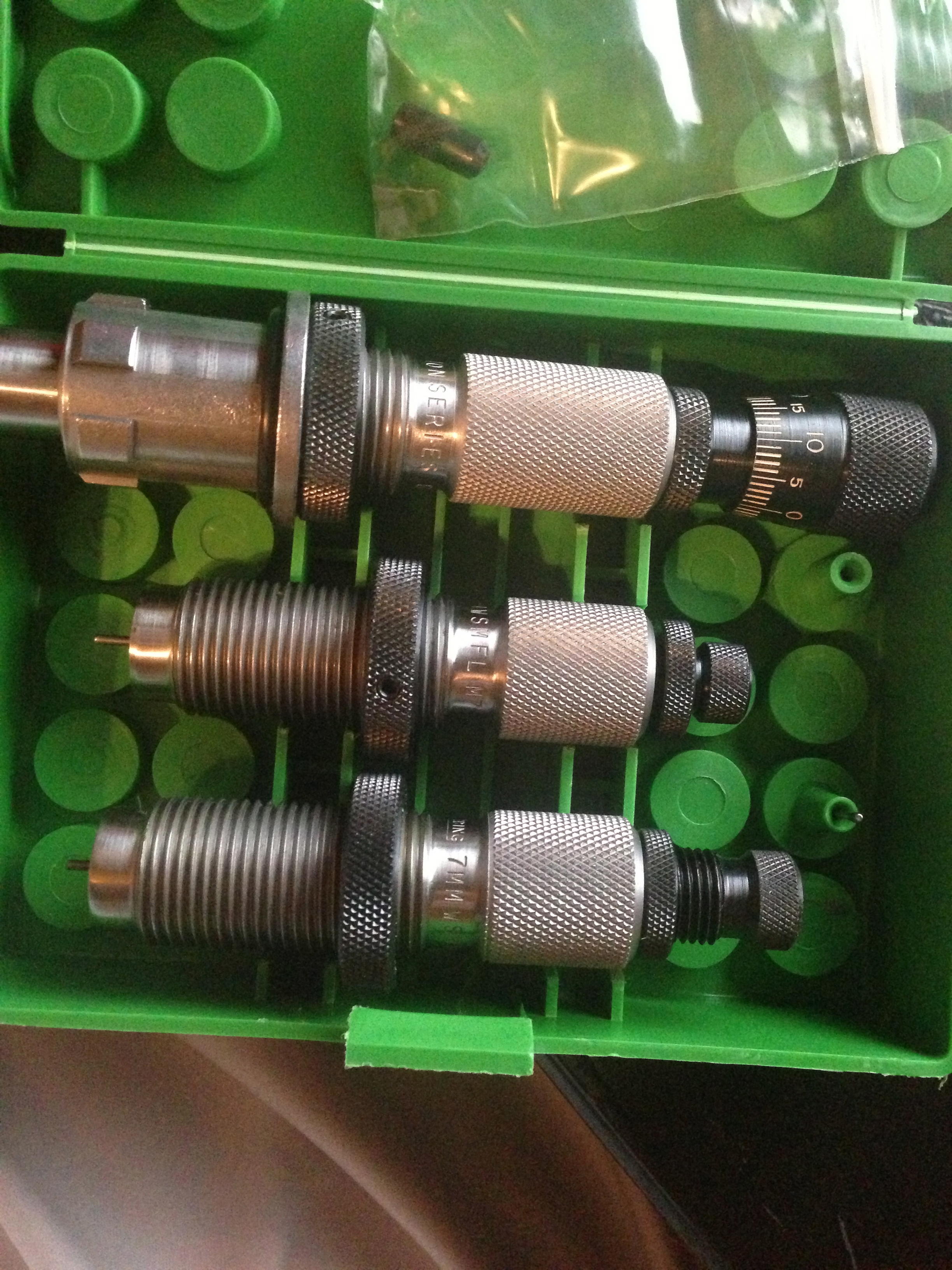

ok so this is the first time ive used redding dies. I think they may be different then the hornady rifle dies. I have a die set that has 2 FL sizing dies and a competition seater die. am I missing something that I need to reload the 7wsm. when i reload using he hornady there are only 2 dies that I use. I think I may have left something out. here are pics of what i have
The FIRST thing I do, with a "new" set of dies, is disassemble and clean them. The I check the schematics and assemble them per the specs. Bushings have an upside and a down-side! Bumping the shoulder back does NOT affect neck tension, except for the "dreaded donut". Consistent neck tension DIRECTLY affects accuracy! Please slow down, do the "homework". Read your reloading manual again. Inspect your new old dies for missing parts. The LAST thing iI'd do, is assume the used dies were OK. Don't blow your nose.............OFF!
Im pretty careful and meticulous in what I do. Ive only used the hornady dies and unfamiliar with redding. there is something different from what Ive learned on for my AR and 45ACP. Thats why I am here asking questions and doing my homework to try figure out my error. can you explain to me in my photos above what I need or if i even need something else. thanks

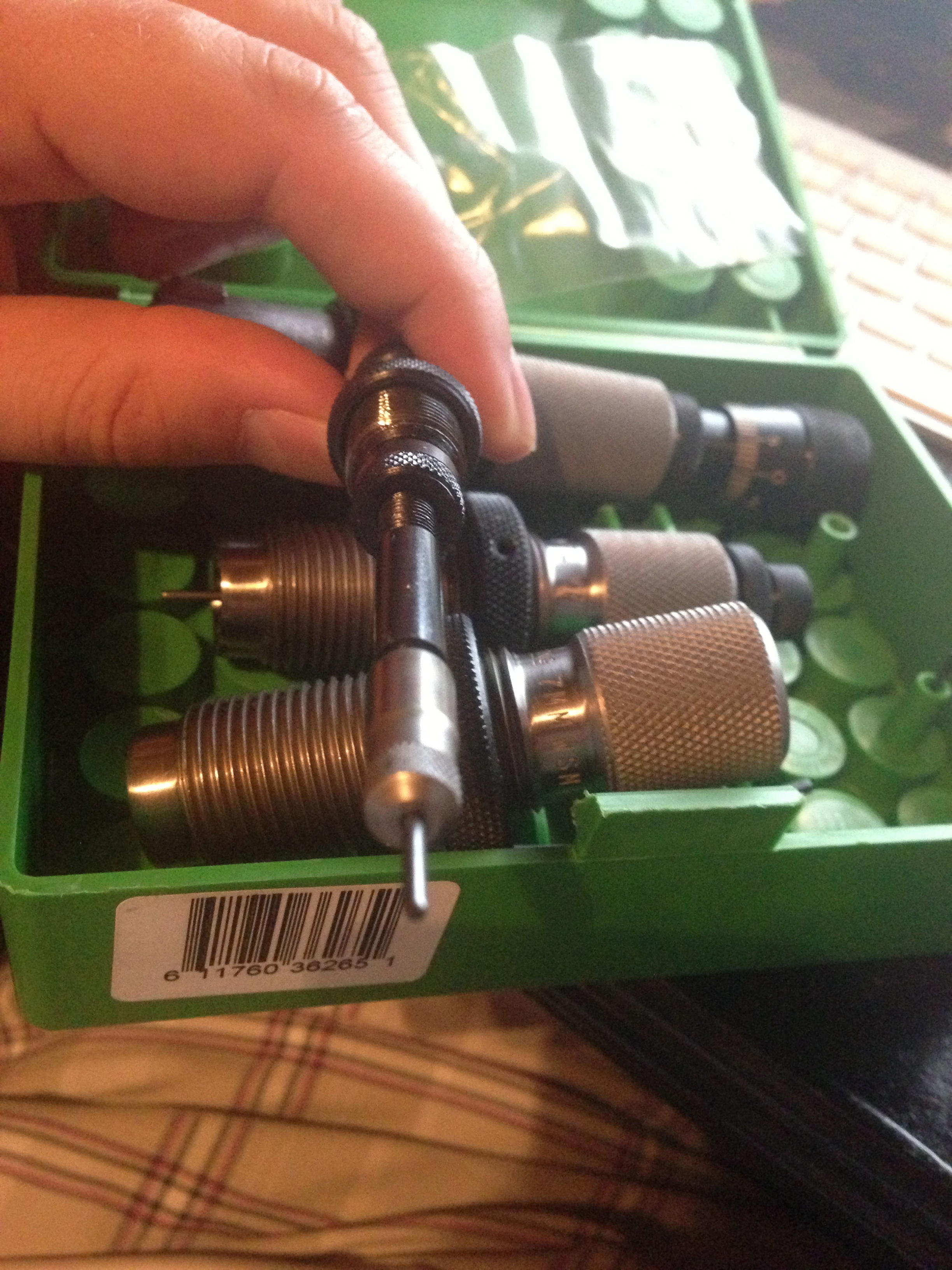

Ok. I figured out how to blow up the pic. Give me a shot of the decapping assembly, from the side. It looks like you have two decapping dies. You might have a full length die, and a neck sizing die. If that assembly came out of the neck die, I'm not seeing the bushing.
Make friends with somebody from the highpower or F-class shooters group where you live. Get him to check your setup, and make sure you do the right things. Also, check with previous owner and ask if he turned the case necks. If so, get new brass, since you will have to buy several different bushings to match the different neck thicknesses. There are potentially a lot of factors operating here, and you need to know every one of them, to minimize the expense, and make sure the loads are safe. Also, ask the previous owner if the chamber is cut to special size, such as a tighter neck than usual, which can make neck turning essential for safety and accuracy. After a round is fired, and before sizing, a bullet must be able to fall through the neck. Otherwise, the neck portion of the chamber is too tight. Partial neck sizing is generally a waste of time, and can get a live round stuck in the chamber, which definitely means a trip to the gunsmith, and could mean a new barrel.
Ok. Nice pic. It looks to me like the bushing is in the wrong place and so is the nut. But I need some time to pull up the schematics of your die, to "know" what's what. I'll try to work in the time. Just for a thought: I've been reloading, for 30 + yrs? . A month ago, I made an " assumption" , that moving a COL from 2. 96, to 2.8 wasn't a "problem", for my load. Boy, was I wrong. I went from a hot load to a dangerous load, that fast. I went back to the book, posted here, got deservedly kicked for my "rooky" mistake, and learned. Just sayin that loose neck tension, and bullets moving from COL can be a big, bad issue for you.Jim k brought up some points that are very valid. Read his post, again. I hadn't even considered them, but are spot on. Those are the "problems" with buying a used set up.
Ok. I found a picture of your die in my Sinclair catalog. Looks like the nut is on upside down on the shaft, and the bushing is gone. Could it be stuck in the die body? Get a small light, and see. Other wise, ya need a bushing. If ya don't have the papers for the die set, you should contact them, and get them. It' no wonder you're having trouble.
O/P you need to find out what you have and then go from there. If you have a set of Redding "S" bushing dies, you need to get an instruction manual and read it carefully.

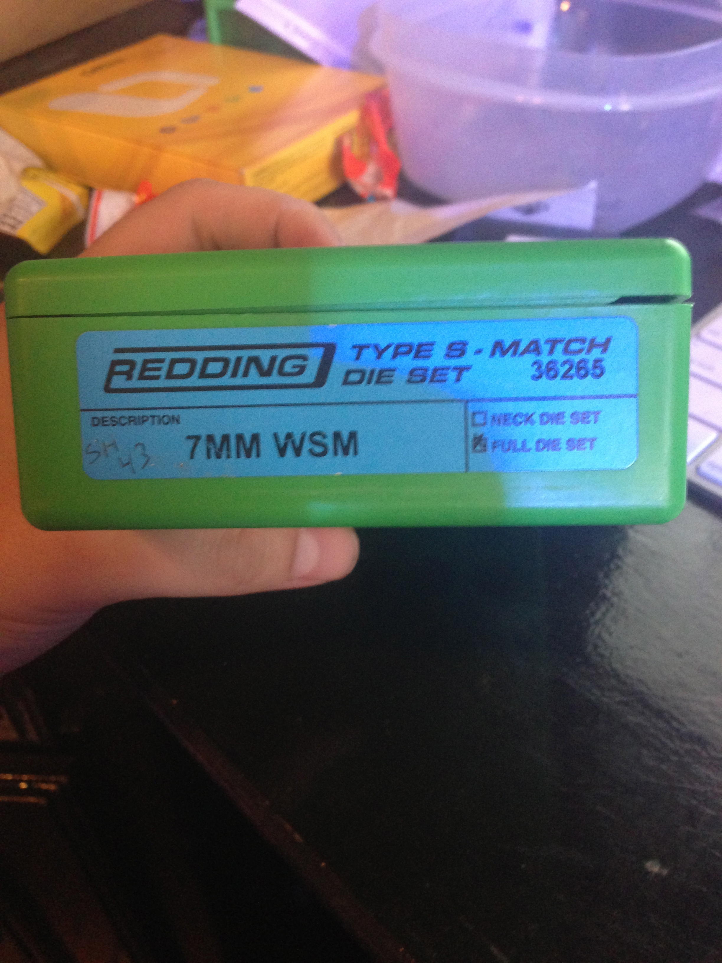

O/P look at the side of the die box and photograph it and post it here or let us know what die set you have. There will be a product code number on the box, that will tell you / us what you have.
Now, what it LOOKS like you have is a set (F/L die, Neck Only die and a micrometer seating die) of Redding "S" bushing dies. BUSHING dies are a different animal than a regular set of dies. BUSHING dies require you to purchase separately a bushing in a certain size to properly size the necks of your brass. Bushing dies also give you the option of using or NOT using an expander ball / button. I don't use the expander ball / button when using my "S" bushing dies.

Your die set #36365 : Redding Type S Match Bushing 2-Die Set 7mm Winchester Short Mag (WSM)
Originally is a two die set, a F/L "S" bushing die and a Micrometer seating die. Your third die must have been purchased separately. You will have to look on the body of the dies to see what is the third die.
