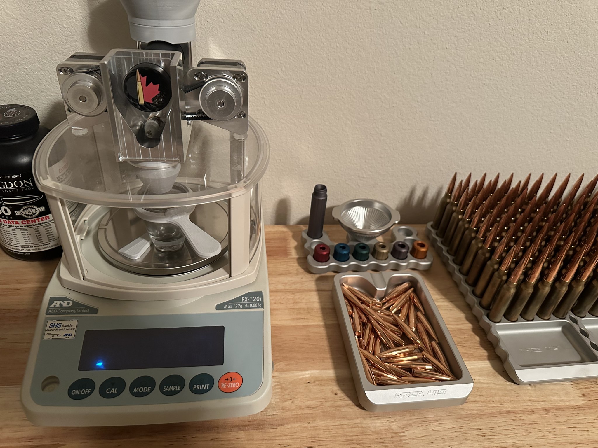

The red $4 Lee funnel, or if your an asshole that set from A419 that costs two hundred dollars
It is really nice tho
