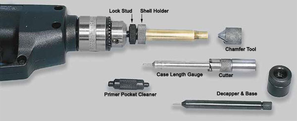

The lee hand trimmers have an adaptor to put it in a drill. It’s not three way and takes three times as long but drill mounted is still much better than pure elbow grease.

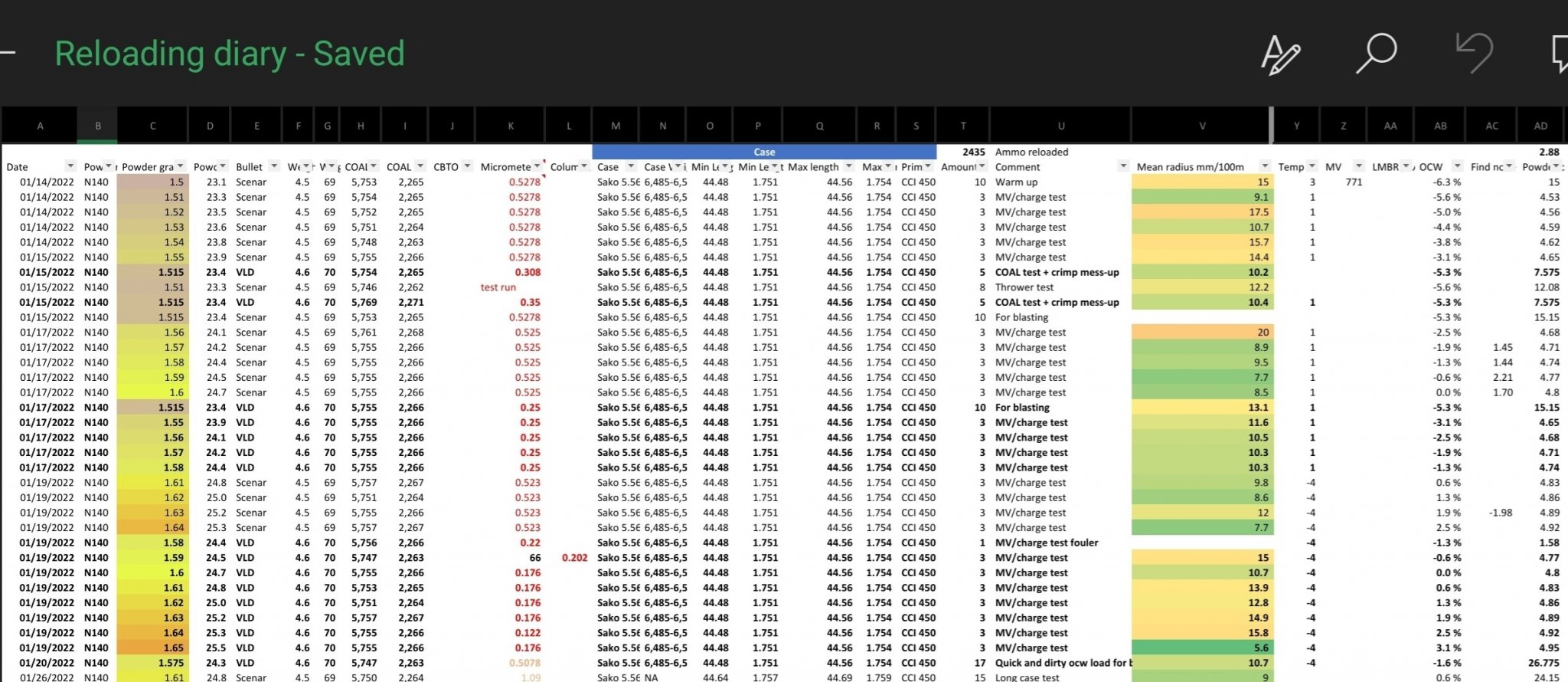

I have to confess I never read any reloading book, but I was already quite well acquainted with reloading through friends. And youtube videos, I watched a ton of youtube videos and they teach so much more than a reloading book. I later on read one from Hornady and was a bit disappointed in the information provided. The nomenclature and technicals were explained very well though.
You do need to save recipes in pen/paper or digitally on excel sheet.
Similar to this:
I can ofc share mine as baselayer if you want it

I found those to be wobbly and I have not used them since. The hand tool can do thousands of cases over a few nights after work, so I've just never seen the need for a powered trimmer.
I do have every tool in that picture though, besides what they are calling the "decapper and base" and recommend all of them besides the "lock stud."
