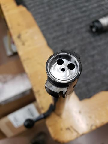

Long story but I need help and advice.... So April 13th I shot a match with my semi custom 700. I was having several FTE problems with it most of the time I had to pull the mag out and finger bang the action to get the fired case out. On April 16th I took it to a local business ( I'm not going to name) to get it fixed. They ordered spring stock and couldn't get it to work 100%. They sent the bolt to the main shop in a different state when I decided to get a M16 extractor put in. The machinist won't prrform the work because of the cut from the sako style that's already there. The guy I spoke with says to get a new bolt with the M16 already installed but I'll have to get my barrel head spaced to the bolt. I don't want to take my barrel off so that's not really a option but if last resort will be. So main question is what would be good fix for my problem?Obviously you haven't seen the bolt and extractor so it's hard to say. Also with the Rem 700 bolt being 3 pieces would a M16 extractor have negative effects when considering strengh? The business that has my rifle has never once called me but I have called several times for updates. I would have thought that when the machinist decided he wouldn't preform the work that they'd call me to discuss what options I have they never called me I called them today to find out this information. They've had my rifle for nearly 2 months and nothing has been done to fix the problem. I'm getting fed up and wanting to pick it up weather it's finished or not and use a different smith. What are your thoughts on what to do with a sako style extractor? Different detent and spring? Pour lead in the hole to "fix" it? At this point I just want it to work and for me to shoot the damn thing.

Sako and Mini M16 extractors are guaranteed to make your ejection angle too high which usually ends up getting your case bouncing off the scope, etc. and back into the port. Reason is that the factory ejector is positioned to push the case off of the bolt and out of the action with the extractor tooth in line with the right lug. The Sako/M16 have to get above that lug and the changed relation to the ejector sends the case where you don't want it.
Most aftermarket bolts that come with the larger extractors have already changed the location of the ejector to keep everything flying where it should.

We'd be happy to help. You'll need to send in the barreled action. Best case: I can repair/rework what you have and get you up and running. Were looking at 1-14 days. All depends on just how "murdered" what you have actually is.
Worst case, I have to replace your bolt with a new one. This is also not an issue as I have them in stock, OEM originals.
The tool packages and machine resources I have here make either solution pretty straight forward. The last part of this is you'll deal with me and me alone (meaning my business) from here out. There won't be blaming someone else if it doesn't meet expectation or whatever. If I take on the work, I own it from then on.

I do not care for Sako type extractors in a 180* twin lug bolt gun at all. They work just fine. This issue at hand is if you have a woops and sneeze a case. The Sako is retained by nothing other than a spring and some clever mechanical interaction. That said, there's no pin or under hook that will prevent it from ejaculating itself from the breech should a case ever violently fail. If you have one of these, roll the bolt into battery once and look closely at the ejection side of the raceway feature. The extractor has an almost line of sight avenue for escape. With 40-60 thousand pounds of horsepower behind it, count on it flying out of there. Violently. . . I know of two people that had emergency eye surgery for this exact reason.
Another side note on this. Because the reset spring is captured in a hole that runs parallel to the bolt body axis, one has to be VERY careful when having some additional work like bolt fluting. The wall thickness from the outer edge of the hole to the outer circumference of the bolt body is very thin. A cavalier attitude will result in penetrating this hole, ventilating the bolt, and ruining it.
Not cool.
By contrast. The M16 is retained by a solid pin. With proper heat treat, the extractor won't shatter, but yield (bend) under this kind of stress. The pin contains the "bomb" so that it has a standing chance of staying inside the breech. It may ruin the gun, but guns can be replaced. Eyeballs and face parts cannot.
Typically, these are both bells that cannot be unrung. Once you stab a Sako, the bolt won't accept an M16. The opposite is also true.
Edit #2:
The ejection angle issue. It's been solved. OEM bolts can now be modified to run to expectation. We've been at this a long time now and have done several hundred. It involves a 2nd ejector. Trim a couple coils off the spring so its not too hard to close, and your set...
