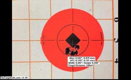

Hi, I recently got back into shooting after about 15 years (haven't really been shooting since I left the Marines). I have a 26" Rem Varmint that I put in a B&C A5 Stock with a Millet 4-16 Mildot scope. My question is, how accurate should I expect this rifle to be? I can (almost) consistently shoot .5 MOA 5 shot groups at 100 yards with it off bipod with a bag in the rear on a bench. I'm not handloading, but have found that Hornady Vmax 55gr and American Eagle Varmint tipped 50 gr seem to work well in it. I assume that some of my 'flyers' are shooter error, but sometimes I know I did my part and the group just opens up. Is .5 a realistic expectation for this rifle with factory ammo? Would it tighten up if I DID hand load? Tomorrow I'm going to take it out and try 200 and 300 yards with it. I also have a 20" 1:9 but that's another thread :D Thanks for any input you guys have about what to expect.

Looks to be shooting pretty damn good.
You could probably expect between .5 to .75 MOA with that rifle and good ammo.

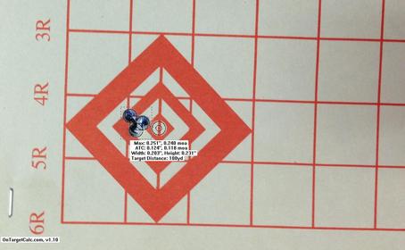

Surprisingly, to me at least, the 20" 1:9 shot this group at 300 with Black hills 69 grain MKBT. Apparently my rifle likes this load. It was my best group, not my average. The top round was the first one after cleaning the barrel, and the first I shot of this load. I adjusted down 1 click from that round, and the following five rounds comprise that group. Almost 1/4 minute. First group with that load. The rest weren't that good, I got lazy and stopped cleaning the bore in between groups... Still, it's easily .75 anyway. I'm stoked!

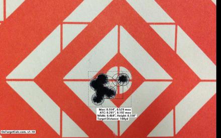

But my real question is about Parallax and POI... Attached is an image of a five shot group that appears to be two different groups. The POI is different. Many of my groups look this way. Sometimes I can feel my cheek sliding on the cheekpiece, other times I readjust and rebuild my position and sight picture. Though they all fall under .83MOA in this image, it's obvious to me that either:
A: My parallax is off despite my best efforts to get it dialled in and shifts when I rebuild and an slightly off...
or
B: The ammo just does this because it's not match ammo...
I called all these shots dead center, bottom of natural respiratory cycle, smooth trigger squeeze....
Suggestions and instruction welcomed. If I could get these to group this way it would be sub-1/4MOA for five shot groups...

Finally, In anyone's opinion, is this a parallax issue above or is it just the ammo?
Running what you have with that attitude is a very good place to be.
To answer your 'final' question, easiest to get a good driver behind your rifle. Compare notes. Many variables and lessons from bullets down range.
