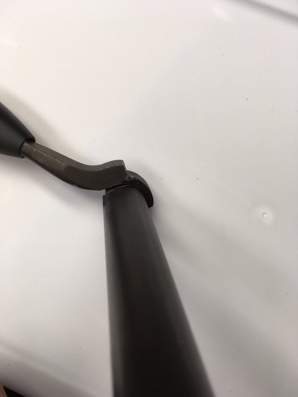

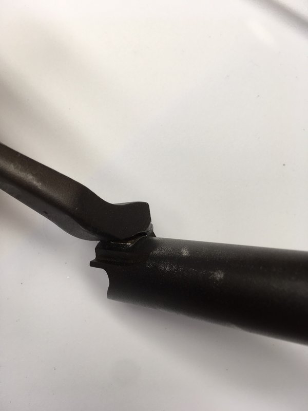

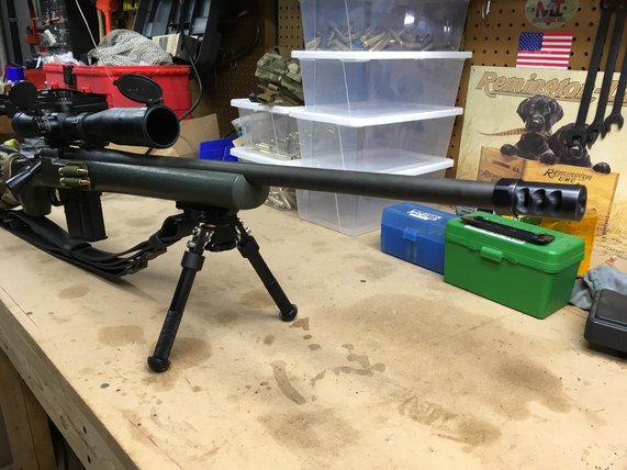

Just noticed the Bolt handle on my 1992 Rem 700P PSS is bent outward and partially cracked. Who should I send this too for repair?
https://www.longriflesinc.com/collec...rvice-for-m700
I can have this in/out in a couple days. If you send us the barreled action, we'll set the PE correctly as well.
FWIW:
Since the GB we started in 2013, LRI has welded/soldered somewhere around 3000 bolts. You learn some stuff with that kind of volume.
There's a lot more to this service than just sticking a handle onto a bolt body with enough weld to make it "correctly." For instance, if your action has an RR prefix in the serial number, I can promise the Primary Extraction (PE) is about as wrong as wrong gets. Someone at Remington really goofed. They made a foundry change and the investment casting molds are not right. I don't profess to know why or how, but it is the reality were faced with. You can simulate this very easily by cycling the bolt and observing the relationship between the handle and receiver cams. What you'll notice that there really isn't one beyond it acting as a stop for the rotation. -the end of the "strap" portion of the handle is what is supposed to do this when it contacts the raceway opposite the ejection port.
The cam surface needs to be welded up to advance the timing and make the cam surface able to be machined so that it is tangent to the action. That is step one. The fixtures to do this do not exist. They have to be made from scratch. -something I did about 6x years ago. It is possible to fit the handle "to a number" or distance from lug abutment to the handle slot feature on the action. Remington does a reasonably decent job of controlling this on the actions, however the cam timing is something that IMO must be fitted on an individual level in order to get it truly correct.
I used to weld all of these myself. I'm a self taught TIG welder. I have a well vetted, professionally trained welder on my staff now. He's forgotten more about it than I'll ever know and his eyeballs are half my age... so that torch got passed.
In addition to the welding service we also offer a full menu of options and means of finishing. One stop shopping being the ambition.
In the 8 years I've been in business for myself I've had 2 bolts returned for a problem with this service. Both instances were totally my fault.
Happy to help and like I said; In/out in a couple days.
C.
Talk about Irony... I was excited to try my new Brake and the rds I reload (Both were awesome by the way.) I had to re zero after reinstalling everything.. (Only off 1" in elevation)
So I run 27 rds of various loads thru the gun at the 100 yd range... satisfied... I pack up and drive next door to the 600 yd range where I want to take a poke at the steel at 567 yds...
I get all set up...
Load my first 5 rds....
Insert the magazine....
reach up to close the bolt.....
Handle comes off the bolt and is in my hand.....
I'm done for the day.... that was a sign...
Got you email Chad... I'll be packing up the bolt.. the handle and the action and shipping it off to you tomorrow...

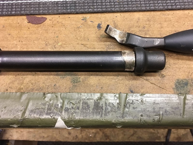

Had to update and give a shout out to Chad and LRI... got my bolt back this morning (Sitting on the porch, with the dog, having coffee... waiting for the mailman....)
The work looks great.. should last me a lifetime (And the future grand kids as well).
I'll hit it up with some high temp Engine block black and off to the range to zero.... (He offered to coat it, but I'm a cheap ass....)
I swear to God... I won't spent any more money on this rifle.....;)
Thanks again Chad for the work and quick turn time.... your the man....

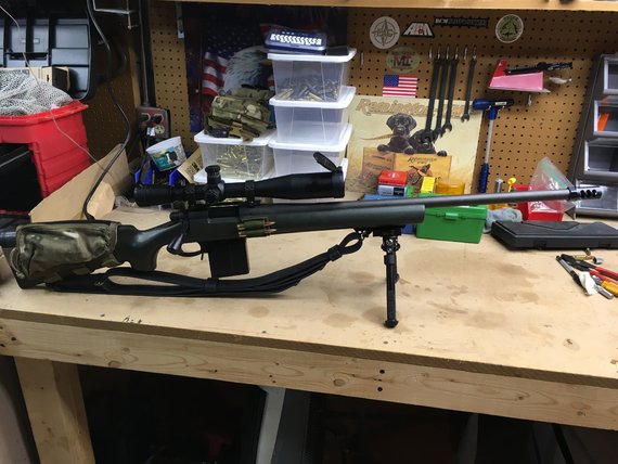

All put back together.. The bolt was de-greased and painted with hi temp grill/engine paint...then sat in a 450 F degree grill (How ironic) for about an hour... looks great...
