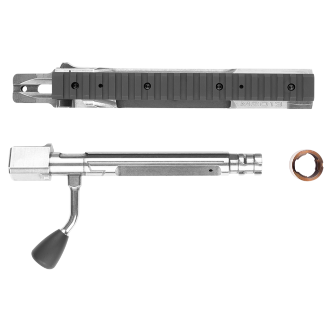

    the Badger M2013 and the GAP tempest do not have a 3rd ring it's called a breeching ring and does not have to be machined off or can't be machined off due to the locking lugs lock in to the ring.

    you mean machine the bolt nose section off of a barrel made for a remington if you are going to go that far you could have a prefit barrel made for a GAP Tempest or Badger M2013.

    The tempest and 2013(and the AI) have a breech ring inside the action. Its a removable ring which incorporates the receiver lugs. The rear of the barrel is supposed to pinch it in place. In other words, the barrel would shoulder on the action face, and the nose of the barrel would shoulder on the breech ring simultaneously. So while a prefit barrel is possible, it would need to be head spaced during machining. The user would not be able to headspace the barrel.

    Got it. Could you, in theory, remove the breeching ring in order for the user to headspace the barrel like a standard barrel nut system? Just wondering if it would even be possible or if there would be any potential negative implications from doing so.
    My understanding is that the ring is there to help direct gases elsewhere if a case fails during firing. If safety is sacrificed in any way, I'm out.

    No, the breech ring IS what the bolt lugs butt against. The bolt lugs would be floating in space without it. The ring allows the use of a disimilar metal to the receiver body and bolt, and to allow for replacement of the receiver lugs for wear. For a mental picture, machine the lug abutments out of a remington receiver to a point midway down the feedramp. That is what it would look like with out the breech ring.

    The ring by the bolt in the picture is the breeching ring for a Badger M2013 action.
    Thank you for the explanation. You've confirmed my initial hunch, that this would be more hassle than it's worth.
