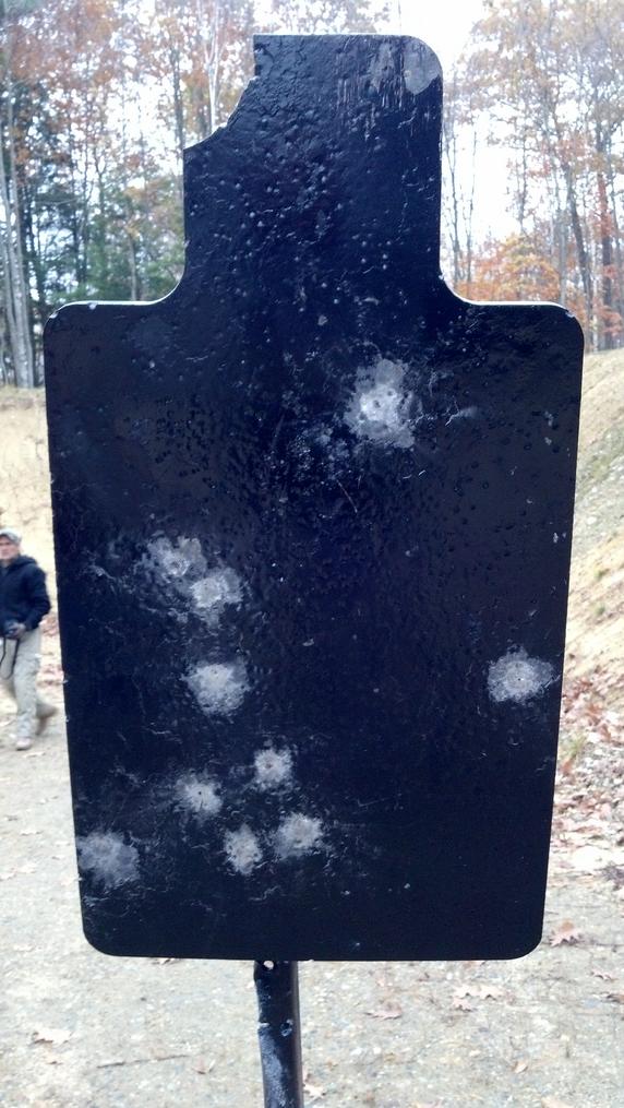

I recently got on a 1000m range
we shot 100, 200, 300, 800, 1000
my 100 was about 3/4 inch
my 200/300 was about 4 inch
my 800 and 1000 was basically all torso shots on an iron maiden. I was really pleasantly surprised.
It seems to me that maybe I have a bullet stabilization issue.
If that spread from 100 to 200 continued out to 1K, I wouldn't have ever hit the maiden. I think I hit it 10-12 consecutive times.
at sub 1000 I shot 190 smk over 72.5 rl22
at 1000 I shot 208 amax over 70.5 rl22
Does this seem to make sense? Or should I still be driving tacks at the shorter ranges?

I don't understand how this may not be a stabilization issue.
If every time I shoot, I'm about .2 mil at 100
and
1 mil at 200
Then why wouldn't I expect to see that same growth in error at longer range?
1 mil off at 200 would imply about 1*5 = 5 mil off at 1000 would it not?

I have a nightforce atacr mil (second focal plane) at full (calibrated) zoom of 25 my group at 200m looked to be about a full mil (10cm)
At a range 5x that, wouldn't my error (still 1 mil) be about 10cm x5 = 50cm (almost 20 inches)
On my grouping at 200m its always about 4 inches.
At my home range, at the class I took.... regardless of ammo.
At that rate of sucking, wouldn't I be so far off at 1000 that I'd never hit an standard iron maiden?
That was the point I was trying to make. at 1000m, I hit like 10-12 consecutive times.

The maiden is the 12" x 20" version
attached is a pic of 1 of the maidens
