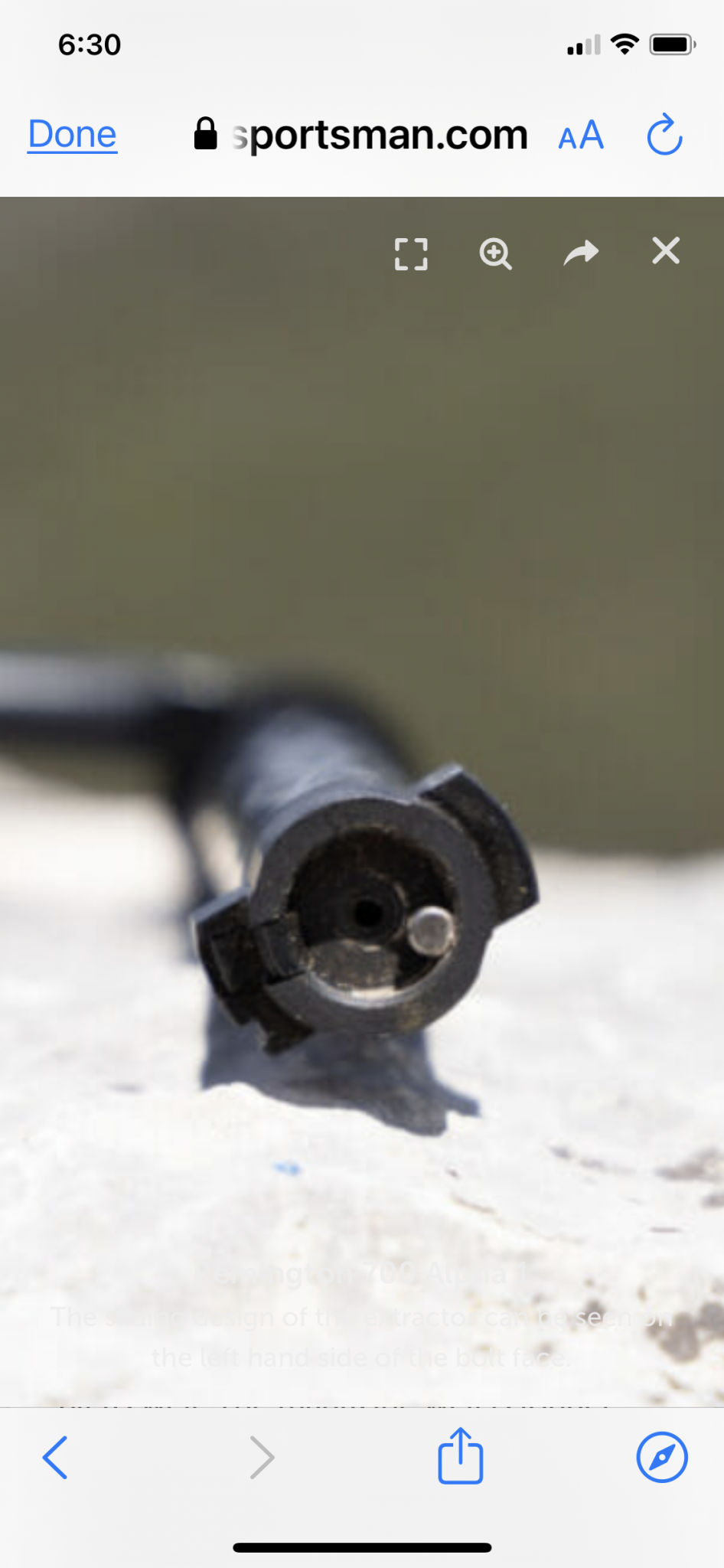

Looks like the made some meaningful upgrades. That being said why use a savage extractor. Literally every clone is running some variation of a mini16 extractor. Big mistake IMO.
We'll see how it performs. I've never used that type of extractor, but the ejection angle on the m16 type can be a little high and hit the scope. The lug mounted extractor will eject with less of an angle, and if it works well, I think it's a good thing.
With a properly placed ejector on most clones ejection is a non issue. There’s literally tons of threads on poor savage extraction. I have worked on enough of them to no want anything to do with it. That being said if they run the standard 700 ejector it may help the design, not drop cases half way out.
