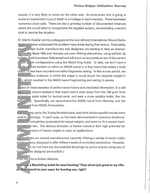

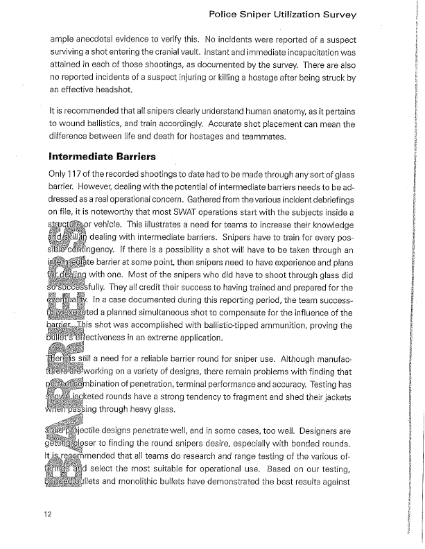

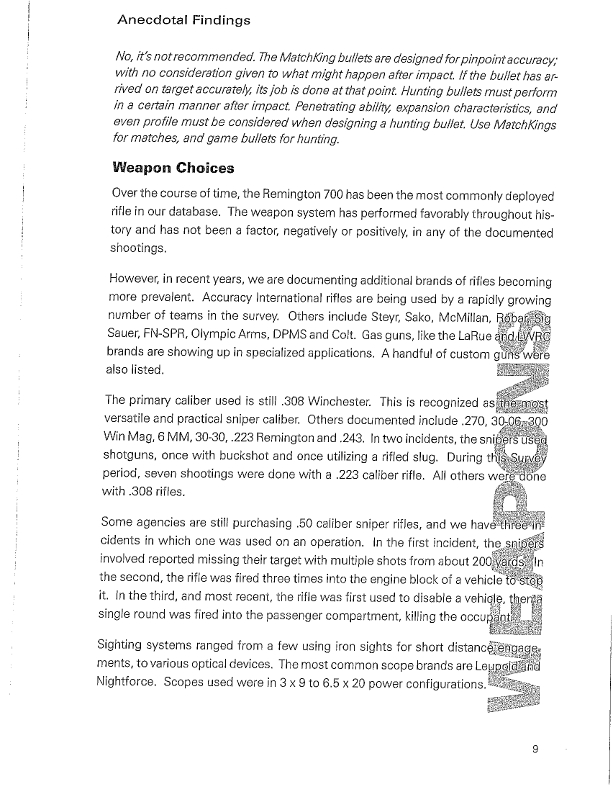

Respectfully, that ASA summary has me scratching my head.
117 of 446 shootings were through a barrier, typically glass. As far as I know, no sniper team in the country dedicates 25% of their practice or exercise rounds through intermediate barriers (plywood, siding, sheetrock, backyard fence, chain-link, Lexan-plexiglass, or glass) -- yet the ASA training recommendation has no barrier-defeat shooting.
Their ammo recommendations contradict. Their Ballistic Tip over BTHP recommendation goes against intermediate barrier penetration -- A-Maxes and Ballistic Tips go all kind of frangible on contact with hard barriers. On the other hand they recommend using bonded bullets while arguing against penetration and ricochet.
An average engagement range of 57 yards over 30 years with a number of first-shot misses, non-lethal body hits, and 24% bad guy survival tell me we need a lot of work.
I agree that most sniper training is done on nice, clean, flat ranges off a bipod and shooting mat or shooting table.

I find it strange that le still has death grip on the 308 and some of the standard bullets.
I do not hate le, the 308 or the 168gr, but improvements can be made.

Respectfully, that ASA summary has me scratching my head with a lot of "WTF?"
Gotta love the wacky world of LE Snipers Col.! I am throwing this out for "general consumption" as I am sure this is not news to you Sir.
Barriers - pretty much no one does any barrier shooting outside of an initial training class (if they do it then) .
ASA actually has some decent materials on Barrier Shooting:
http://www.americansniper.org/new_page_6.htm
ASA does have Barrier Training in the classroom portion of the annual training matrix, but not the practical skills. From my understanding it was not put in the practical skills due a combination of factors (logistics, practicality, etc). My first "attempted" LE Sniper Engagement was through a residential glass window with a SMK bullet, and it was a complete FAILURE! Fortunately the Entry Team was able to eliminate the threat. LESSON LEARNED THE HARD WAY, which is why I am very passionate about educating others, because everything I had learned and done up to that point was a FAILURE when needed.
Ammo/Bullet - the "Perfect LE Sniper Round" does NOT exist.
"Open Air" Round - the Ballistic Tips are an improvement over the SMK for over-penetration, but just barely. The best "Open Air" option would be some form of a round with a truly frangible bullet. Issue 1 - frangible bullets can suck when it comes to consistent Sub MOA performance. Issue 2 - they are practically nonexistent in .30 cal loaded ammo. Barnes has some good frangible bullets, but NO loaded .30 cal factory ammo. There are some "boutique companies" offering loading frangible rounds, but ammo like that can be a huge liability for LE Snipers.
Barrier Round - per your comments, you must have a dedicated barrier round. Good News, there is no shortage of quality loaded ammo options. Bad News, using 2 different rounds means dealing with a different Zero and DOPE.
We recently started shooting some RUAG ammo, http://www.ruagswissp.com/products/overview/ .
Both the "Open Air" and Barrier rounds are great stuff, but it is very hard to find in the US, and it is also very expensive. https://www.milehighshooting.com/am...ured&brand=219&category=85&is_category_page=1
I can probably count on both of my hands the number of teams that I know who truly have a fully developed capability when it comes to Open Air and Barrier capabilities.
Real World Shooting - per the stats, most training programs, and follow on training, honestly SUCKS when it comes to producing high quality repeatable results in the real world. Per the stats, few real world shots come from a bipod in the prone position at a stationary target, but that is how most snipers train. The stats are a damning grade in terms of real world performance, but little is honestly being done to correct it, which is once again why I am here trying to post info to hopefully change that.
As much as I hate to say it, the LE Sniper Community has a LONG ROAD ahead of it. The potential is there to make some really great strides, but it is going to take some real dedicated individuals, because everything associated with a LE Sniper is probably not understood by most administrators and they are probably at the bottom of every priority list. Probably not much different for most MIL Snipers IMHO!
I am going to keep trying to do my part, thanks to everyone else for your efforts!
