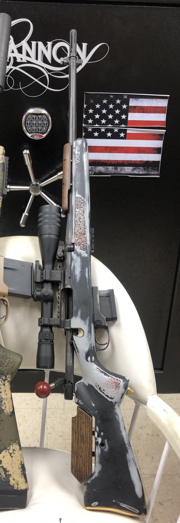

what a masterpiece! I can see myself bringing something like that to an F-Class competition and shoot with pride. I think what i like most is the M-14 flash hider. I used to shoot the M-14 competitively in the USMC and that is my dream gun. I wish i could find a real one.

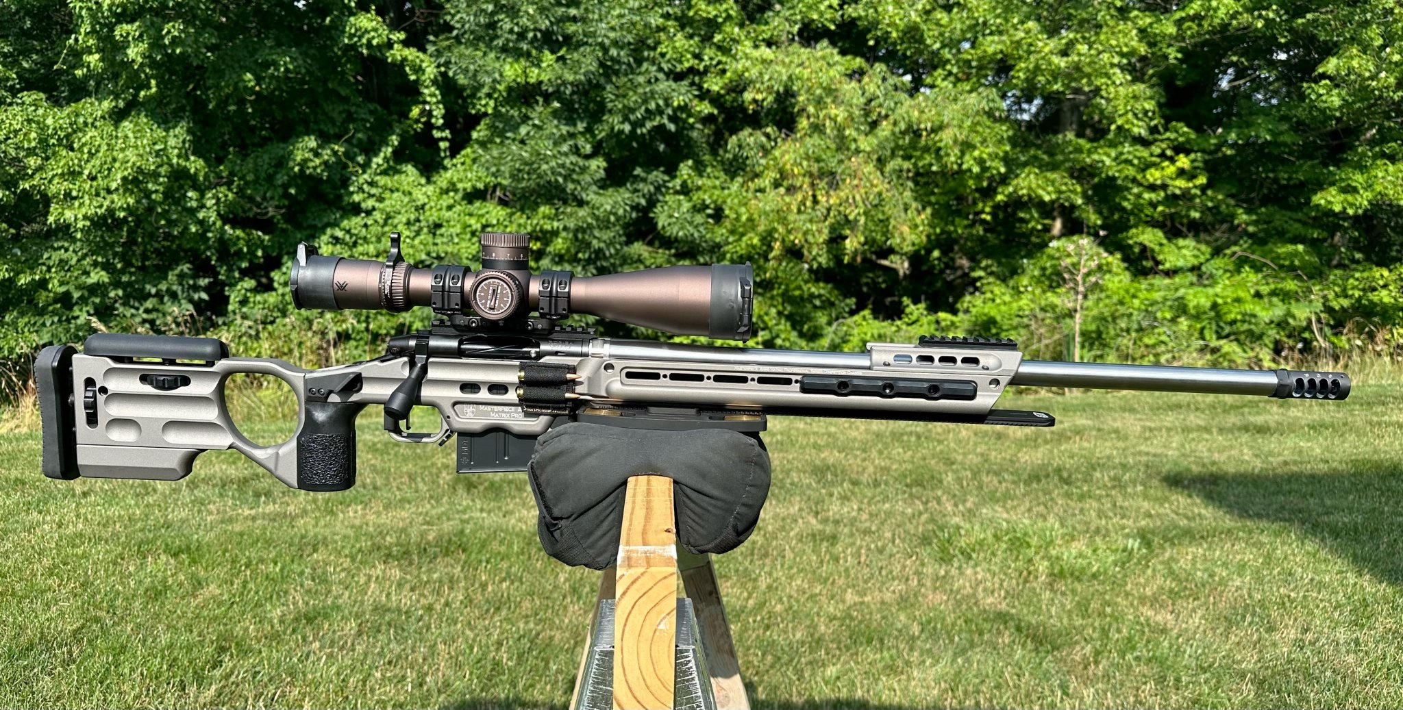

For inspiration, here are a couple pics of my .223 Wylde non-shouldered build on an Origin. First shots through the rifle with zero load development. You don't have to go shouldered, a nut style allows you the option to fine tune headspace if needed.

Rob01 posted his reply while I was still typing mine. I agree with him - why screw around with trying to find a Rem bolt that will fit a M700 action when you can buy an Origin action & prefit bbl? I've been truing Rem actions and fitting/chambering barrels since 2005. They shot good enough to satisfy myself and customers, but after watching Nesika Chad's you tube video showing his set-up in a 5 axis machine doing a complete action truing job, I decided I'd like to send LRI a new RR-prefix bare action & PTG custom bolt and have them do all the work, including fitting the new bolt, diamond honing the bolt bore of the action for correct fit after CeraKote application, and just for shits & grins, having them flute the bolt body.
This originally came about because I'd bought the bare action & ordered the custom PTG bolt just before Remington went tits-up, then sat around trying to figure out what I wanted to do with it until all the factory parts (like bolt stop & spring) had sold out. I read about LRI's custom side-mounted bolt stop, and decided to send it up to them to have that installed - then got lazy/curious enough to have them do all the truing & bolt fitting, plus do the bolt stop install. As pleased as I was with LRI's work and how fast the turn-around on it was - and even with my dealer's discount - I could've bought an Origin action for what I've got in what now is certainly a premium M700 action. No regrets on my part, because when I examined the work that LRI did, I was super impressed. And after I'd applied Armour Black CeraKote, the new bolt runs very well in that action. The guys at LRI are top flite in my opinion, which is not news to any of the members here who've had work done by them. And after I'd fitted and chambered the 1-9tw Bartlein in 20 Tactical, it's a hammer.

You don't need a shouldered barrel but it makes life a lot easier by being able to just screw it on and not have to worry about a nut or go/no go gauges. No need to adjust headspace.
That's 5 shots at 100 with 75 ELDs and Varget in a short load work up. Have shot it to 1150 yards in matches. That's a PVA prefit screwed on a Bighorn TL3. The rifle was a 6.5 Creedmoor and I just swapped the boltface and barrel.
This is it during testing but in a different stock and scope now.
Can’t take credit for the build, the mad scientist has responsible has quite a few unique builds under his belt

My first inclination is to go with a shouldered pre-fit but now I am contemplating a combination of both, just to learn and experiment. Yea, it would probably cost a little more but not enough to deter me.
Over the past year i have evolved from being just an AR guy and now with a 6.5 Creed (impact precision SA & 26" bartlein) and a 300 PRC build ( Rukus LA and 30" bartlein though the 300PRC barrel is not together yet as the barrel hasnt arrived yet and is due in late Oct - Early Nov). For each of these, I have been totally dependent on a gunsmith to get me up and running. I have been lucky with a couple of outstanding gunsmiths but eager to do what i want without that need.
Based on the feedback here, I started looking into the Zermat Arms solution mentioned above and put together the following wish list:
  • Origin SA - Beadblast with .223 bolt head, 20MOA rail, tactical bolt knob
  • Shouldered pre-fit stainless barrel, 26”, 22 cal (.223 Wilde), bull, 1:7, muzzle thread, bead blast
  • - with stainless thread protector 5/8x24
  • Shouldered pre-fit stainless barrel, 20”, 30 cal (300 blackout), MTU, 1:12, muzzle thread, bead blast
  • MDT ACC Chassis
  • Trigger Tech Diamond
I reached out to Northland Shooter Supply and they recommended .223 remington instead of Wilde and agreed with 1:7 twist. They recommended an 1:7 or 1:8 for the 300 blackout.
I was not originally interested in a 300 Blackout but i have friends who love that cartridge and figured if all i need is an extra barrel and i can easily shoot both... why not.
NSS also sells the Rems barrels and everything else needed to mount them.
Again, it is more than i was initially planning to do but between all the inspiration of this thread and the NSS site... i am getting more hooked.
I am not totally sold on the MDT chassis yet. Both of my other builds have Foundation Genesis stocks and i really love them. Just thinking about something a little different for this build.
