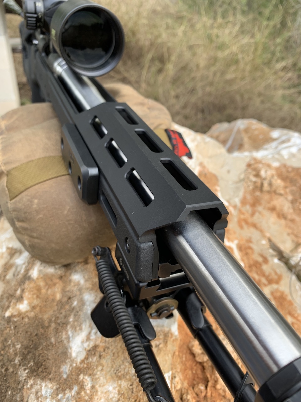

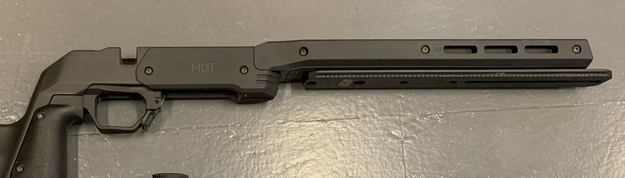

As for the XRS, its forend is longer than the Bravo (i think) but i am not sure if I can mount a 10" mlok Arca rail and push it out beyond the XRS forend and, if so, how far.
bravo has a 9" foreend, xrs is 12"
I put a 12" universal 419 rail on my xrs, it has to slide forward a smidge to get the last rail hole past the fore end mounting and into an mlock slot but it worked fine.
Ive since gone to the xrs enclosed fore end which has an integrated arca, which is only like 50 bucks more than the 419 rail so I did that and moved the 419 rail to a different stock.
