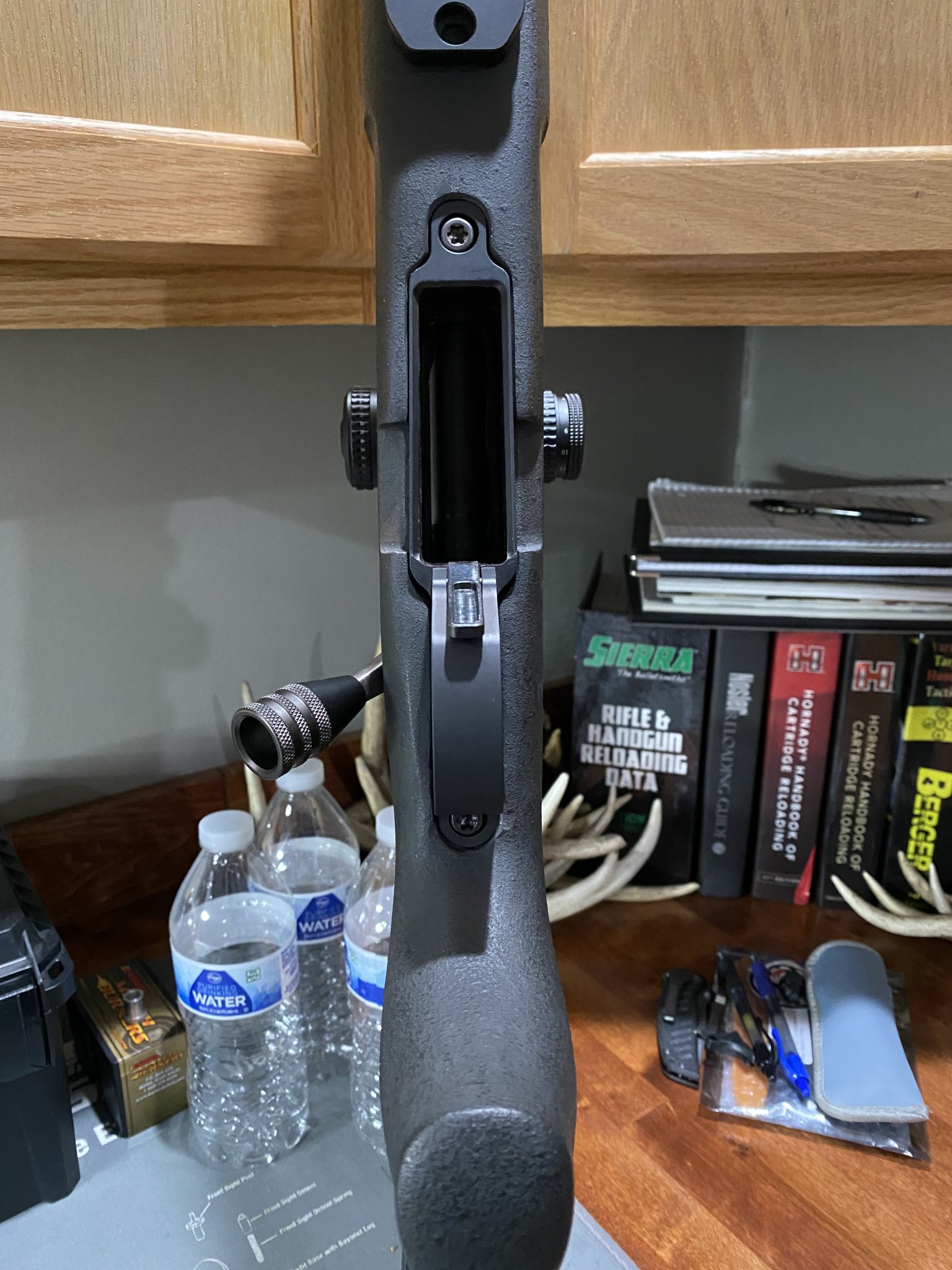

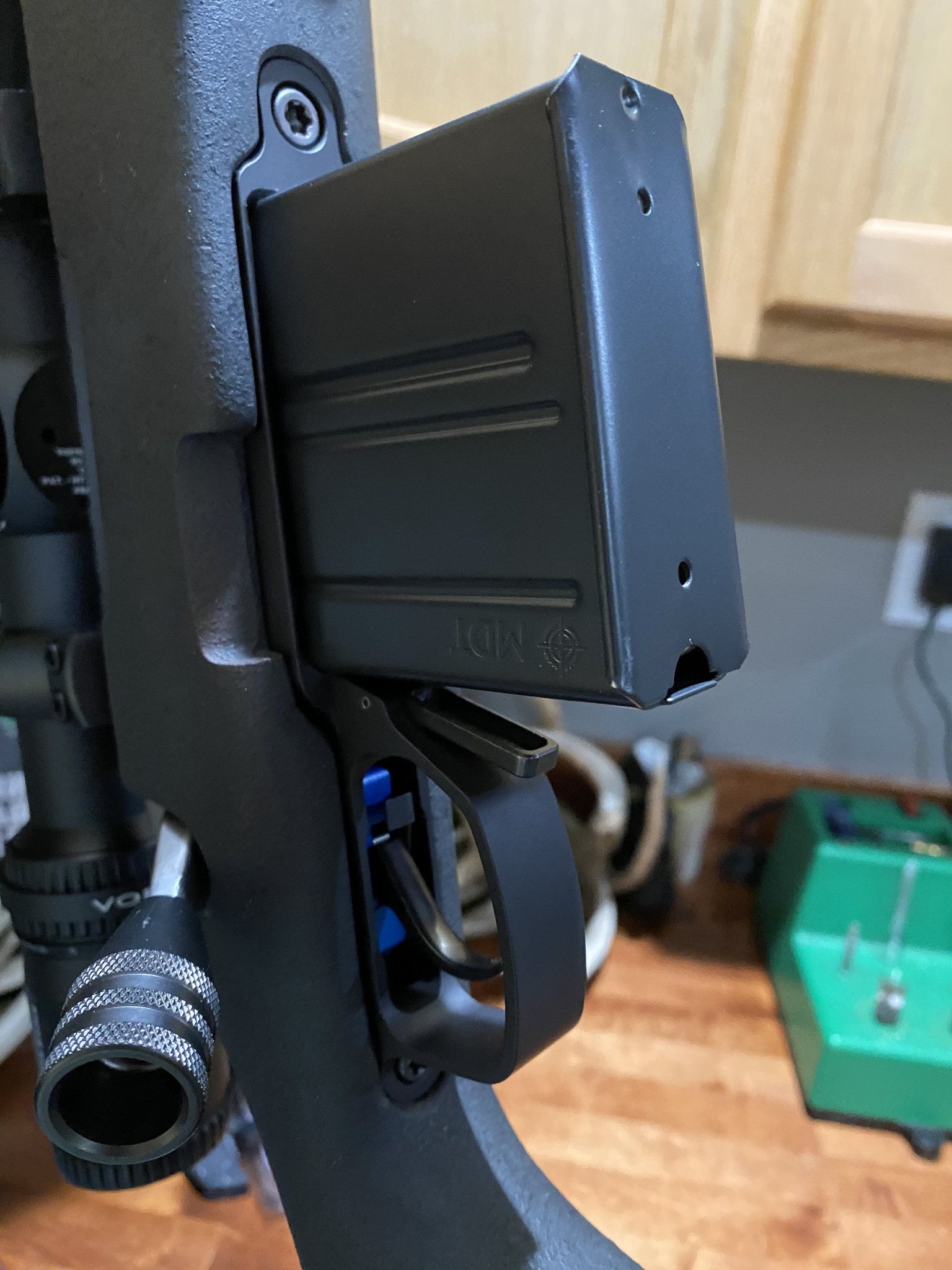

Without hesitation I can say that I don't like rifle chassis.

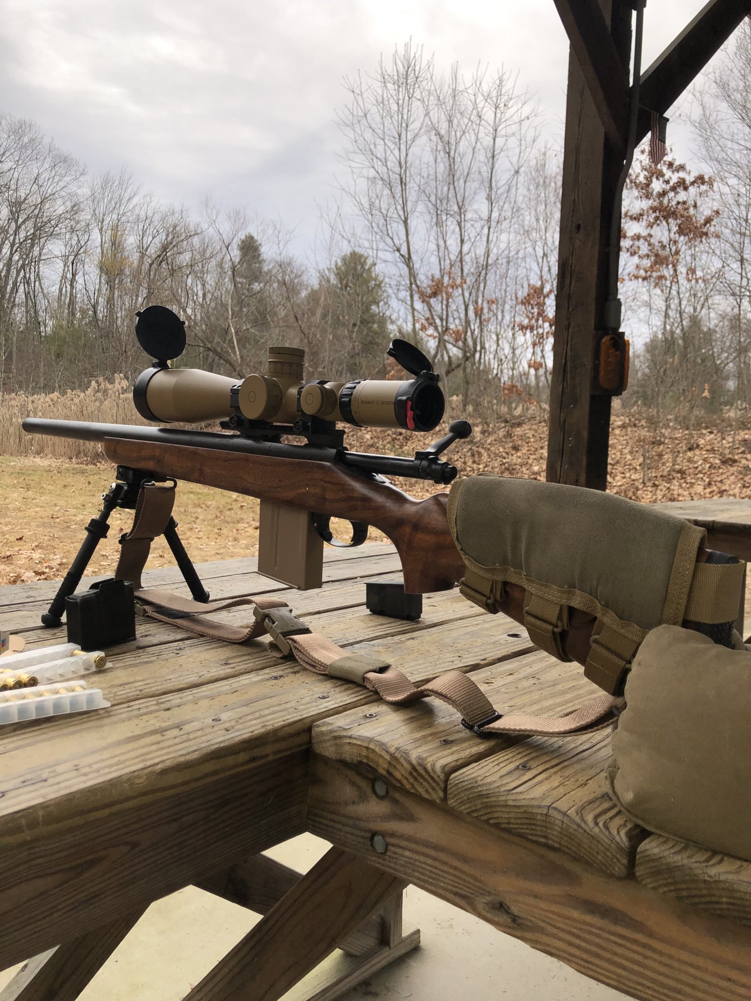

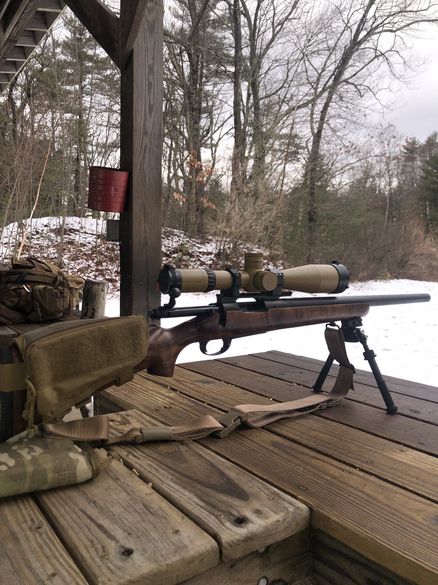

Few pictures of it complete.
