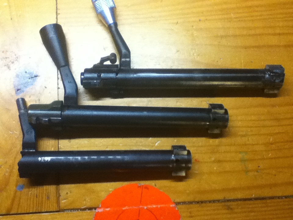

    I cannot help with the size of the bolt but these three are cerakoted. The center bolt has close to 1000 rounds the other two have around 400. They do show some wear with use but is my preferred coating. Strange that the bolt with the most use is showing the least amount of wear.
