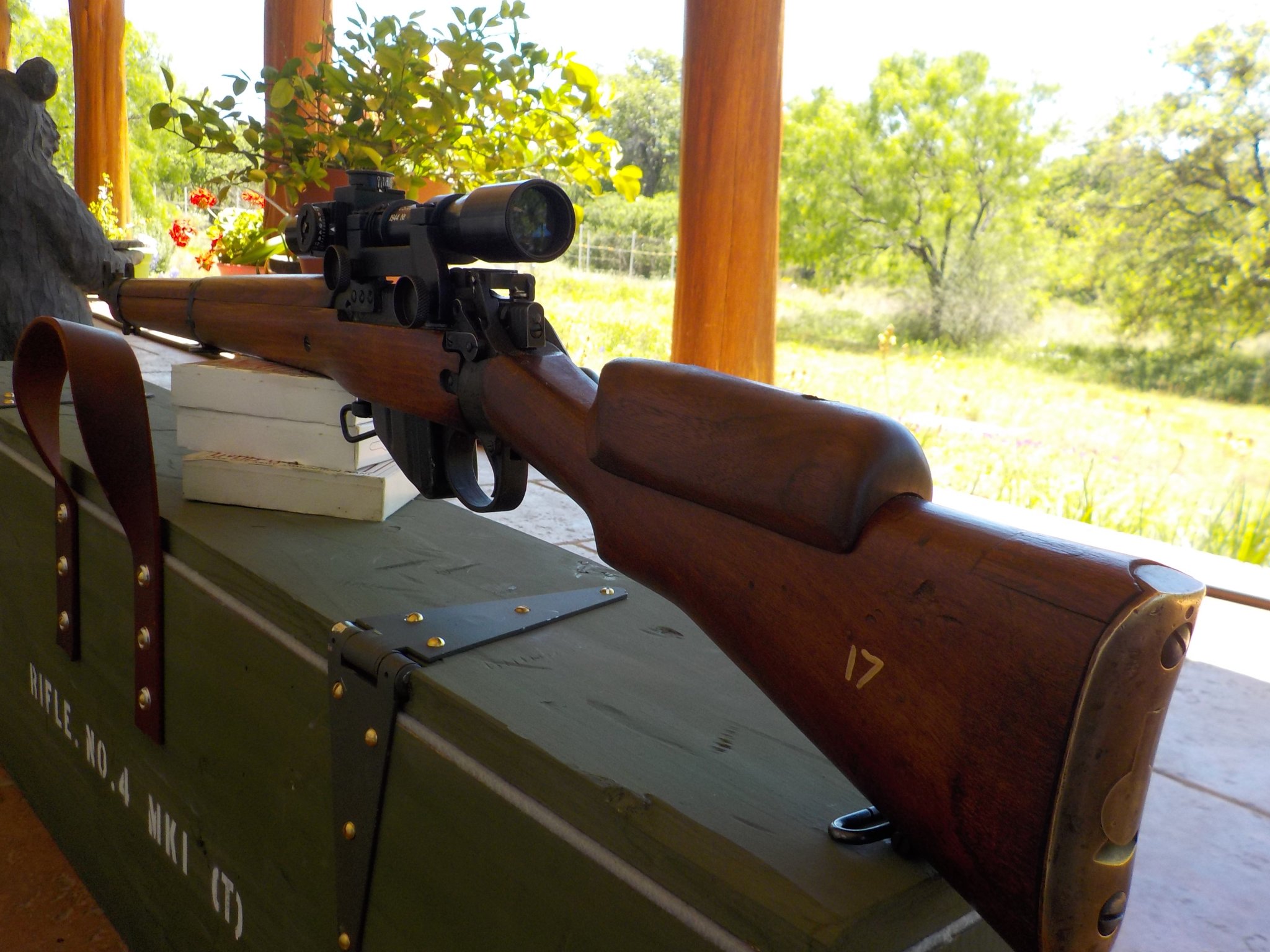

My Enfield sniper and transit case. My build.

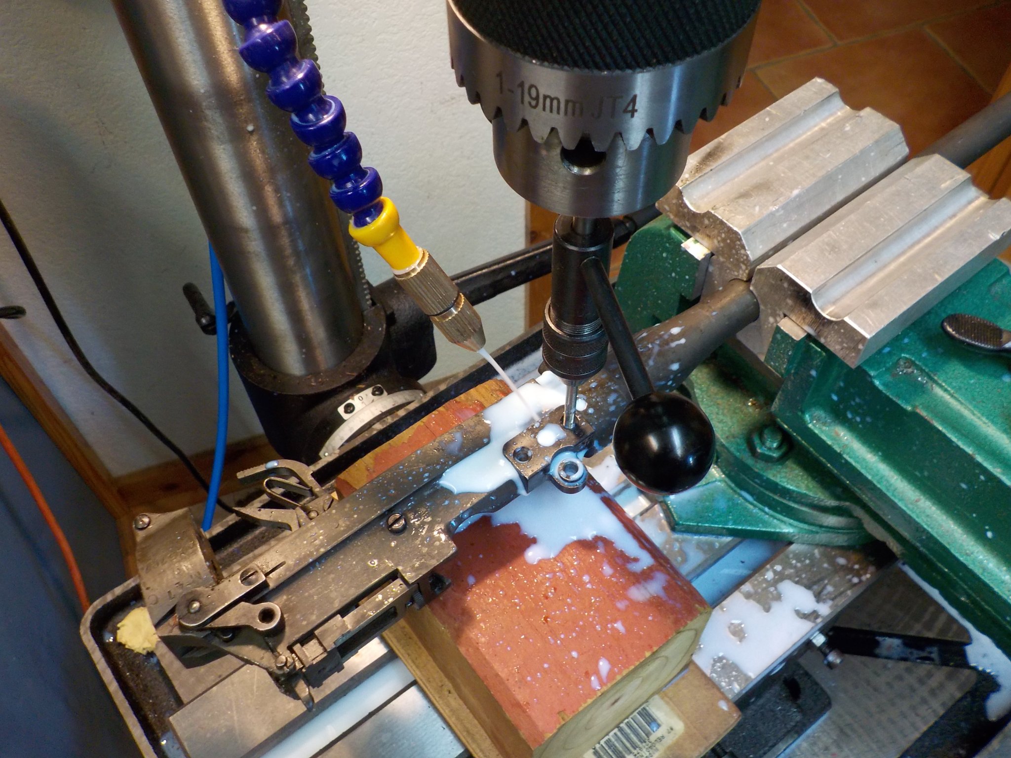

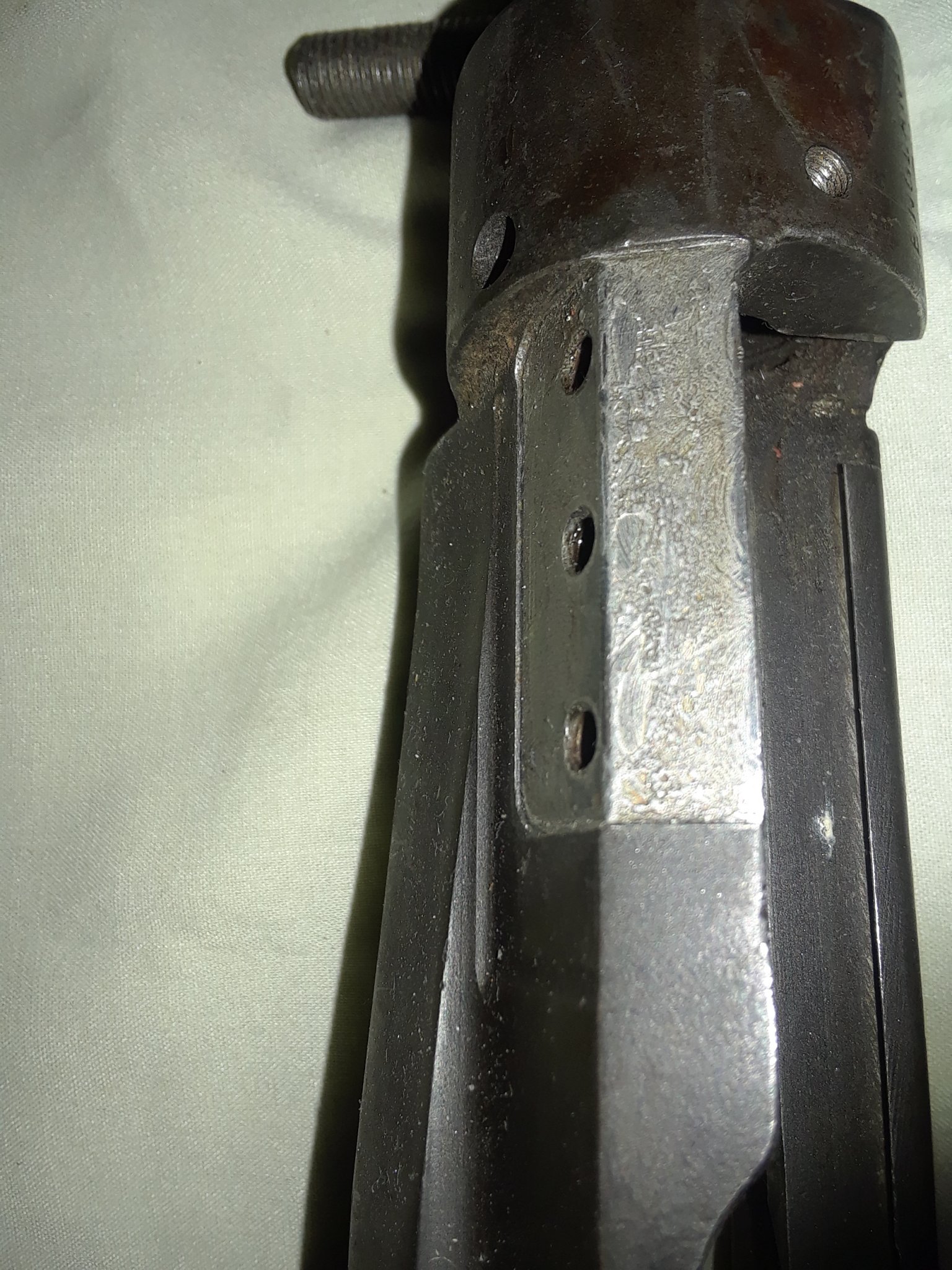

The above might help you in seeing how the pads are attached to the No.4 receiver.
The front pad is inletted about 8 to 10 thou into the receiver wall while the rear pad sits on the wall.
The rear hole is a BI*ch to drill as you are into the locking recess area of the receiver.
This is a junk T receiver that I lend out to folks who are mounting up the pads, but cannot lend it into the USA unfortunately

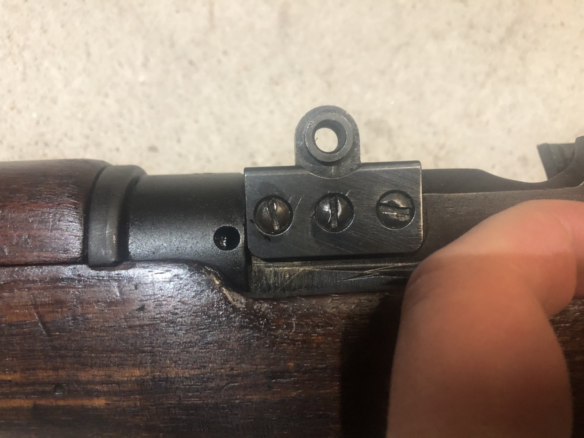

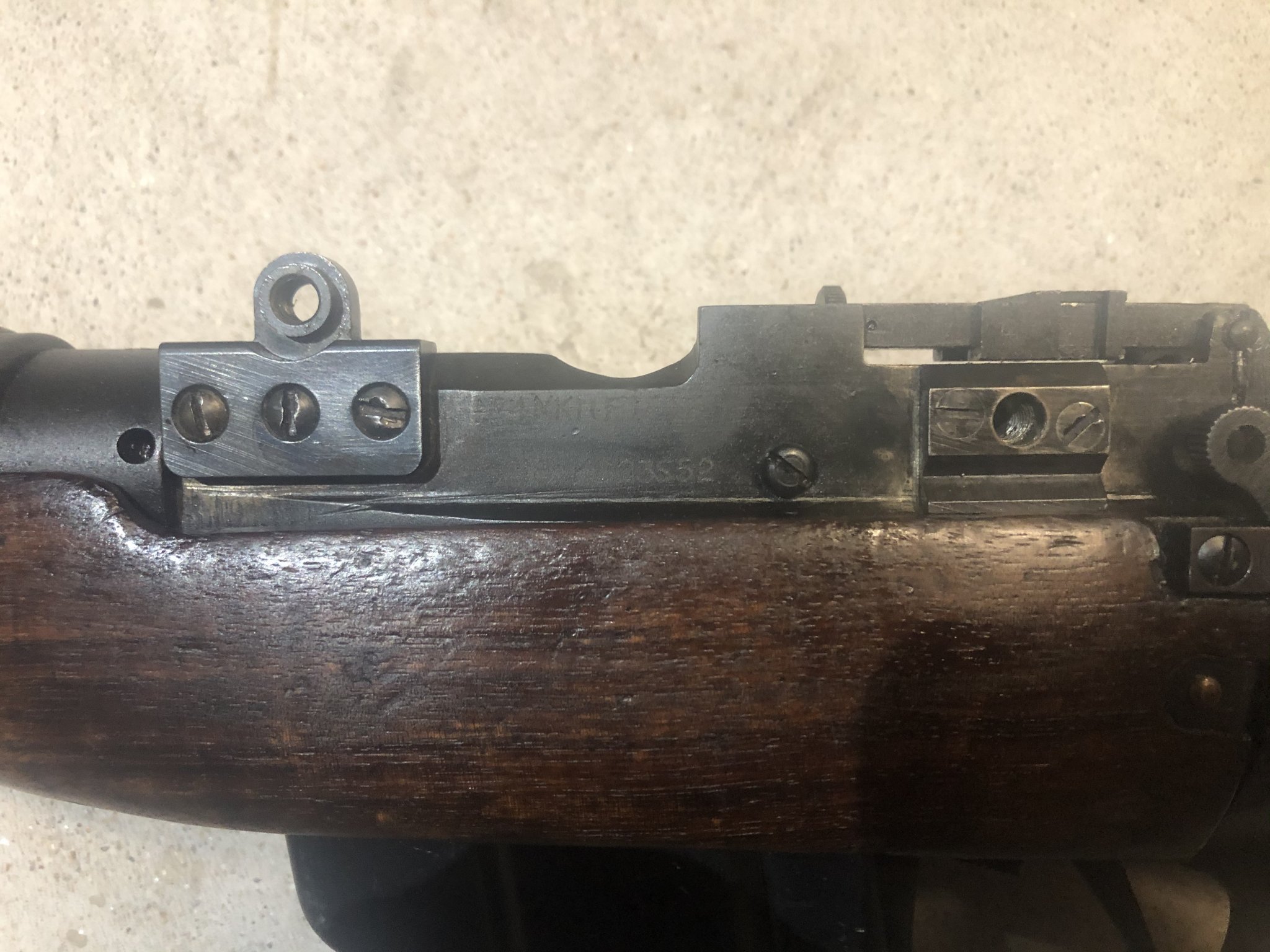

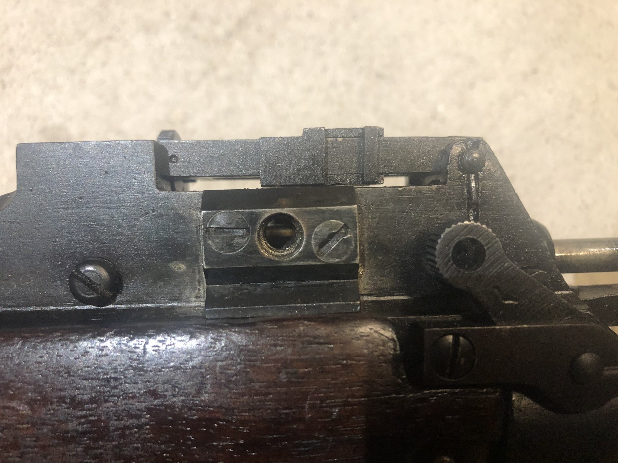

It's not extremely difficult, I have converted No4Mk1 to a (T), will post pictures in a bit and will be working on L42A1 tribute build (a donor bubba'd rifle is being rebarreled right now).

However I cringe when I hear the mention of silver soldering the pads. Too much heat required, especially when doing the rear pad.
The locking shoulders on a No.4 are induction hardened to an average depth of only .003" - .004".
The originals built by RSAF Enfield and at Holland & Holland used low temp soft solder on the pads to avoid softening the locking lug shoulders on the reciever.
That’s the reason I mentioned using 70pa solder - 425F melting temperature.
