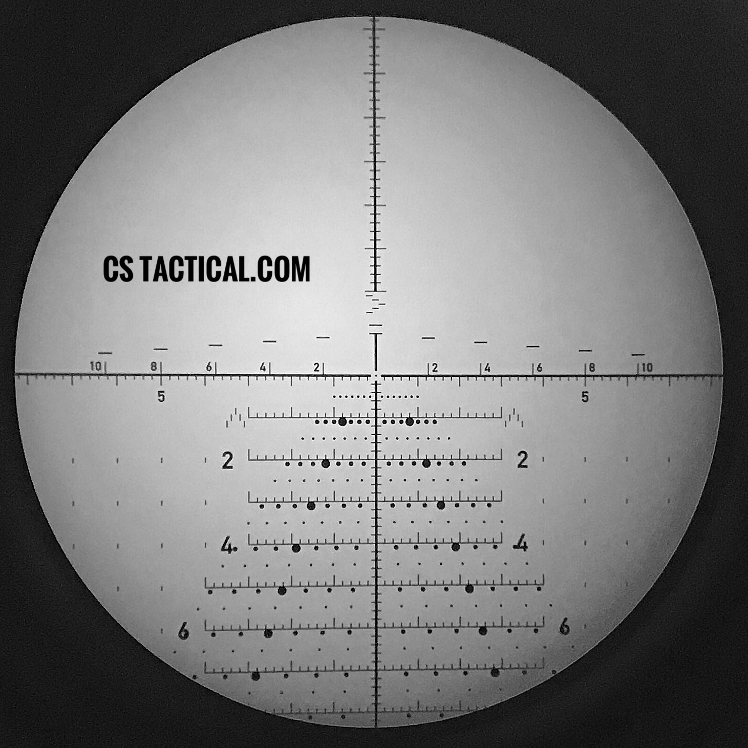

This is a question for anyone that owns these scopes or Har knowledge of them.
The 2 scopes in question are the Nightforce 5-25x 56 with a Tremor 3 retical and the Nightforce 7-35 x56 with the Tremor 3 retical.
What is the lowest magnification you can see the entire retical?
What is the highest magnification setting you can see the entire retical?
Trying to make a choice and I do not know anyone that has these rifle scopes.
CS Tactical Posts images too

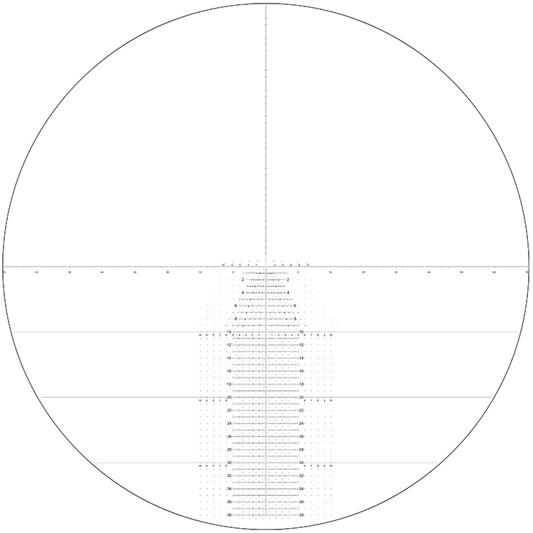

Ill post lowlights image again. With all front focal scopes as you zoom in those outer areas will move out side of your field of view. So for a 5x scope I imagine something like 5.1x the very outer dots will begin to disappear.
Look through your scope. Hopefully it is one of the two I am asking about or your answer will be of no use to me.
While looking through your scope increase the magnification until parts of the Christmas tree start to disappear. STOP. Now look at what magnification your scope is reading on the magnification ring.

You see 7 Mils at 35x just like the picture posted,
You can see the entire reticle on 7x

on a FFP scope the more you zoom the less is visible. Like the images that Frank posted, one is probably full zoom out, 5x or 7x, and the other is full zoom, 25 or 35x.
So at the bottom end of the zoom range it looks like you have 38mils. At the very top of the zoom range you get 8mils
