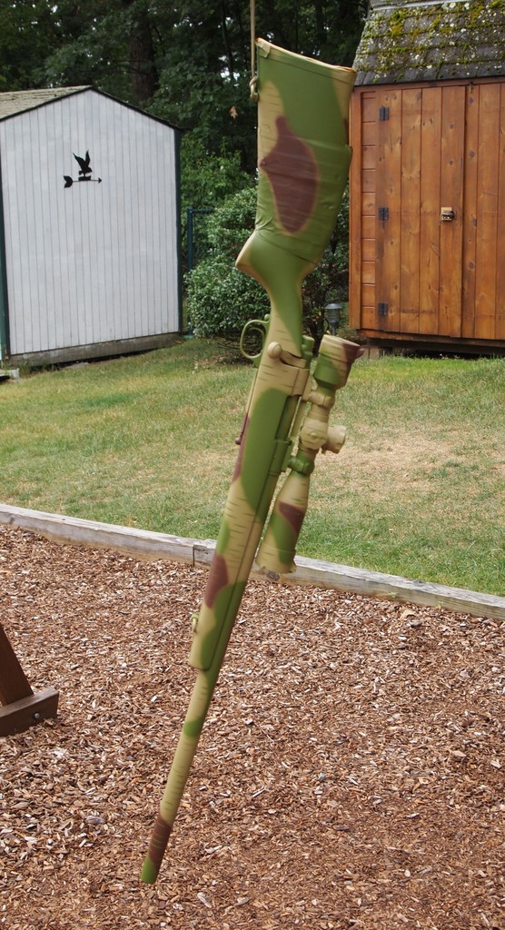

I'm leaning towards doing it with duracoat, but wondering if anyone out there has ever done the sponge-blotch style paint jobs with duracoat? I've never used the stuff before.
Not knowing the stock material for the Bergera, I would just use the same technique used on a bunch of others. First, and most important step is to use a good degreaser to prep the stock before hand. If the factory stock finish is shiny, use some 300-600 grit wet paper to abrade it a bit first. Then degrease it really well with whatever you have on hand that will do the job. Brake cleaner, denatured alcohol and even isopropyl alcohol are readily available and work, as does deglosser. The paint should adhere just fine. Let each coat dry a good bit before the next is applied to avoid bubbling and bleeding. When done. let it dry for 24 hours and then apply a protective matte coat of clear. It will keep that Krylon paint job good looking for much longer. It will still wear, but much, much slower.
Oh, and to answer Namekagon, the sponge-blotch style paint method works fine with cerakote.

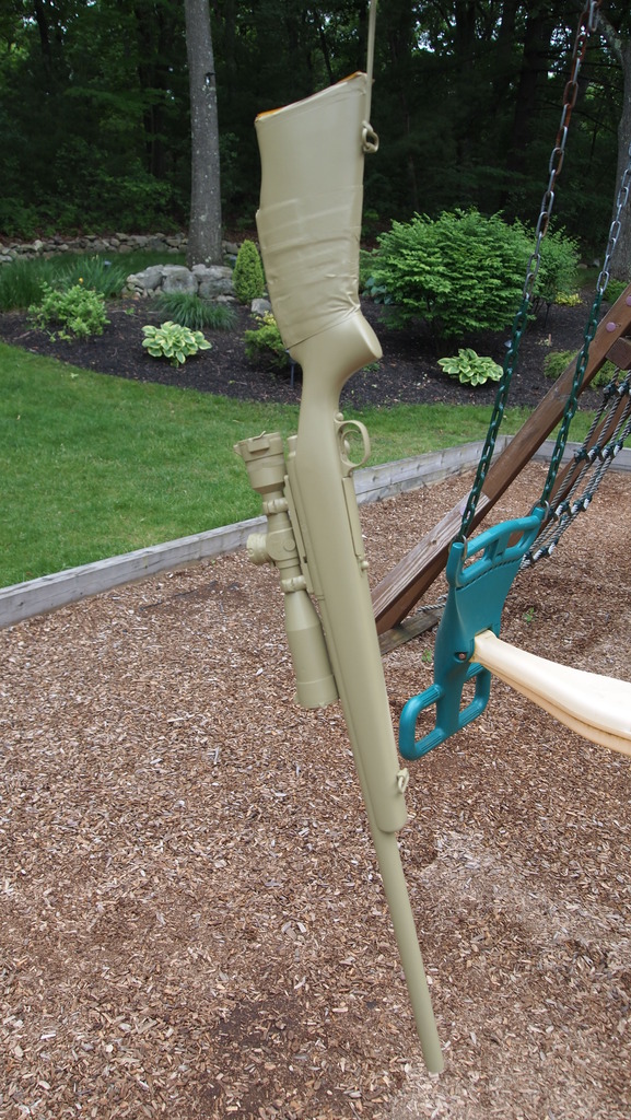

Think it could be applied with a sponge? With your rifles, did you use regular duracoat or the aerosol version? I don't have a sprayer for my compressor. They aren't too expensive, so I could get one. But because I plan to just lay down a base color and then sponge blot colors on top of that, I think aerosol would work fine too. Any insights from your experience?
The durability of regular spray paint worries me.
Don't worry about the durability of regular spray paint. Put on a couple good base coats, then be prepared to touch it up every couple years, unless you use your stuff in a field environment often. My rifle gets banged around the woods in FOF or other "tactical" uses at least two days a month generally, and I haven't painted it in probably two years.

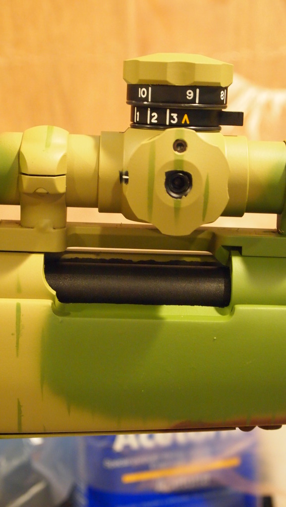

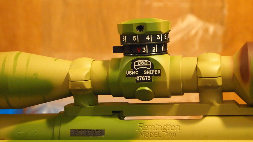

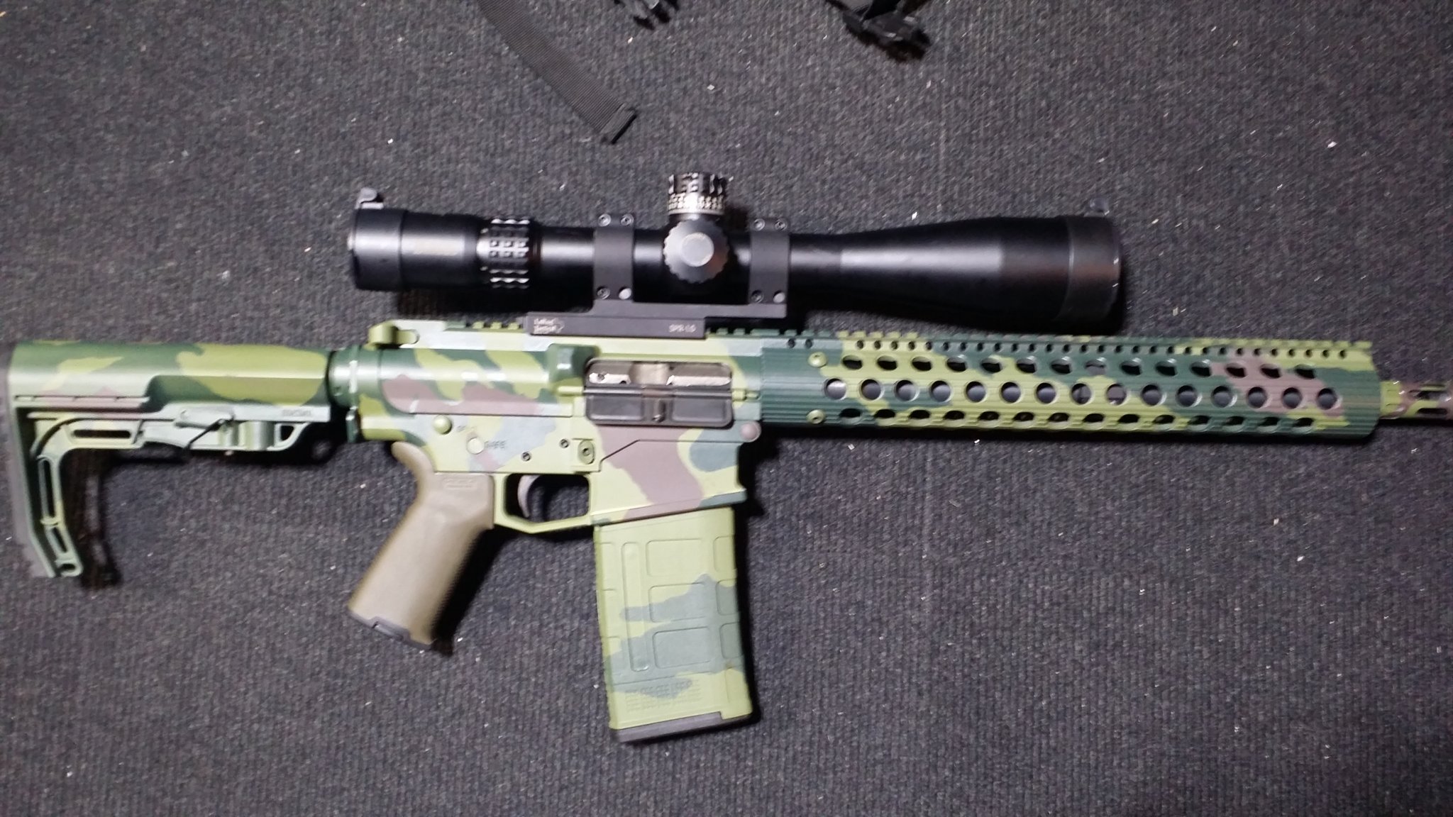

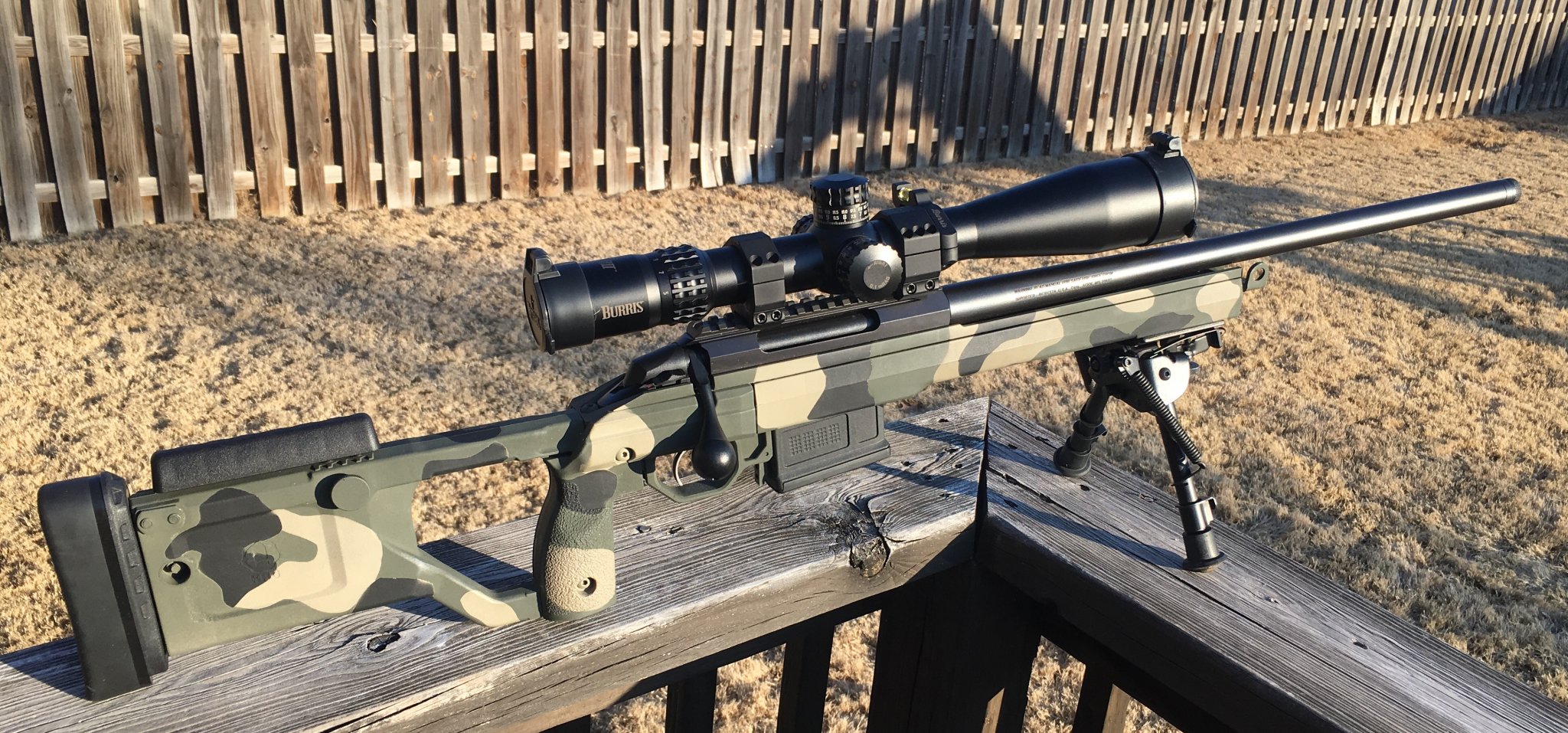

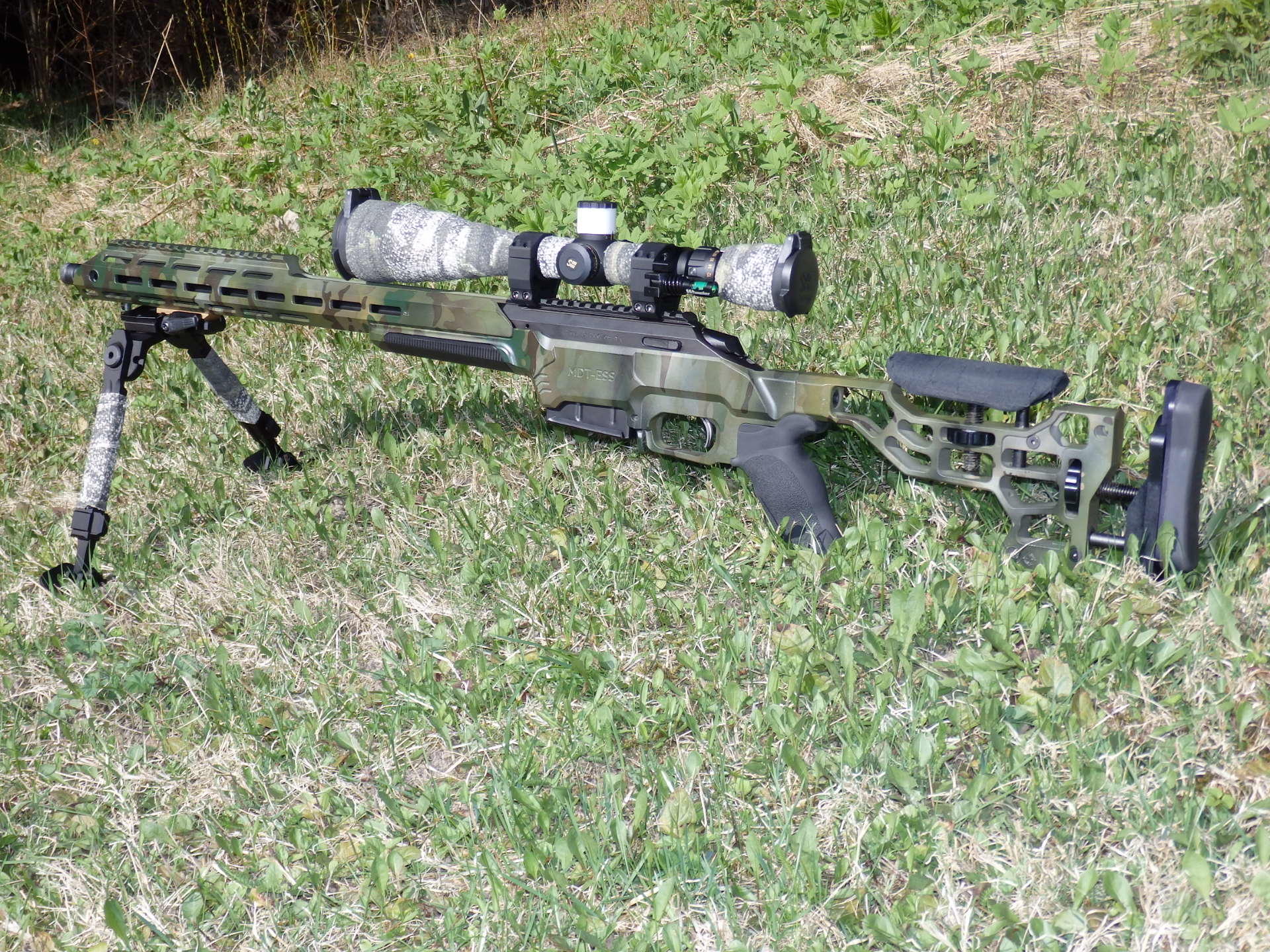

Here’s a rifle I did with krylon and it looked identical after hiking a lot of miles and usage during the hunting season.

Nice rifle Rerun7. Thats pretty much the exact color scheme I'm after, but with the sponge style. Guess I won't write Krylon off. My worries come mostly from experience with stuff I've painted for duck hunting. BUT....didn't do any prep work on that either. I'm gathering that makes all the difference.

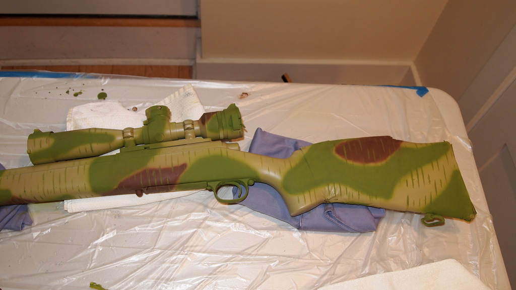

I used the aersol version in my airbrush I sanded all parts and. Ever had any issues make sure to let it sit for a few hours between coats.
A good adhesion promoter also makes all the difference with the rattle can stuff. Knock the gloss off the stock with Scotch Brite, apply adhesion promoter per instructions on the can and then top coat as usual. The sponge style camouflage hides the eventual wear very well.

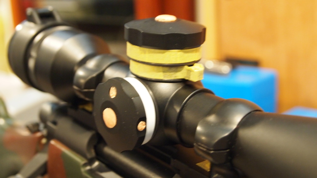

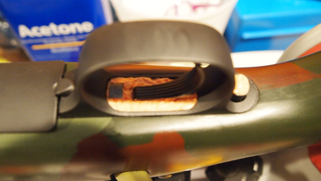

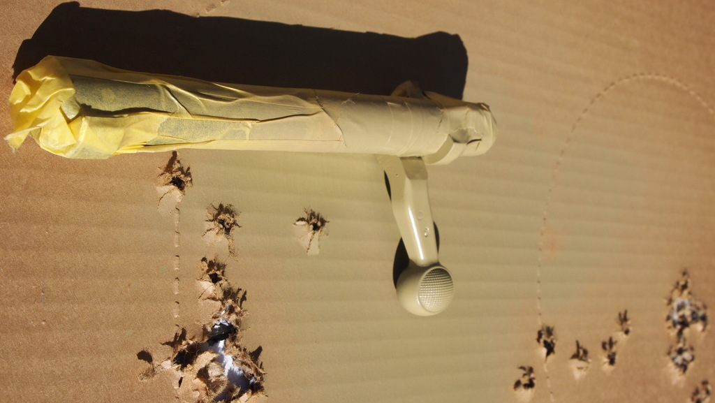

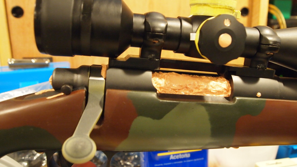

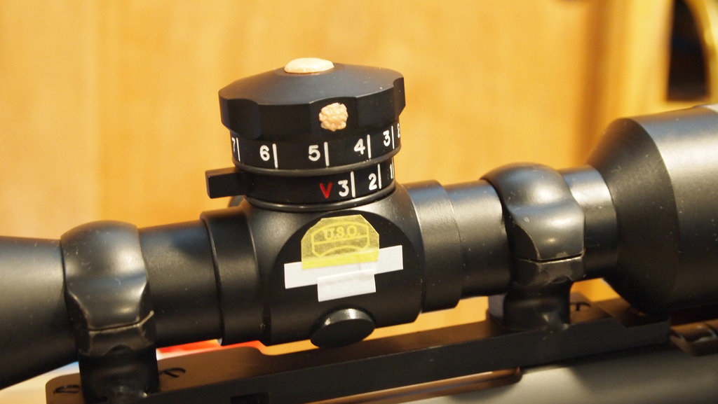

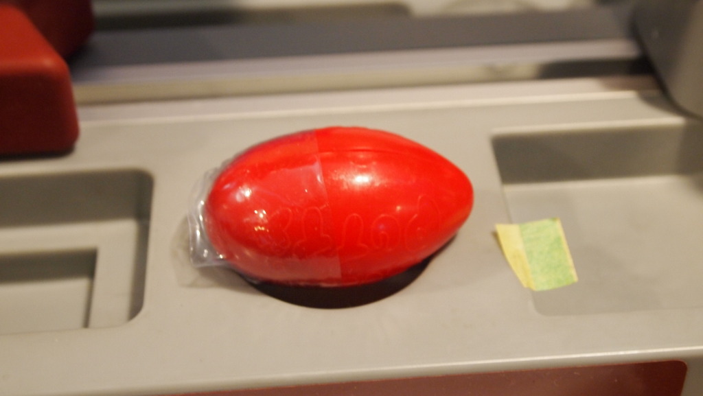

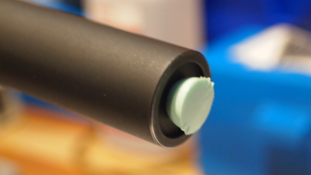

I used "Silly Putty" bought cheap off of Ebay for a mask. was easy to fill around the trigger/ loading port/ safety other orrifeices you dont want paint to get into and removed clean.
Use an earplug to plug your bore.

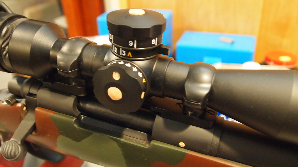

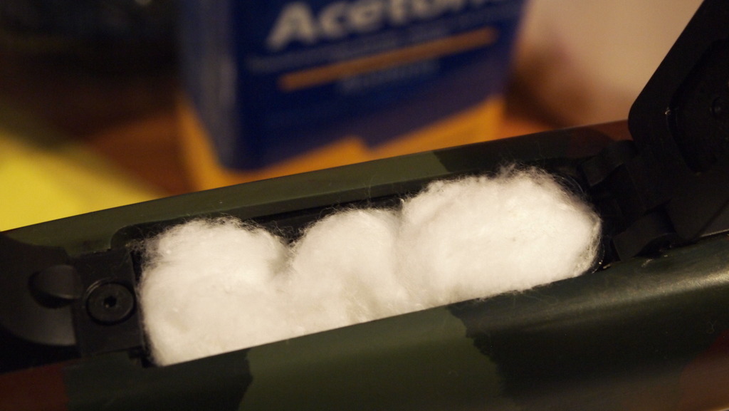

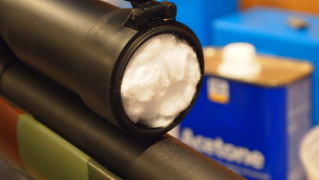

Stuff your lens opening with cotton balls than close the lens covers before painting. The cotton balls will catch any overspray that may get inside the lens caps.
Tamiya modeling sells some various width masking tape to cover things like gas ports, scope mount screws, serial numbers, scope turret markings....check it out on Ebay.

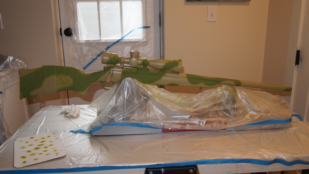

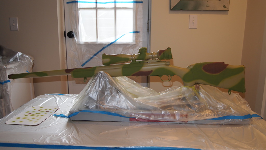

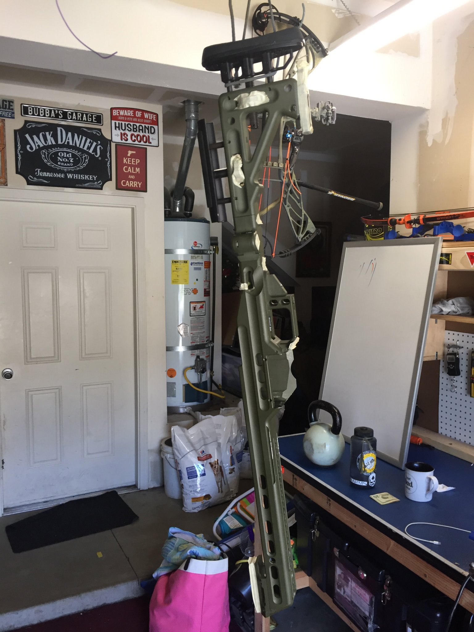

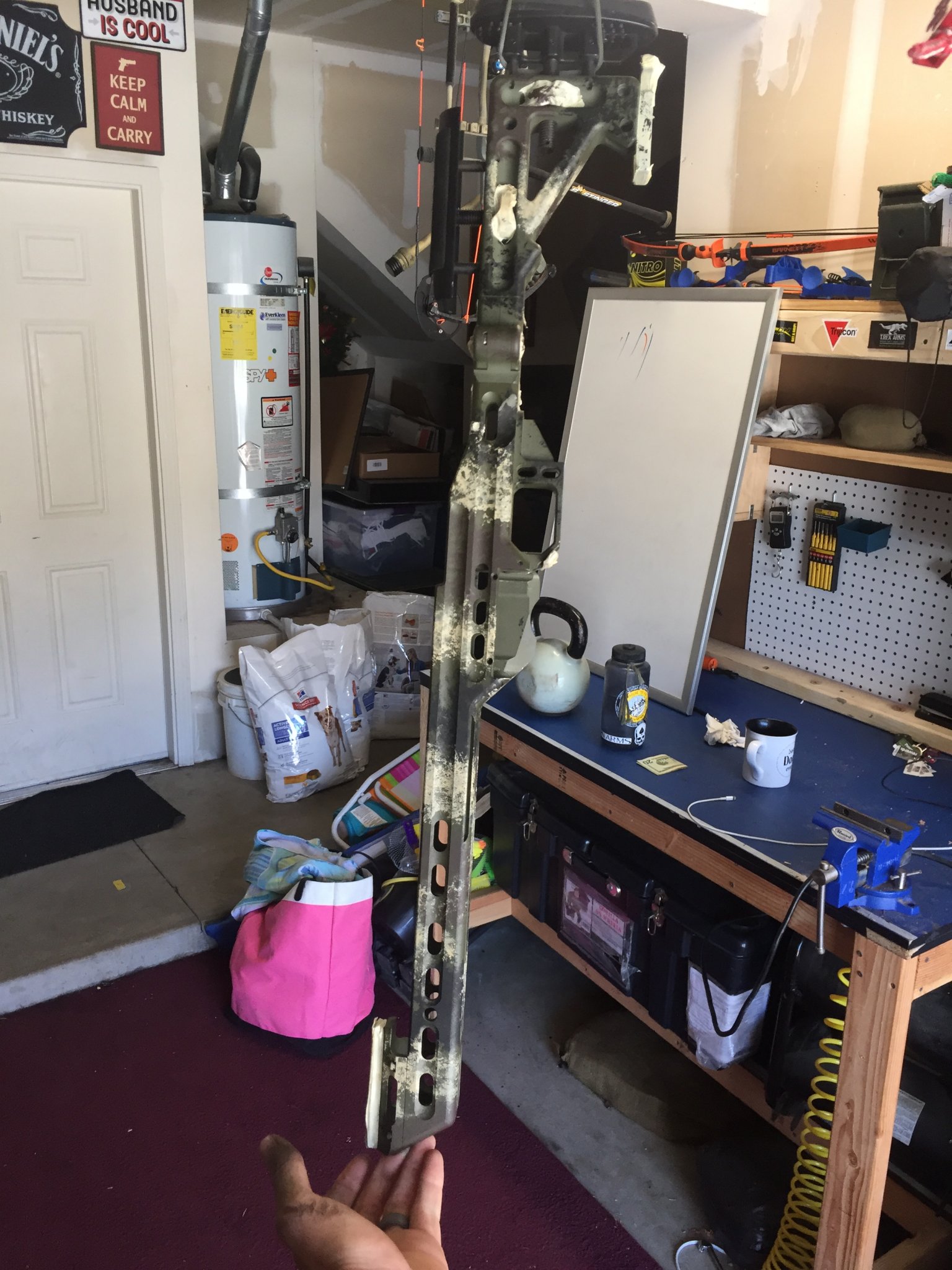

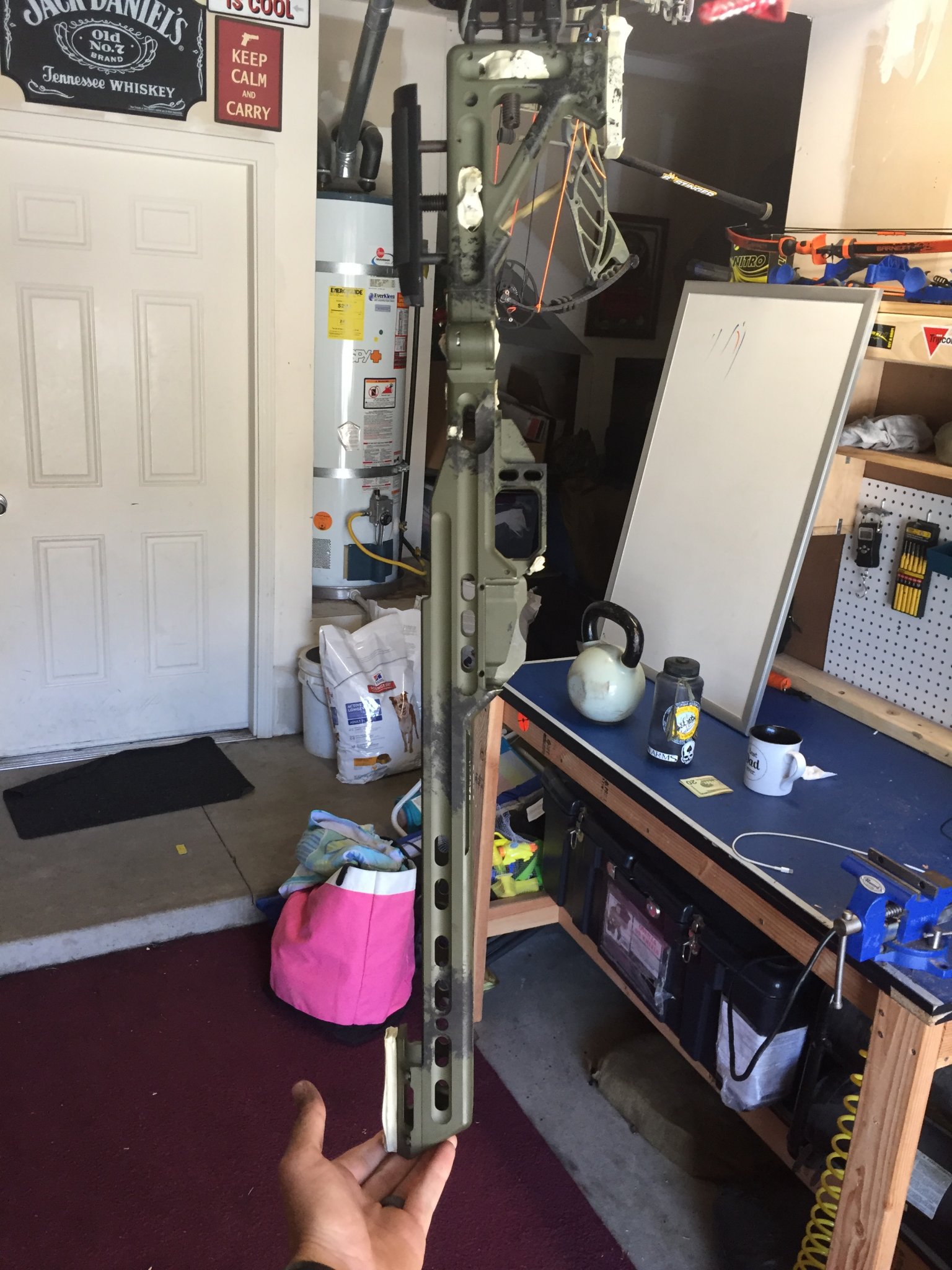

My first attempt at vandalizing $6K in gun....

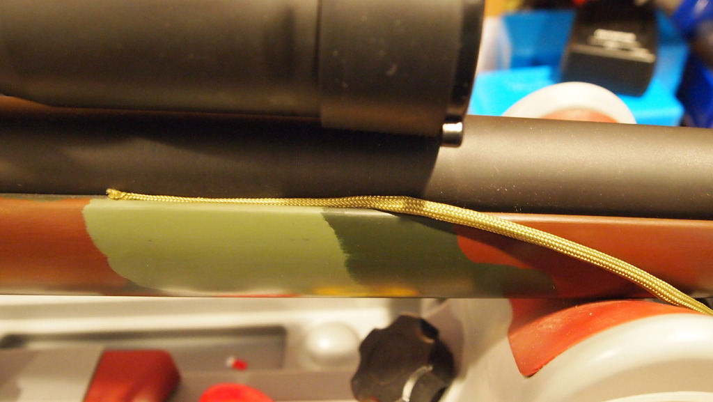

If you find you need a more aggressive approach I’ve even tied some paracord to them and dragged gently across the carpet to get a more battle worn look.
That's a fine looking stick. I like it!

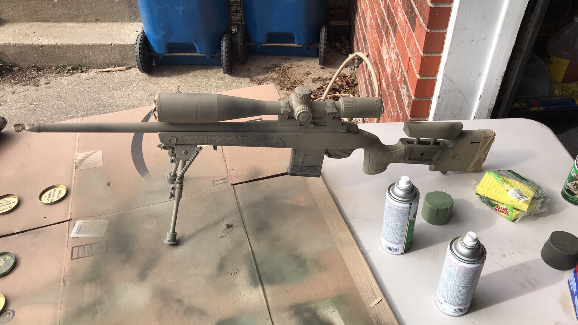

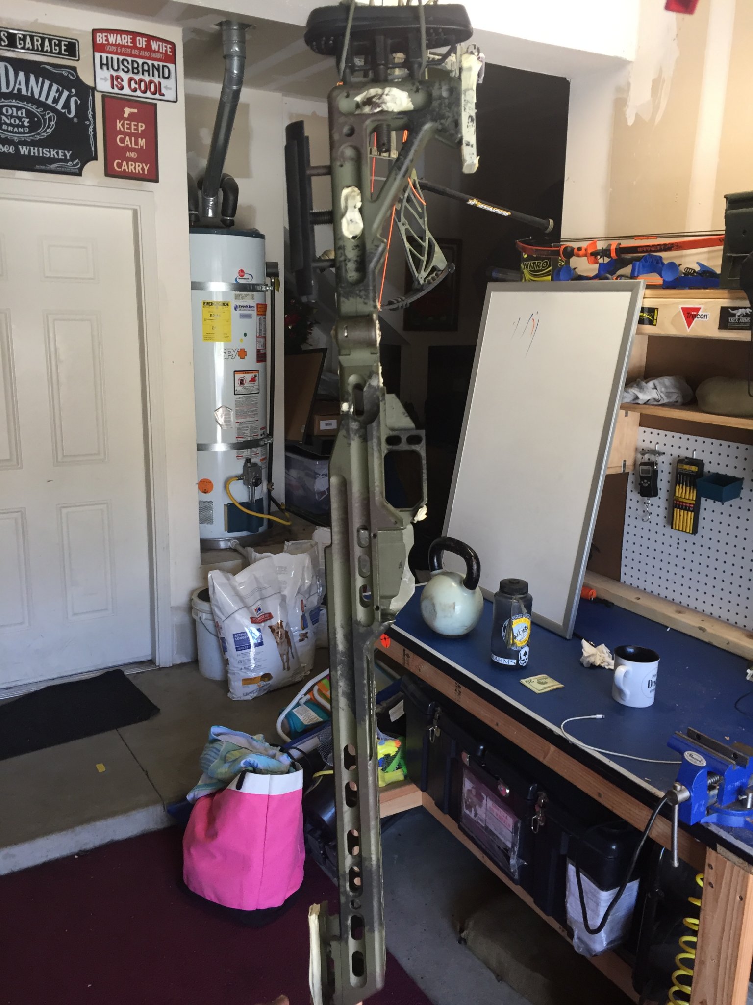

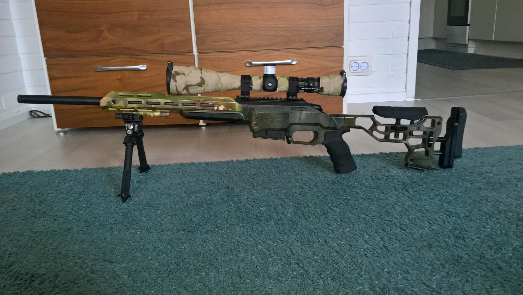

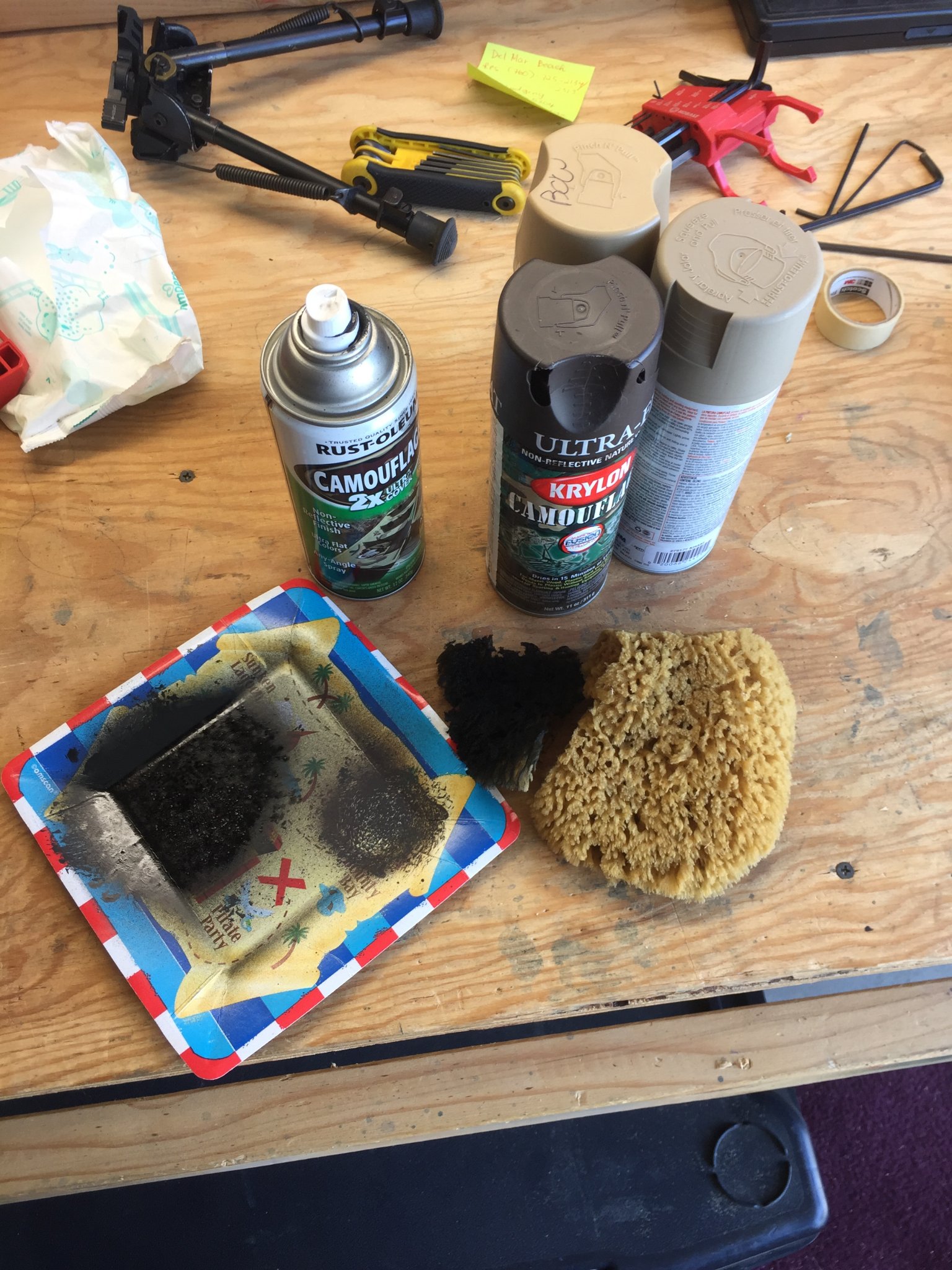

I used soft foam spong.
I sprayed the paint to a disposable plate, and then dapped the spong to the plate and then dapped it to a stock.
My stock was green, so i started the dark color first and head it to light color in the end.

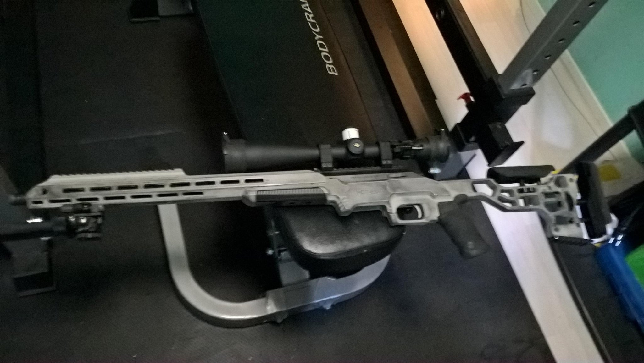

I had a dream in my mind to make it look like this, but it did not worked, but i got unique KRG chassis :)
I like how your KRG turned out. I wish I had better pics of the rifle I did, i sold it a while back but this is what I got in the end. I did it on a B&C. Started black and used a sea sponge with good old krylon spray paint, lasted 2 hunting seasons and multiple days at the range never wore off.

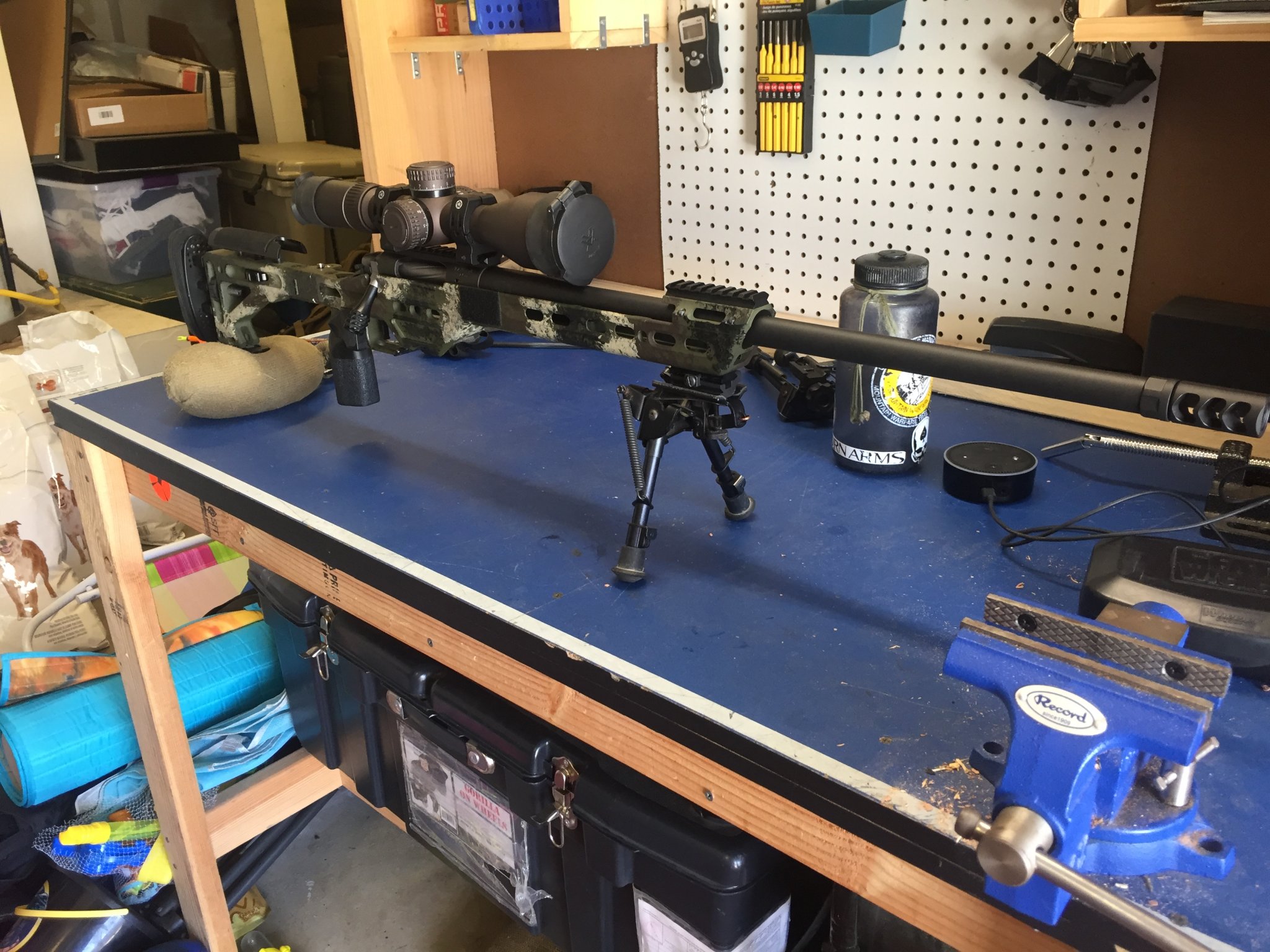

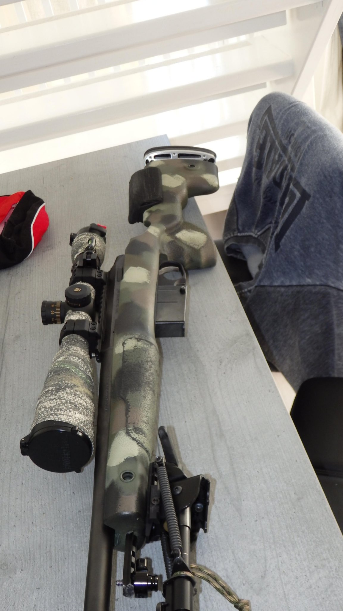

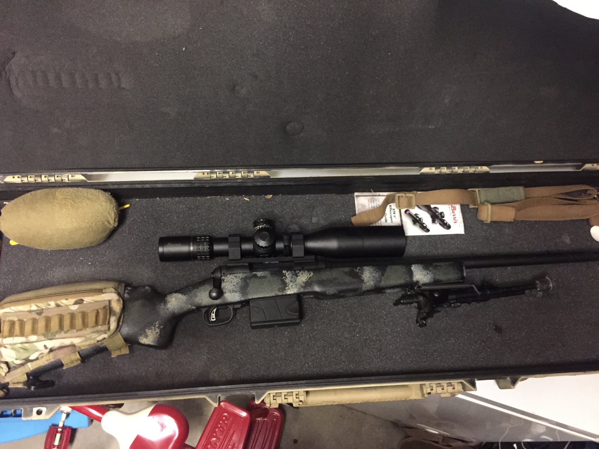

sea sponge from lowes works out good. Taped all hardware off, and went to town. Went black, brown and tan. Surprisingly in person the brown matches the scope really well
