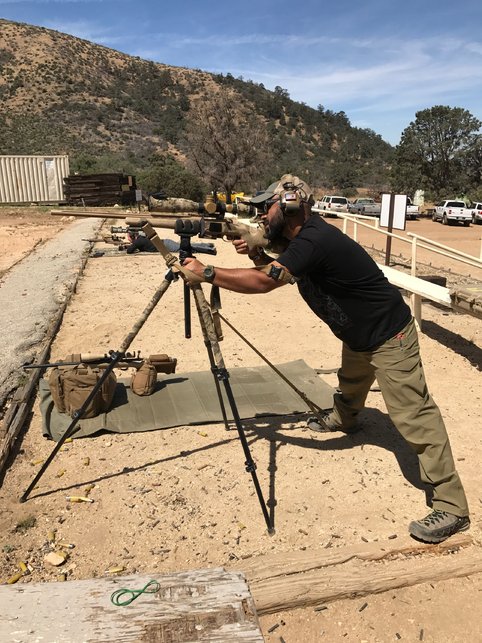

We at Kopfjager Industries developed a tripod specific strap called the K.I.L. Strap. Instead of attaching to the belt buckle, it is designed to loop around strong side foot so you're not breaking your position as you do with bending at the hips for adjusting other tripod slings. As with any product, it is a tool, use it correctly and apply the fundamentals. You won't be disappointed with the results. It also works great as a sling for transporting your tripod. Reaper-rest.com if you have more questions on how it operates. Thanks. -Garret

Garret, just so I know Im tracking right, this attaches to the tripod not the rifle correct?

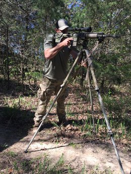

It is attached on the tripod center column and can be ran to the foot for stabilization or, a more effective way, is to also attach to the rifles sling and run around front leg. As the previous member stated, these techniques might not be conducive to every scenario but proper usage esp in a windy environment will greatly reduce movement and allows for faster followup shots. It can also be attached to your pack or weights and let hang underneath the tripod. It can be used with any tripod setup or rest. -Garret
Its definitely not a gimmick. I don’t think you could pass basic Scout Sniper School, Urban, or Advanced without using a sling. The sling helps you load into the tripod and lock your bones into place. (its all about bone support & points of contact)
Do you get more juice out of your sling when using a cheap tripod? Sure. But it also allows a shooter to engage 1000+ yard targets with a sub $300 tripod kit.
Our SS Loophole Sling and other popular two-point slings do not have arm cuffs because they simply are not used during practical application. The cuff only adds weight and cost to the sling.
Free recoil techniques may work with heavy, low recoil bolt guns, but you will be manhandled by a heavy recoil, light rifle or gas-gun while attempting free recoil. There is a time and place for everything. A balance between stability & recoil management.
