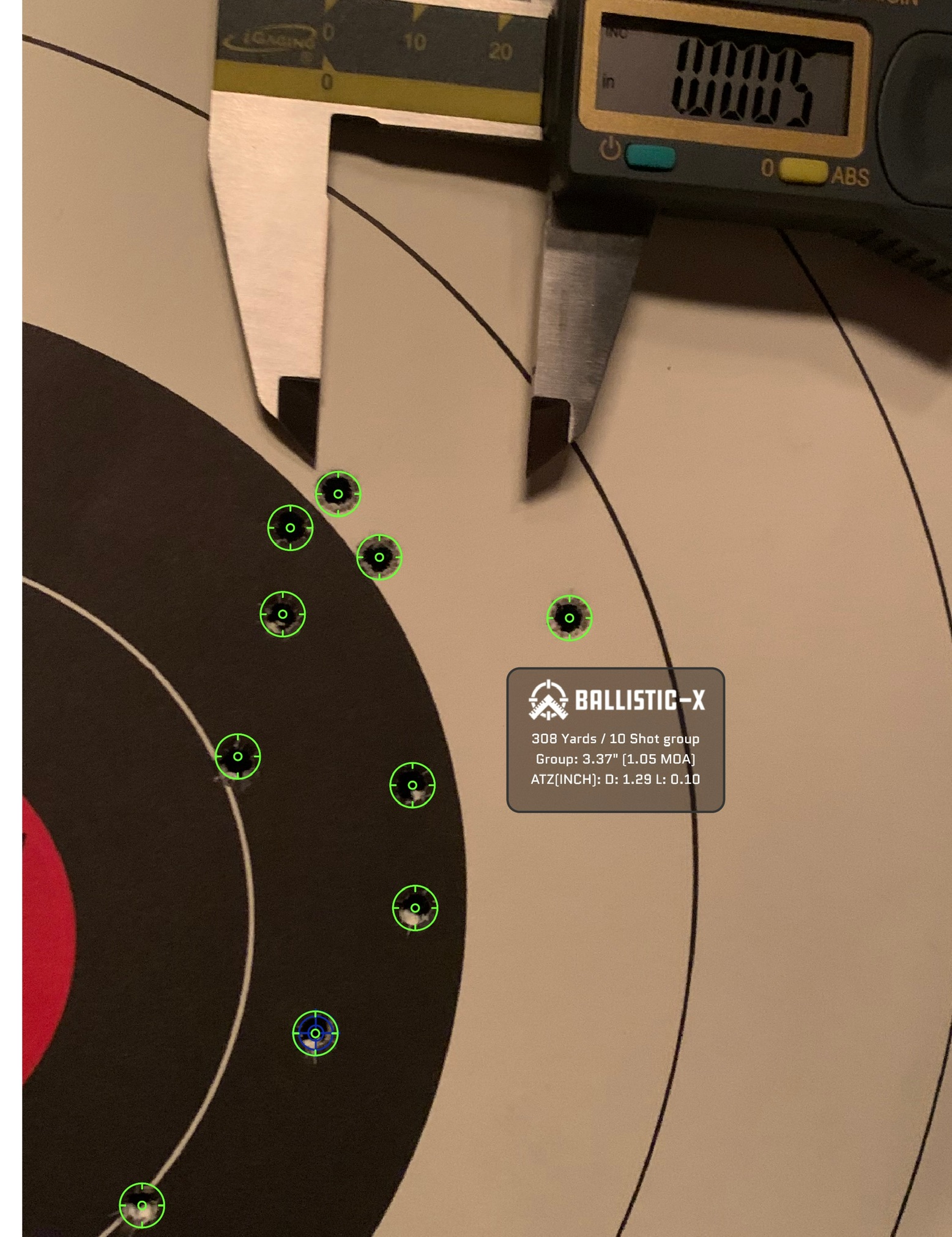

More testing needs to be done at 300 but so far it is just shooting lights out and at 200 and in it’s almost too easy. 300 was a bit of a challenge but shot a 10 shot 3.2” group.

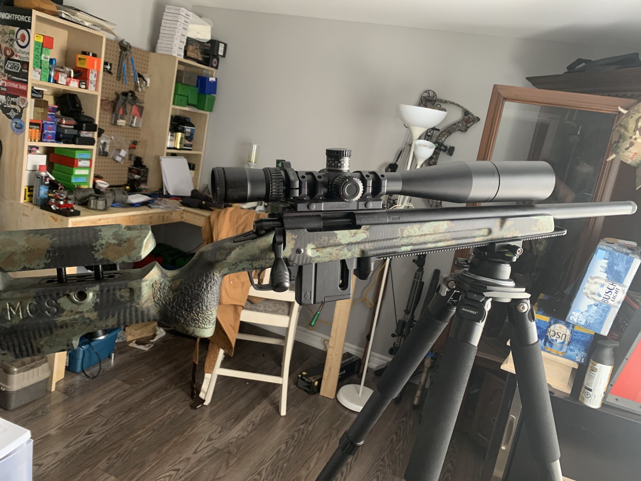

I have a 20” mtu ace

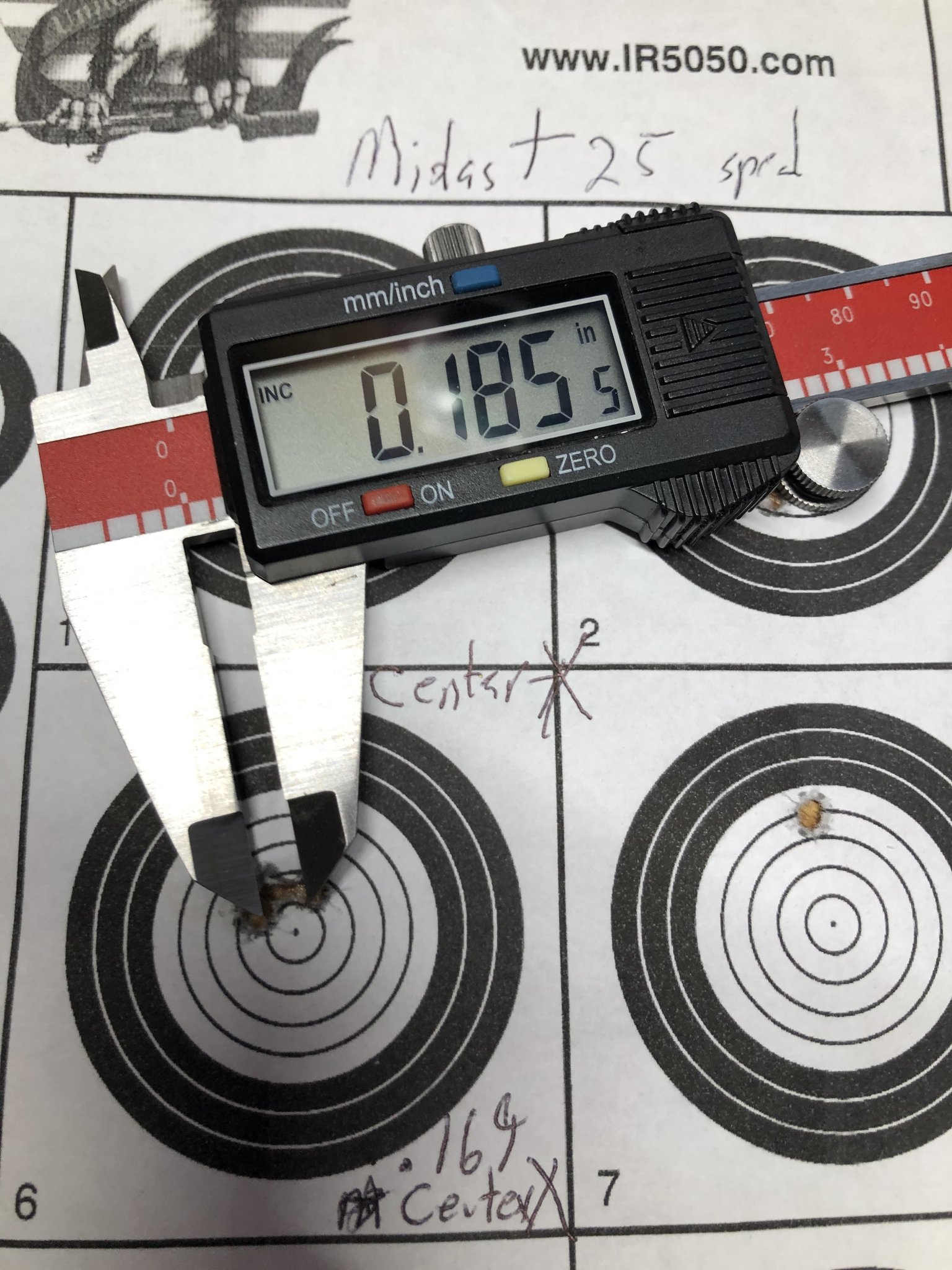

View attachment 7591610View attachment 7591611
That is very good for a 22lr. I typical do 20 shot groups. I only have done 200 and 400 testing.
Which twist 1-16?
Nice shooting and great looking set up. What scope is that? Large bolt handle?
Thank you. Those particular groups were shot with tenex. Center x seemed to preform as well but going to test all of them in the coming weeks cause tenex is too expensive to shoot so hoping sk, Eley club, or Center x hold as well at 300. Have 3 shoots April may and June, and a team shoot July and a team shoot November. In that picture it’s a Nikon black. It was wearing an element nexus for the longest time but a friend wanted to try it so he’s had it for the past few weeks and don’t think I’ll see him for a couple months so threw the spare black on.

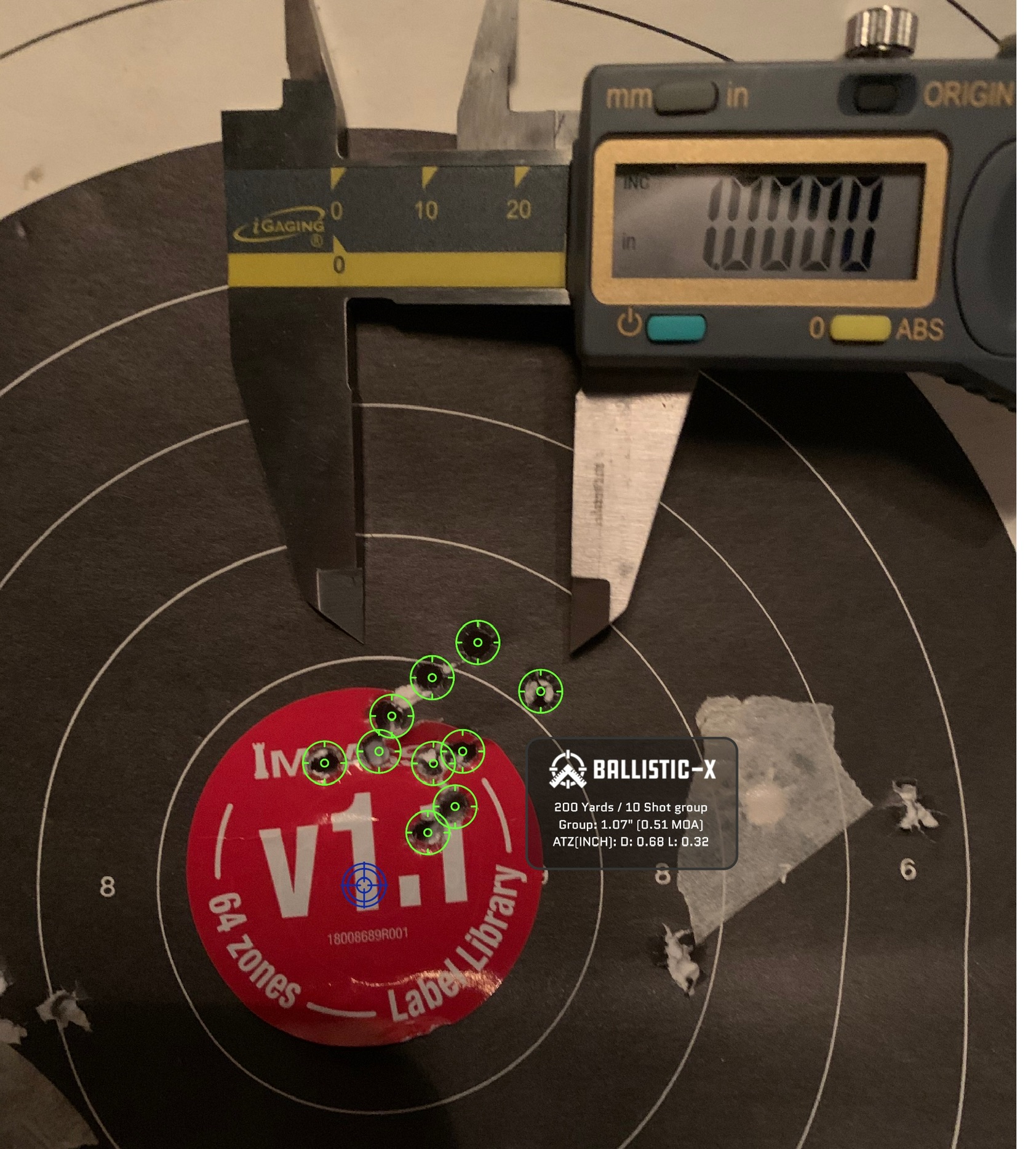

Average good ammo for this gun 20 shot groups 23-25" vertical. 6-9" wide

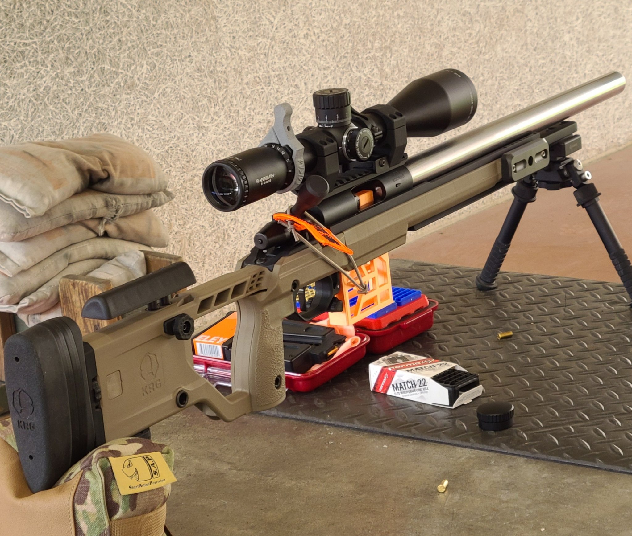

I went with the 18 inch Proof Competition Contour and put it in a KRG Gen4 Xray chassis and run a TriggerTech 2 stage standard 8oz/14oz. So far only 300 rounds through it 50 and 100, won't bother with group pics it shot for me as expected and equally well to the 2 Vudoos yesterday. I'll take it to further distances hopefully tomorrow.
