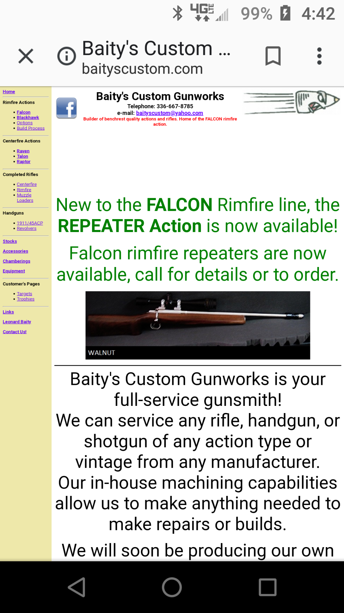

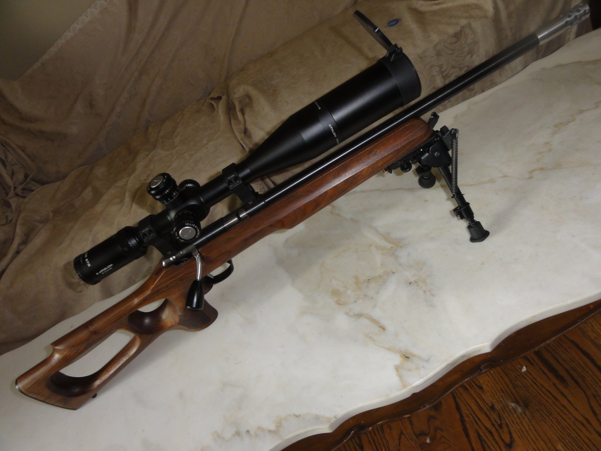

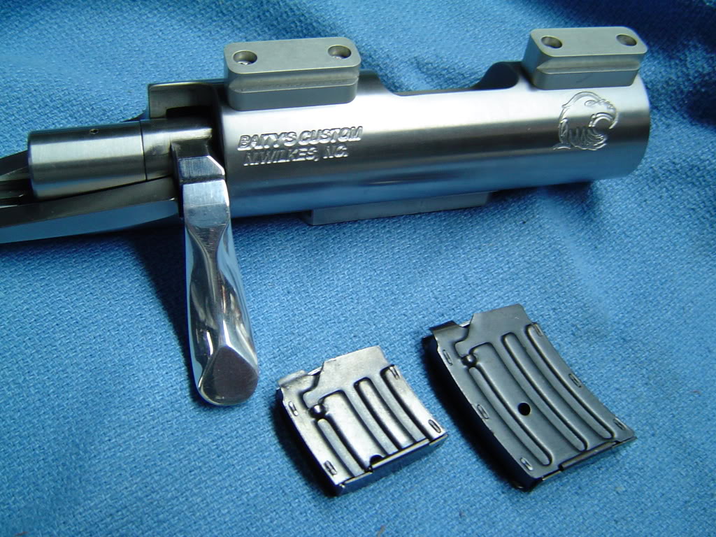

He can also give Dan Killough a call at Killough Shooters as he has most of them on hand and get a recommendation.

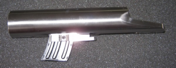

The picture is of a Falcon Repeater. The Stiller is also a repeater and fits most 700 inlets and chassis.

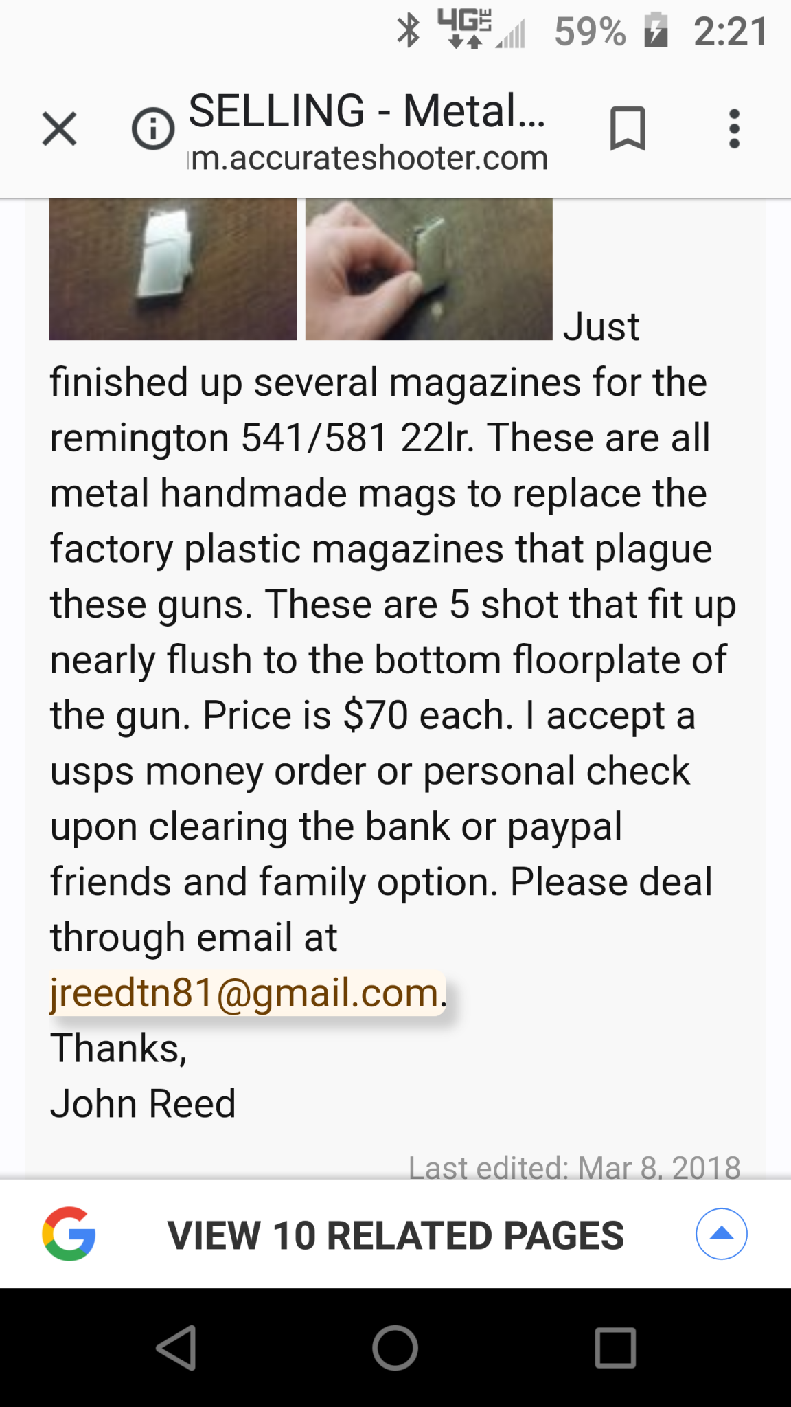

On the magazine's I use custom made stainless steel mags for my 541 as the cheap nylon magazine it comes with isn't up to par.
Maybe someone can clone the Savage magazine if it's an Achilles heel?

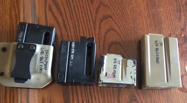

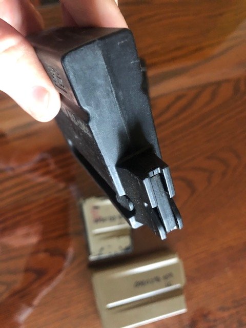

Left is a standard AICS mag carrier with a Vudoo mag inserted, the V22 10rnd mag, 5rnd and 10 rnd AW.
Below is the top of the V22 mag. They seem to work a as well or better than my CZ and way better than MKII did

This is the home page from Baity Custom Rifles.
I don't know why I waste my time here.

I called Baity today. While I may have misunderstood his accent (almost as thick as Mr. Lynwood Harrell) and he stated the action I posted is what they are currently making , I asked If I could get a repeater with a magazine, suitable for nrl22 and the answer wasn't yes...when I asked what magazine the repeater your are referring to in Calfee's book used, his answer trailed off and he definitely didn't give the impression that one could get one any time soon from them...

It sounds like a miscommunication to me the repeater has been on the market since 2012.

The most famous custom 22 Rimfire action was the Turbo made by Flash Ebert who is no longer with us. Anthony Diorio bought the rights to make them several years ago and they make a repeater.
His email states above there newest version will be suitable for NRL22 despite what others have said here.

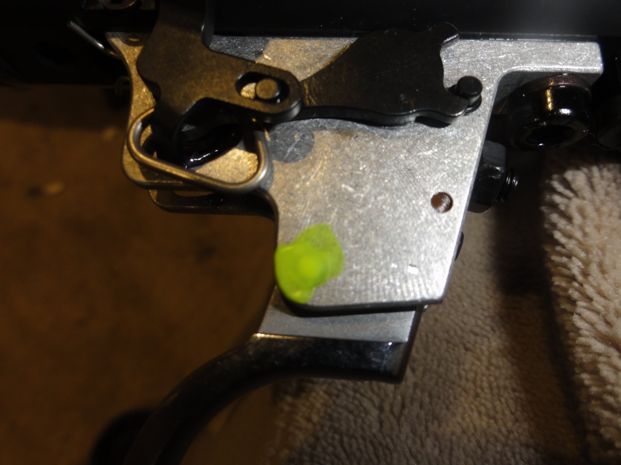

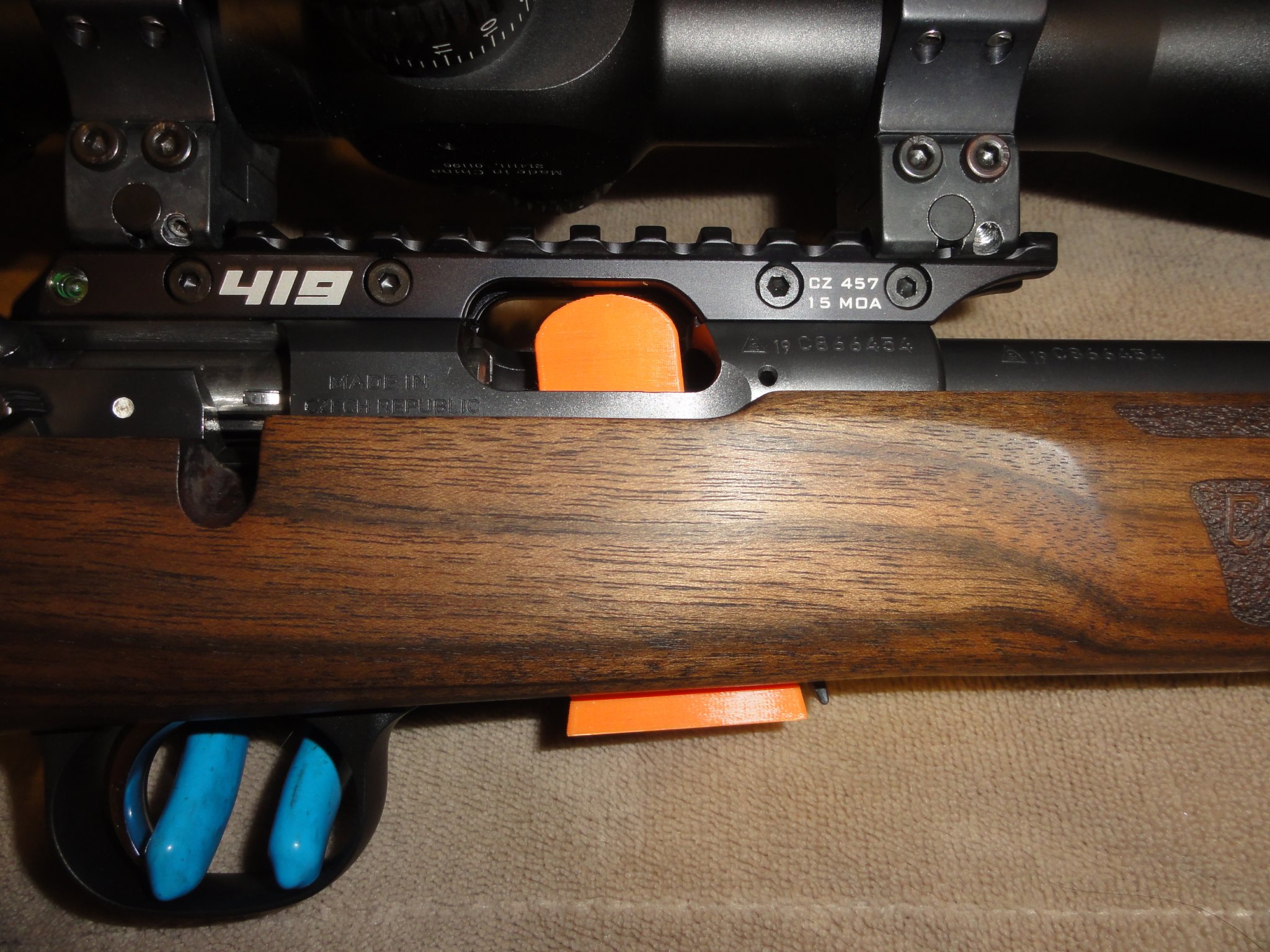

Hello Rookie..... I have a CZ 457 MTR ( 700.00 ) that is very nice and shoots very well. It's only real downside is the round bolt knob that it comes with. If you get an AREA 419 knob you will be happy. I had my doubts looking at the photos but it functions great ! A Yo Bob spring kit in the 457 will allow you to get the factory trigger down to 9 oz. or less. It feels more like 6 oz. The CZ is my second favorite .22 lr.
I have two Annies that I wish I had not bought at 1650.00 and 1150.00. They have the 5098 triggers and are factory set at 6.25 oz. Their problems are the expensive magazines, smooth butt plate that slips on your shoulder and round bolt knobs. The action is also not smooth at all. Mine are the 1416 carbines. They are accurate enough and they are very very lite. Somewhere in these threads, someone said that the mag release on the Annie " Sucks Ass " ...... He was not over stating the problem.

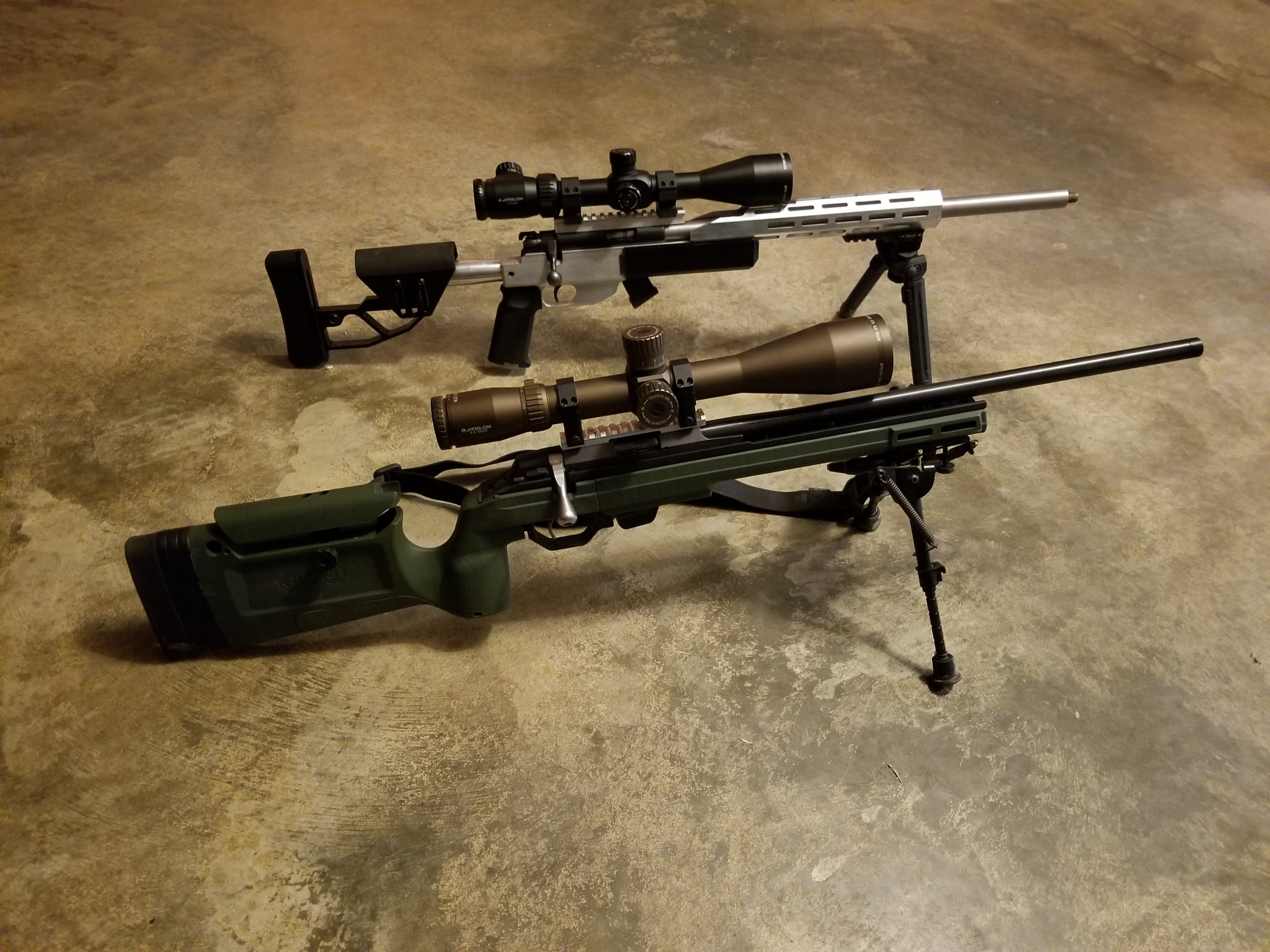

I have a Ruger RPRR and a Ruger American. The RPRR is actually very accurate and operates smoothly.
It's magazine is very snug in the mag well.
The American is a POS. The magazines are very loose and the accuracy is very poor because of that.
I adjusted and lapped both of my Ruger triggers to 1 pound, 1 oz. They are lapped to a mirror finish shown in photo 9.
I had a Savage MK 2 for about a week and sold it. It was accurate enough but that was its only redeeming quality. Even after I put in a 100.00 aftermarket trigger I let it go for 200.00

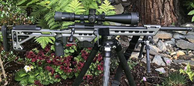

There is really nothing that I don't like about my V22 in the MDT chassis. She has a Trigger Tech trigger set at 6 oz. and a 5-50x56 Trijicon scope and a real Atlas Bi-pod. I also bought 20 logo mags for her and she is now bristling with weights. In total she is a hair over 18 ponds.
If I could do it again, I would only buy the CZ 457 MTR and the V22. I also have six scopes that I would not buy again.
