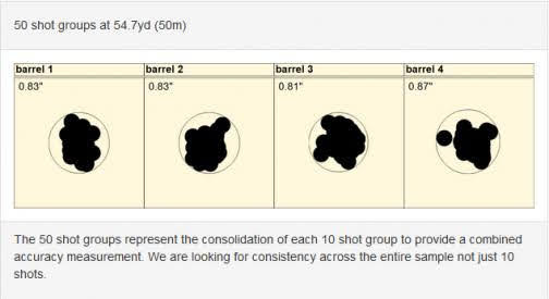

Run at least 100 rounds to verify the results.
5 shots is a random act of accuracy.
10 shots is a wallet group.
30 shots is a good start.
50 is the minimum needed to make a decent guess.

The Eley lot analyzer offered these comments

Struck me that in the Eley 50 shot test none of the rifle or barreled action, ammo and support combos had close to sub 1 MOA accuracy at 50m. What does that say?

Some interesting comments on Eley Lot Analyzer on Rimfire Central. In the example you posted, assuming barrels made little difference, there are 200 samples from a population of 28, 485. One round out of 142 sampled. What is that worth? Would be nice to know if every 142 round manufactured was sampled.

ELEY is an amalgamation of multiple 10 shot groups but myself, I look as much at other stuff.
I will pass up outright smallest group for nice round ones without outlyers around the edge and when that site comes back, hopefully, you want to look at the other data, as in the % of shots falling within 10 ring.....anything in the mid 90% range( rare) is some good stuff.
you have to factor in that ELEY uses 4 barrels, none of which are likely as good, or chambered as well as a first rate BR type smith is going to fit, so you have to realize, buying using only the analyzer required a theirs to mine type translation.
With this lot of ammo, less than six cases were made, which suggests it's one of the better varieties of Eley. Only two of the 20 ten shot groups had outside-to-outside sizes under .50", with another eight between .50 and .60" (oto). Eight of the ten shot groups were between .60" and .70" and the remaining two were over .70".
Of the four 50 shot groups, three were between .69" and .75" -- all fairly close -- and the fourth was .85". The average is .75". None were sub 1 MOA. Is that unusual?
Below are 50 shot groups from five random lots of Tenex that were made in 2018. The average of each is .72", .91", .77", .78", and .80" from top to bottom. None of them is significantly worse or better than the sample given by justin amateur.
As noted above, there are a lot of factors that go into making ammo that is among the most consistent available. Obviously there are many variables in the ammo components and/or the manufacturing process that can't be sufficiently well controlled to make ammo much more consistent than it is currently. When one lot of ammo is more consistent than another in a rifle, that is cause for appreciation because a lot of hard-to-control things went together successfully. Locating those lots is always a challenge. And to complicate things, because no two bores are the same, a lot that shoots well in one rifle may not shoot well in another -- something the Eley Analyser results below illustrate.
Ammo inconsistency explains why the group sizes are what they are. In every box of ammo there are 50 rounds with the potential to be different from one another. Many of them may perform almost identically, but few if will be exactly alike. Think of all of them like flyers -- with some rounds noticeably worse than others.
