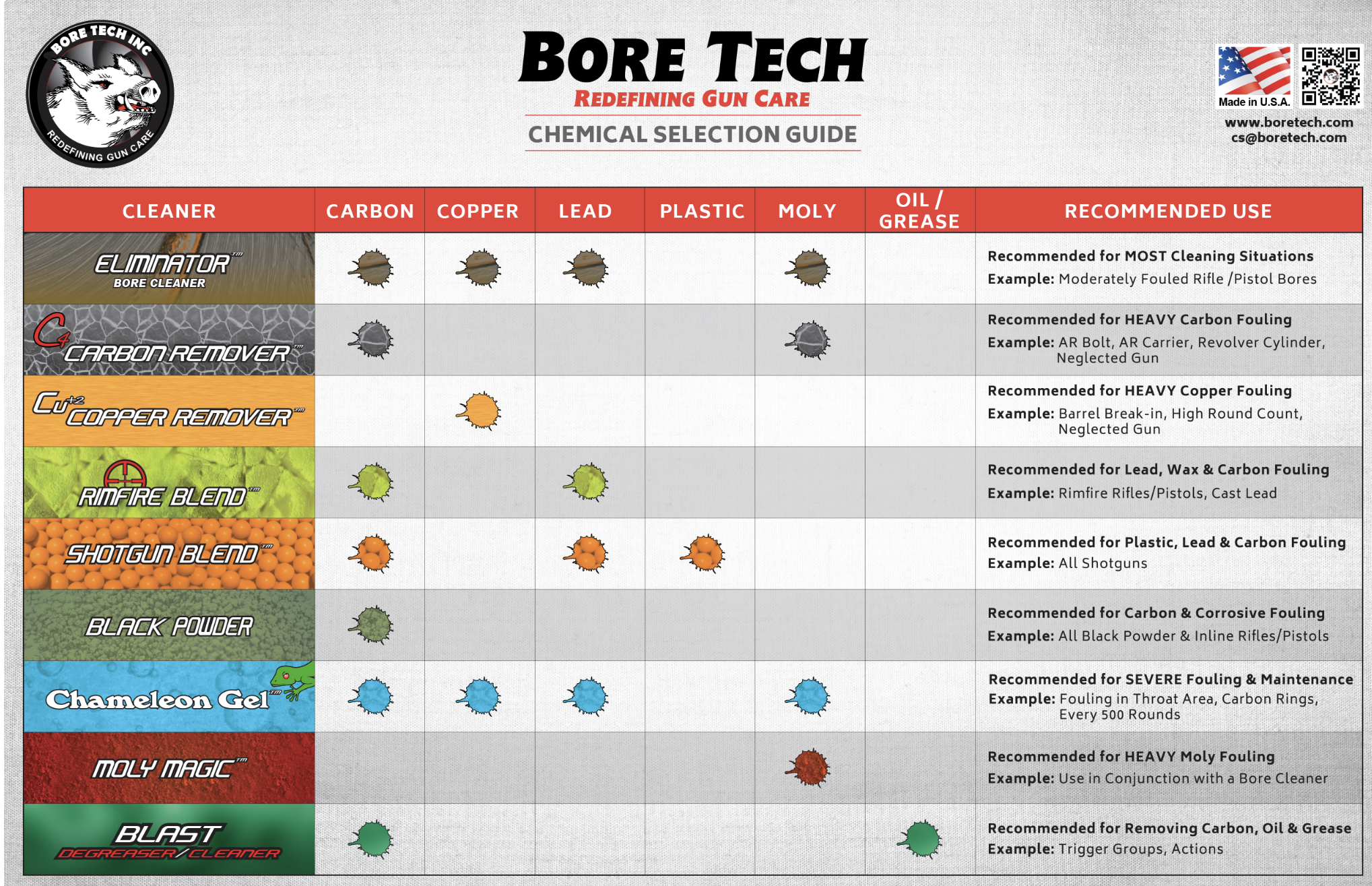

I have BoreTech Eliminator not Rimfire, is that ok too use on rimfire?
@p5200 you're not going to hurt anything. I primarily use Carbon Remover and Rimfire. None of the bore tech stuff is going to damage your barrel.
