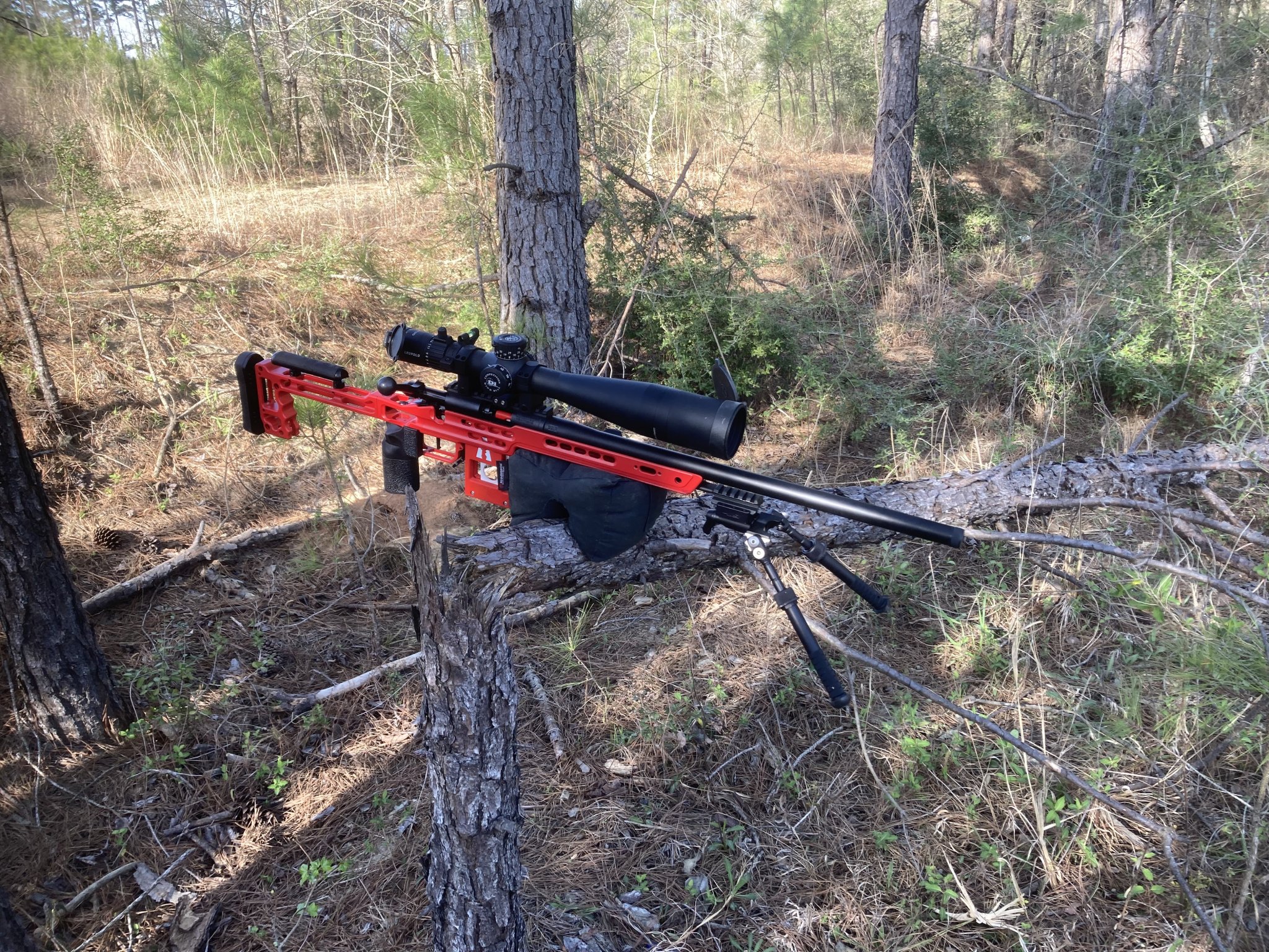

I do have MPA Ultra Lite Chassis that I could use for Vodoo or RimX. I don't like the lack of 2 stage trigger on new Tikka T1x Ace, the rest of Ace rifle looks nice
Don’t sell the Ultra Lite Chassis short for PRS Rimfire. It does have one drawback, adding extra weight is a pain.
Vudoo 360 with 22 inch barrel
