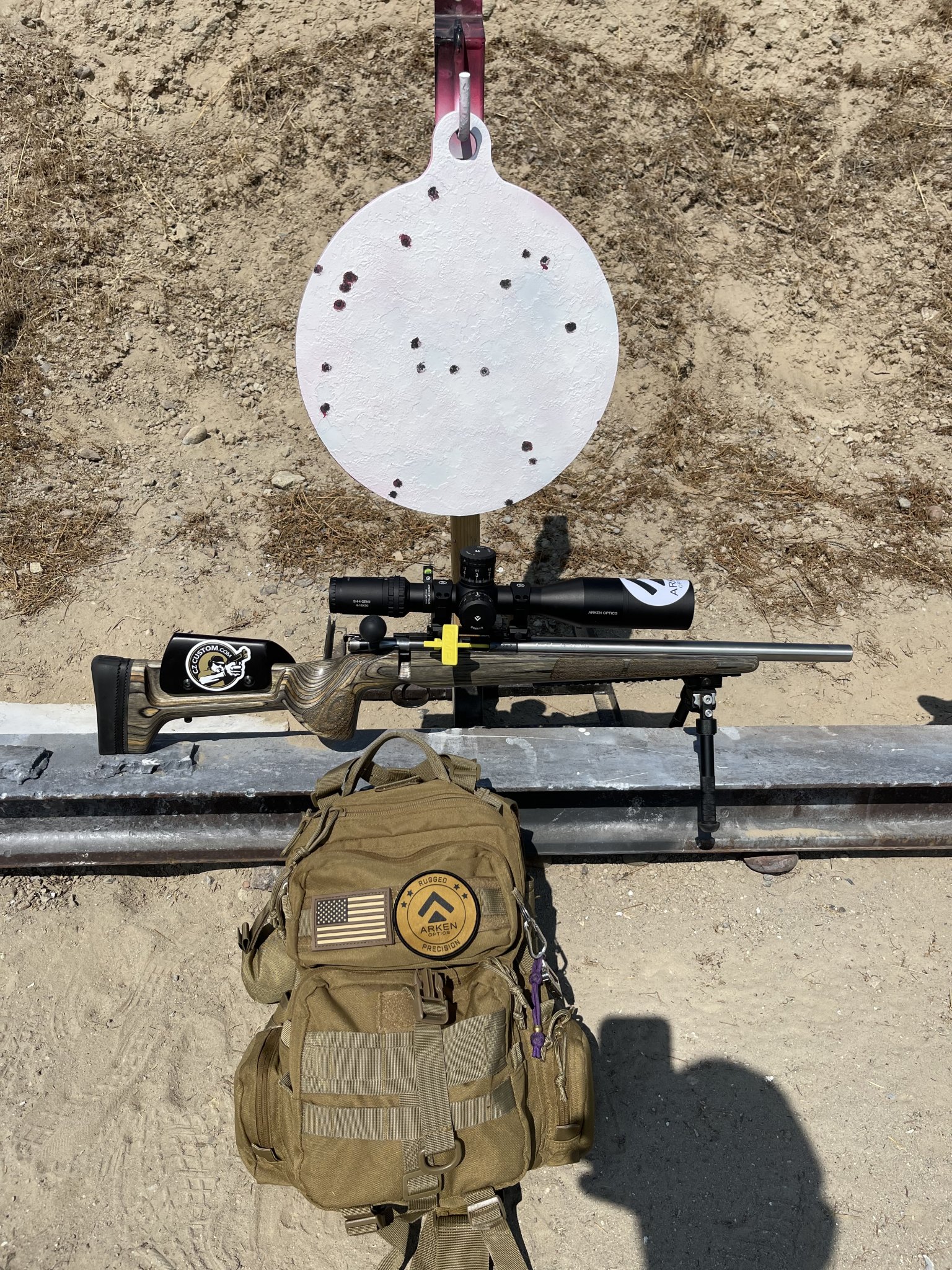

If you like rimfire rifles, they you will like both the Tikka and the CZ. How much tinkering you will need to do depends on the individual specimen you end up with, your intended use, and your individual requirements. I have no 457, but I have a 452 and a Brno Model 1 custom. I also have a T1x 22lr and a T1x 17HMR. I have a lot of other rimfire rifles as well. They are all tremendously enjoyable to tinker with and shoot. If you do not like to tinker, then do not buy any rimfire rifle, period.
The hits on the big steel plate were made at 421 yards wit the Brno Model 1 custom pictured. The rifle is a 17/22 Swager -- it chambers a 22lr cartridge. Upon firing, it swages the bullet down to .172 and spins it in a 1:8 bore. It will stabilize bullets as heavy as 36 grains. The hits pictured were achieved with Remington Yellowjackets. It is a varminting rifle that predates the 17HMR and 17M2 and is quite handy on ground squirrels and such out to about 125 yards. Like I said, rimfires are fun.
Well hey, that’s a new one to me. Pretty cool. Does the swaging make it more accurate than a regular 22LR? I’ve never even attempted 400yd (or even 200yd) shots for accuracy with a 22LR beyond what I call “artillery plinking”.
I’m kinda surprised that 17/22 swaging doesn’t blow up the action…in addition to the conformable lead bullet, the additional reason that it doesn’t blow must also be the low power of rimfire? Help me out.
Reactions: Emerson0311
It is not more accurate than a 22lr. First, the gun cannot stabilize a 40-grain bullet so you cannot shoot match ammunition. It is designed for hyper velocity and high velocity hollowpoints as it is a hunting rifle. Consequently, the variation in that class of ammunition applies. That said, the rifle will shot into 1.5 inches at 100 yards so it is plenty accurate for grounds squirrels and tree squirrels, etc. Sometimes it will shoot MOA at that distance.
There are no pressure issues. There simply isn't enough gun powder in a 22lr case to cause any issues. The soft lead bullets swage down easily. People have built them on 10/22 actions without problem. Connecticut Precision Chambering built a fair number of them in the late 1990. CPC chambered my PacNor barrel. They also grow in length to half an inch, which greatly increases there ballistic coefficient and thus retained velocity and energy down range compared to the same round out of a .223 bore. The 1:8 twist almost doubles the rotational velocity so the stability is good and upset upon impact is more violent than from a .223 barrel. I had the rifle out a few weeks ago shooting small lemons at 170 yards with ease. It is a very fun rifle.
