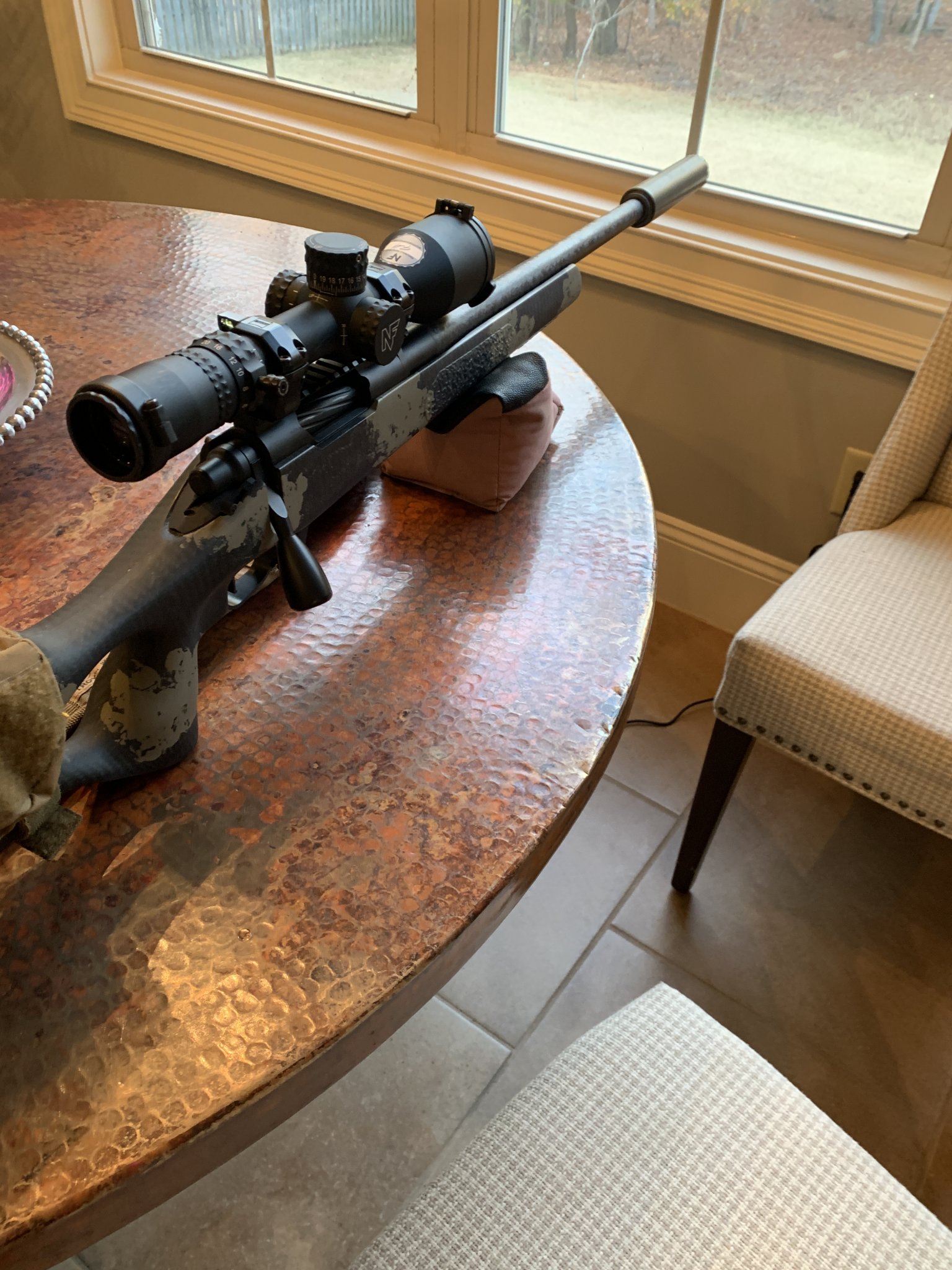

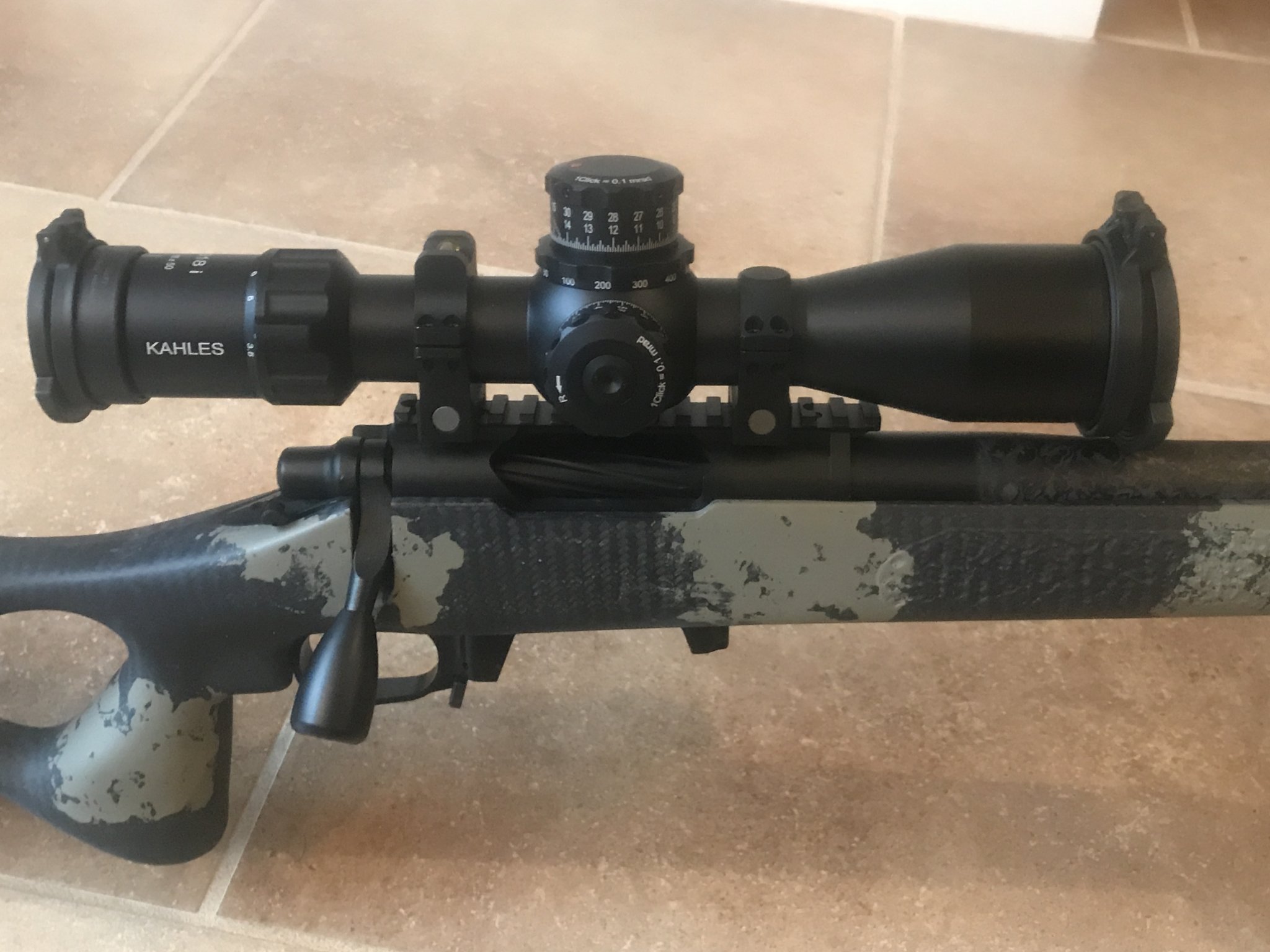

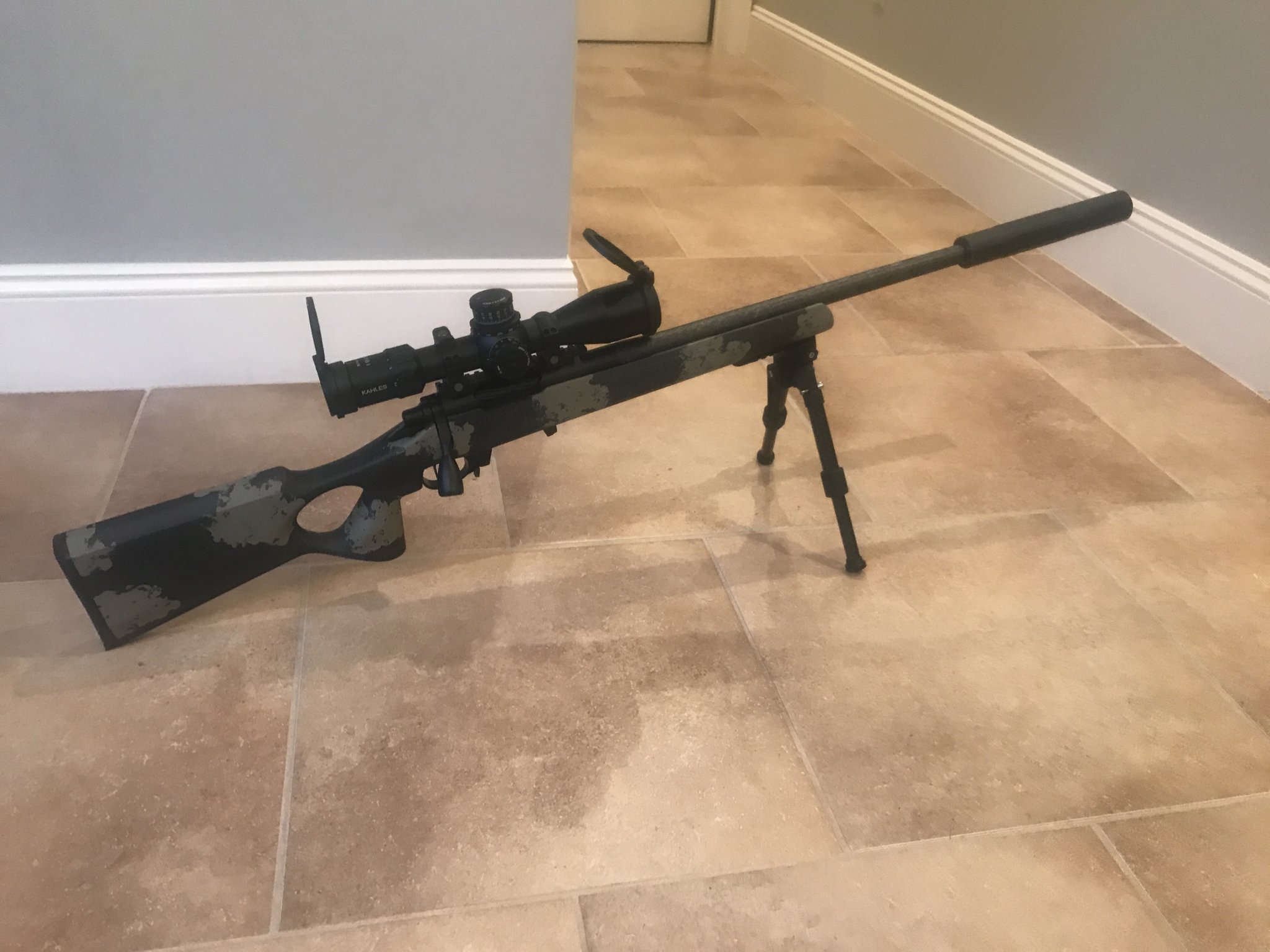

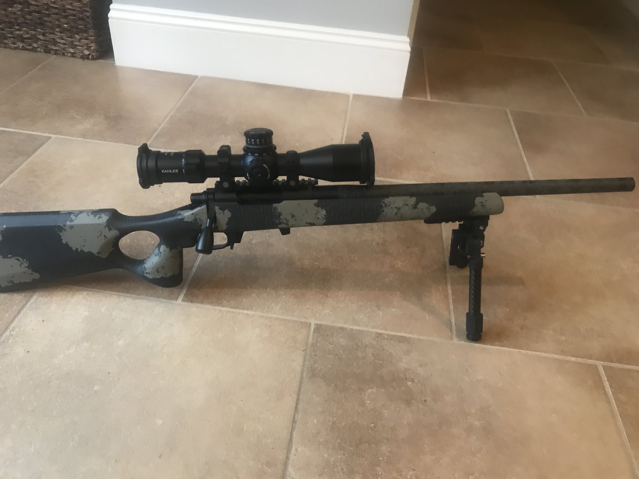

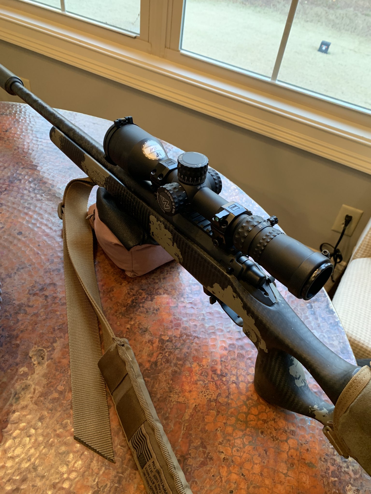

I’m just starting to load for 6.5 Creedmoor with Hornady 143 ELDX and Berger 156 EOL. I’ve got a box of Lapua SRP brass, 3lbs of RL 26 and needing a little help with some charges. I also have several other powders but understand RL 26 is the one for speed. I’ve got a custom build with a 22” Proof Carbon barrel with a Crux can. I’ve shot factory and custom loaded Ammo that shoot under 1/2 moa but I’m looking for a bit more velocity and want to try the Berger 156. Thanks for any suggestions

Using the Hornady coal gauge the length of the 156gr is 2.93 but the rifle is mag fed. I’ve got Hornady 143eldx loaded to 2.895 that barely fit. I read someone loaded the 156 with 47.8gr of rl26 so I’m tempted to start around 46 and go up. My rifle is setup for deer hunting and I can shoot as far as I want to at my farm, but that doesn’t mean that I will shoot a mature deer at 500-600 yards. I’ll shoot a doe but not a big buck.
