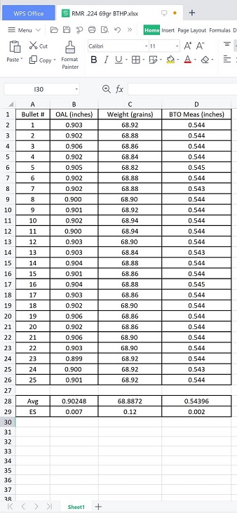

    Just wanted to share what I have found. I bought 500 of these after reading some decent reviews on the interwebz and they seem to be pretty dang consistent, at least through my non-scientific measurements. OAL ES of 0.007", Weight ES of 0.12gr, and a BTO ES of only 0.002"! Now, I only measured a random sample of 25 out of the 500 received but color me impressed, especially for the price. Make sure to read the disclosure about these on their website, something about corn cob media being stuck in the tip of the bullet due to the lack of a wet polish because of some wastewater management issue. But for what I need, they seem to be pretty good bullets @ 16 cents a bullet. Down to 14.2 cents if you buy 2,000 of them. I'm going to try to get out Friday and shoot a few dozen and see how they perform. I may be late to the party but they seem like a nearly identical copy of the green box of the same weight.

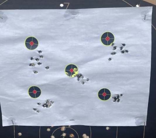

    Soooo, I got out to shoot a few today. While their 9mm stuff has been fantastic, the 69gr BTHP shot like absolute dog shit out of my rifle. It was really, really surprising how bad they shot compared to the 68gr Hornady projectiles. I’m not saying that it’s the bullet’s fault. They are incredibly consistent in their measurements. Maybe they just don’t like the harmonics of my barrel. I might have to play with seating depth (not much I can do due to magazine restrictions) or buy another EC Tuner/Brake and see if I can tune them in. The tuner/brake worked AWESOME in my 6.5CM, turning a 1/2 MOA gun into a consistent 1/4 MOA gun.
    All groups are 10 shots. Middle group is Hornady 68s from the bench. Top left and right are RMR 69s from the bench (top right loaded at 26.0gr Varget as opposed to 25.5gr for everything else). The bench I shot from was quite rickity and not super stable. After these 3 groups, I shot prone. Bottom left is the RMR 69s and bottom right is Hornady 68s. Oh, and this is at only 52 yards. Keep in mind that NEITHER of these loads have been fine-tuned to my rifle. They were shot halfway rapidly, also. Maybe 5-10 seconds between rounds. Just loaded to 25.5gr of Varget at about 2.245-2.250” COAL. I also found that the 68s flew about 20fps faster. Didn’t expect that much of a difference. Oh, and those dots are just over 1” edge to edge. About 1.100” or so.

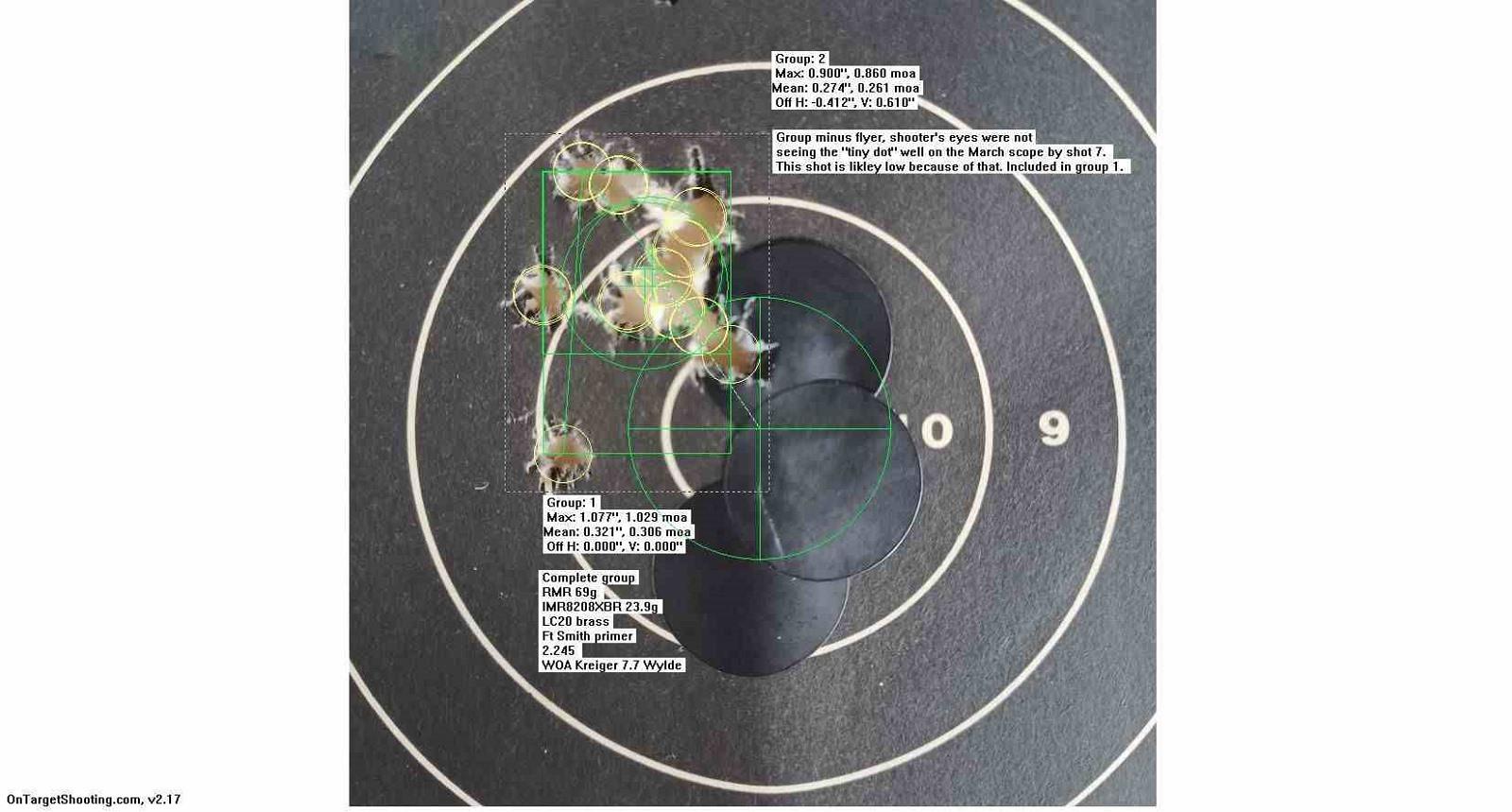

    They will group. This target was shot at 100 yards prone sling from a 20 inch Kreiger 1-7.7 Wylde chamber on the MR31 target. The low shot was called low. If you shoot for score, this bullet will score well and has an extremely good chance of high X count mid ring 10 cleans on reduced prone targets out to 200 yards. All good especially at the price.
    We plan on shooting this at the full 200 yard sitting rapid SR target and 300 yd SR-3 prone rapid target and expect clean capability with high X count. Will be spring before we can confirm this, no reason it cannot preform at those distances.
    The powder charge is pretty standard for 69g bullets with IMR8208XBR. A seating depth test gave the COAL, if you use this load you may need to adjust seating depth for best accuracy.
